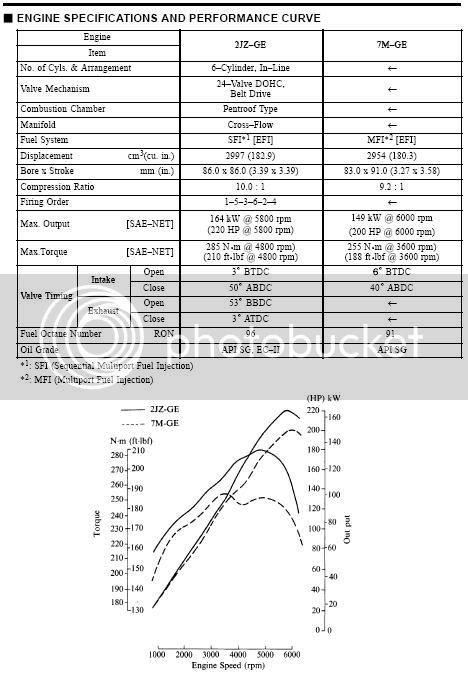

it also depends on the bore and stroke... the 2JZ has a longer stroke, meaning, if both engines are doing the same KW (assuming this would be achieved by higher boost on the JZ than the 1UZ) chances are, the 2JZ is going to have more torque.

The JZ is a 'square' engine with 85mm (?) bore and stroke so a good compromise between revs and bottom end torque. The 'oversquare' UZ should be more of a revver but the cams are definitely set up for silky smooth torque production. Either way the 3% increase in stroke for the JZ isn't gonna be enough to make up for the extra 33% capacity of the UZ :)
No that it really impacts on this build but the UZ is also shorter and lighter than the JZ so will give a significant handling improvement too.
