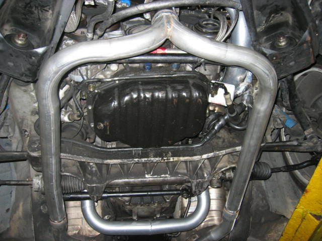

Also, sorry, but if your looking at producing a kit for people to buy, the pipe work and welding would need to be neater.
David, remember what i asked on msn? Have you found out if the uneven length of your manfold effects spooling/boosting properties of the turbo?? I don't think the engine would sputter or anything, but is there anything different about the way it runs at all?
Everyone seems to be telling me that having a manifold THAT uneven cant be good... are they right?
This system is not fully tested yet and i can not answer that question because my laptop is missing a usb driver in the device manager section. I will post the results once the engine is fully tune so i can push the car hard.... then we will find out if this is grossly noticeable.
I drove about an hour today with Los Angeles bumper to bumper traffic this morning. No heating issue. Aside from that. Boost starts at around 2,000 rpm and achieve 6 psi at 3k and 12 psi at about 4k. Can not boost more because my USB Driver is missing and can not upload the FI Map to the Split Second ECU.

David... OUTSTANDING work... you have come a long long way from your very first twin turbo effort. I think you may find the pipework will have a tendency to crack but my hat is off to you for actually getting this project (and the others) out of your head and into a car.

I knew you would come by and give me your expert feedback. Finally!!!!! I would say, this is the most sucessful project of the three. This turbo works great with the combo. At 12 psi, its barely at 1/3 of its maximum. Lots of room for boost. I do plan to get some custom JE forged Dished Piston very soon so i can push this engine harder. Right now the mechanical waste gate spring is set for 15 psi, but it starts to open at 12 psi.
The pipe is TIG welded and high temp coated along with exhaust support. Crossing my fingers, it should out last my engine...lol......

Looks pretty good David,congrats. We need video or at least sound clips of the beast on boost.
If it were my car,I'd run the 'gate open,dumptube facing the ground ;)
How close does the exhaust get to the steering rack?
I'd have some concerns about melting the boots of the inner tie rod ends. Maybe use some sheetmetal formed to fit around the subframe with some thermal insulation?
