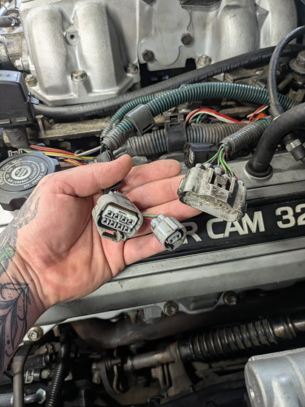

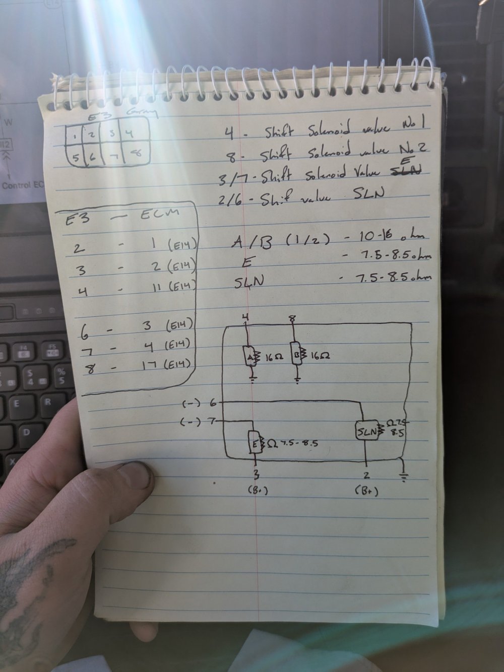

Hello all, I assume most guys that run swaps don't mind the DTC light being on or run the CD009, but it bothered the hell out of me, so I worked out a way to remove 'em if you're swapping to a manual transmission. You'll need a steel plate, 2 x 50 watt 8 ohm resistors, 2 x 50 watt 16 ohm resistors, and some wire. See photo for wiring diagram, this is going to trick the ECU into thinking there is a connection to the A/B/SLN/ and E solenoids. The E3 connector that was on the transmission is a grey 8 pin connector, if you have a complete harness it will look similar to the 6 pin for the EGR, with greenish sheathing. This setup is on a UCF20 LS400 1UZ, pinouts may differ for earlier models.

MAKE SURE YOU GET 50 WATT RESISTORS! If they're rated for less, when you put power to them they'll get hot / burn up. A and B ground through the plate, while SLN and E ground through their respective circuits. There are 2 more wires in this connector that I dead headed, one for AT oil temp and the other I can't recall. I mounted this plate off the side of my intake where I deleted the EGR solenoid, still hides under the engine cover fine.
