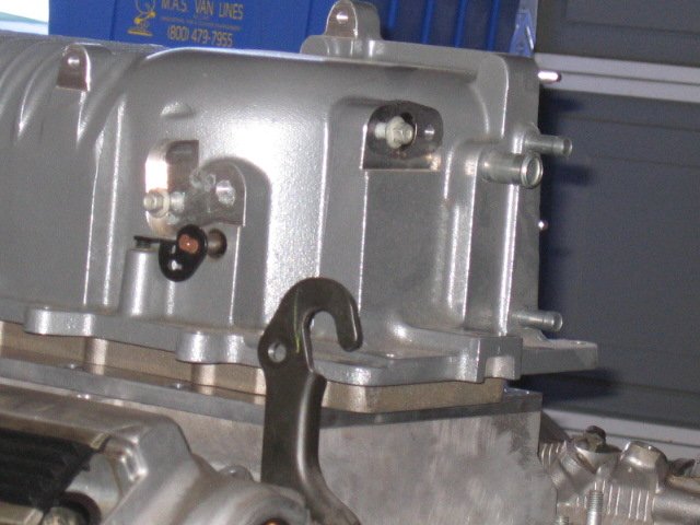

Ok Gents,
Finally my machinist have some time to do my charger. The charger was shaved about 1" off the charger. We also trimmed the side too but the charger still too wide for the stock Richwood manifold. We are going to weld some bungs (8)on the side of the charger and the manifold to hold the M112 in place. We will change the 8 ribs stock Cobra pulley to the 6 ribs pulley I got few months ago. Thanks to Peter Scott and Justen from Austalia letting me borrow the pulley puller. Once the pulley is changed then we can align the charger to the engine.
At the same time Rob Welsh also helping me with extra injector boss. I will have more details on the extra injector setup soon. However, this is what I got so far. The total height from the ground with Richwood manifold is 9". I need to double check the stock manifolds height again, but I think its pretty close.

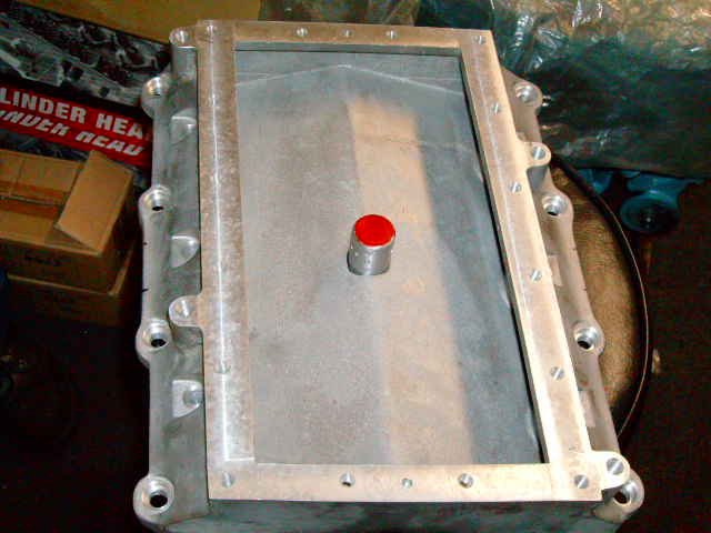

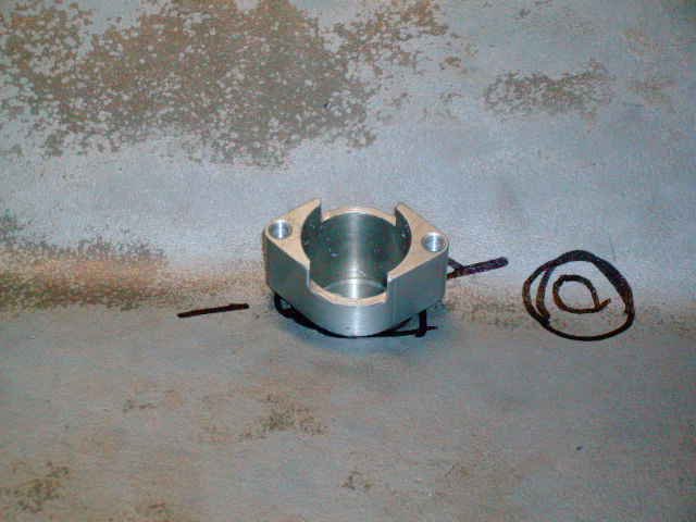

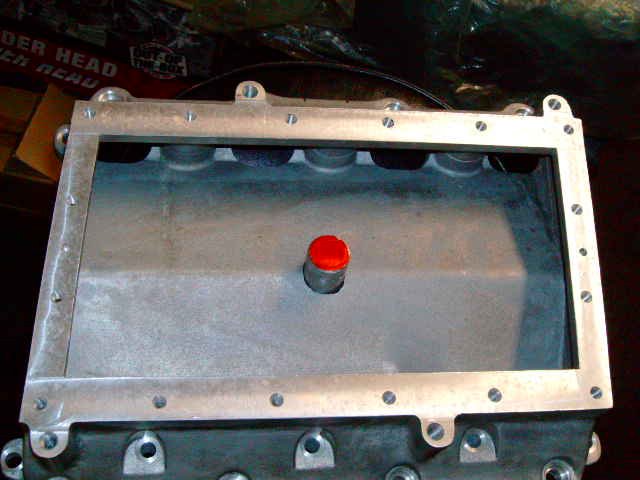

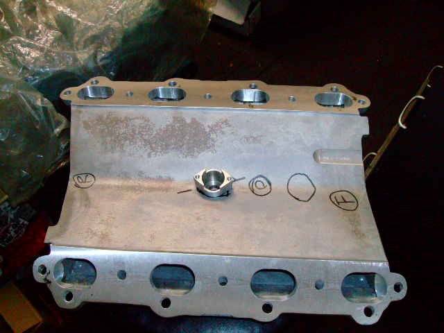

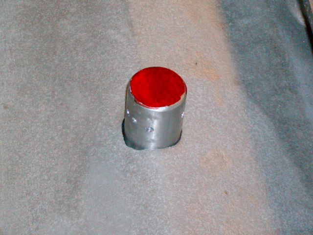

Gents,
Got some progress. We drilled the Richwood Manifold and inserted Boosted Tundra Extra injector boss. We also drilled eight 1/8" holes for the stainless steel lines. I am still waiting for the pully puller from Justen...Justen???? so we can start aligning this charger. Please see pictures:
