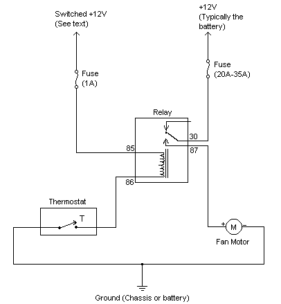

Well most good fans that come in a box have a fuse established on the power leads.. I know my dual Flex-a-lite fans came with that so I was never concerned about frying them....
Make sure you use well insulated relays, like bosche... Engine heat and elements burn or rust the cheep ones out eventually..
