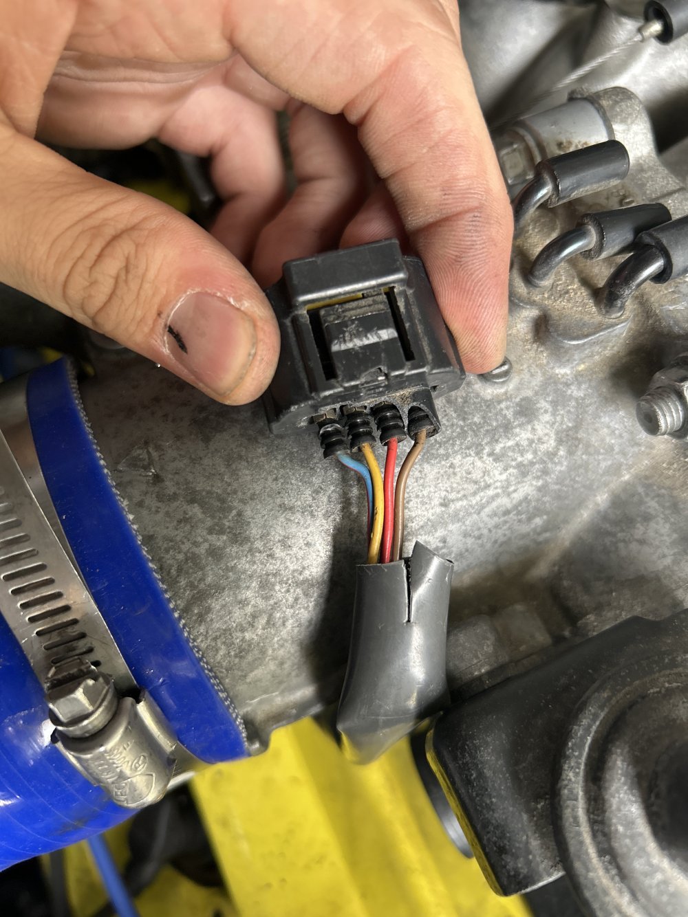

got the car put back together and it almost ran, I’m going to replace the iacv connector next as it is just as destroyed as the injector clips. Also when I try starting the car the rpm gauge bounces all over the place then the engine dies if that adds anything.
It will run but not very well. The rpm’s kinda jump around between 500-1100 if I’m feathering or slightly hold the throttle.
Got the iacv connection replaced and it ran a bit better, replacing the tps pigtail next
If you hold the throttle open a little, will it start and run?
All the bad connections are good connections now. The car will occasionally start up with a very rough idle jumping around in rpm’s. I can get the car to idle if I’m only slightly holding the throttle by the cable, when doing this there is a sweet spot where the engine will idle and when it will stall.
