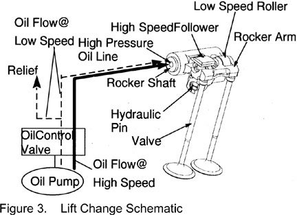

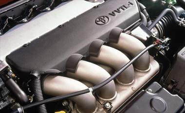

Now the Toyota 2ZZ-GE used in the Lotus Elise with 190hp used the VVTL-i system which uses a system very similar to the Honda Vtec which has a hydraulic activated high RPM follower. This changes lift, duration and timing by switching total cam profile between a low RPM and high RPM profile.
The result is 190hp from 1.8 liters = 105.5hp/liter... or...
