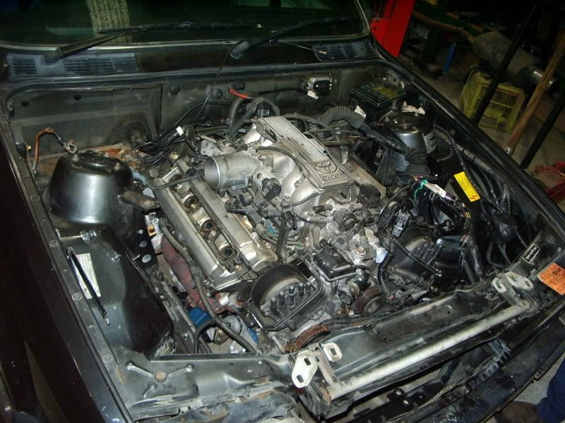

I have been meaning to post up some pics of my E30 for a while now,
Finally the day came, put a smile on my dial,

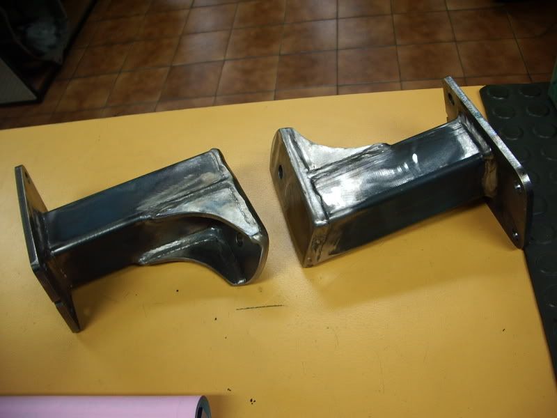

First go at engine mounts

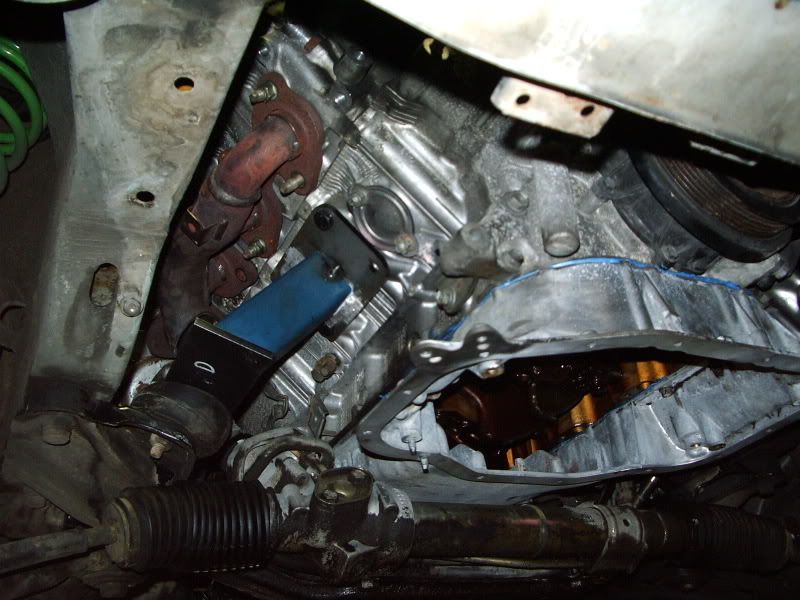

Engine mounts done

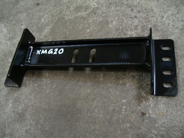

Gearbox crossmember done

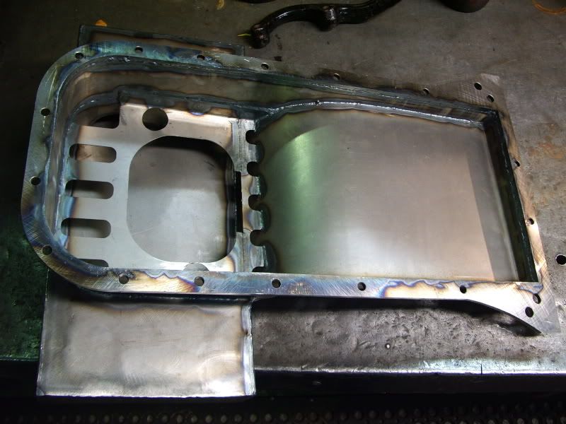

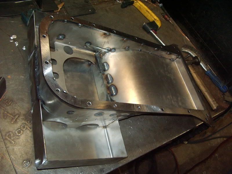

Went a little overboard with the sump, I had cracked my 6cylinder BMW sump for having the car sitting, as it was so nicely put by someone, "c*** scraping low" so made it sit a touch higher than the crossmember so ensure no damage
Sitting in place, getting close now,

Did you make brackets that attach to the bellhousing and block?
I'm planning a custom oil pan for my swap and thought that the stock alum ring attachment to the block and bellhousing was needed for block strength (not criticizing, just wondering if this is needed for my own build)
Can you share what thickness material you used for the flange and pan components?

Cebby, tried and tested combo with no problems so havent made any brackets, I see what you mean but I am assured that it wont be a problem.
Flange is 6mm and pan is 1.2
Vander, I wanted the engine mounted as low as possible, I first used a factory front sump and it sat way too low with how low my car sits, looked at making a custom pan for on the bottom of it but still was going to sit too low, now I know I can have it sitting as low as I like and it will never scrape

Worked out I got it down about 15mm more than what I could with the factory sump
Thanks for the reply. That uncomplicates matters for me a bit.
What are you doing for a dipstick?
