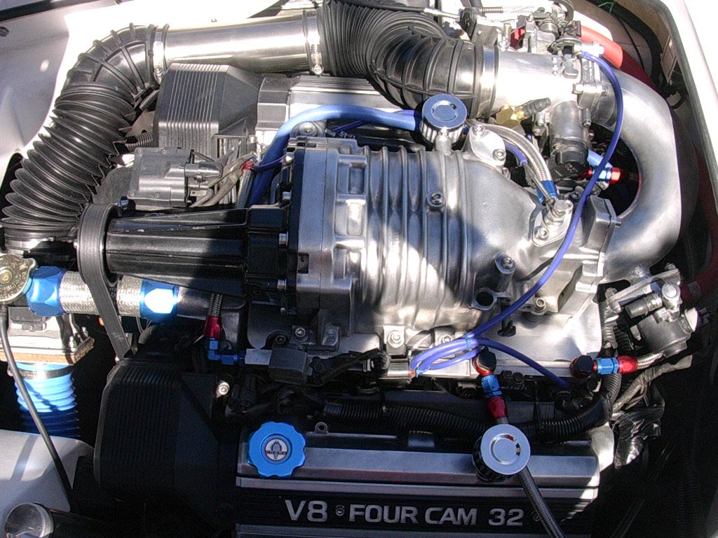

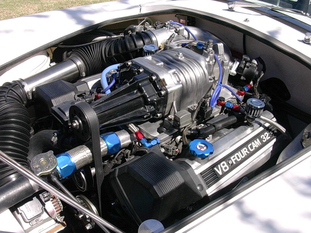

Here are some pics of my build. Sorry I could not get the res any smaller.
  • Basically the motor is standard with the exception of the blower which give it a much needed boost down low.
  • Bosch motorsport 550hp fuel pump
  • Rising rate fuel regulator
  • Bored oversize T/B
  • 9th and 10th injectors
  • Soon to have water/methanol injection
  • Undersize 3 inch blower pulley
  • Approx 8 psi boost
  • Best part is the whole car only weights 980 kilo’s (2100pounds}
