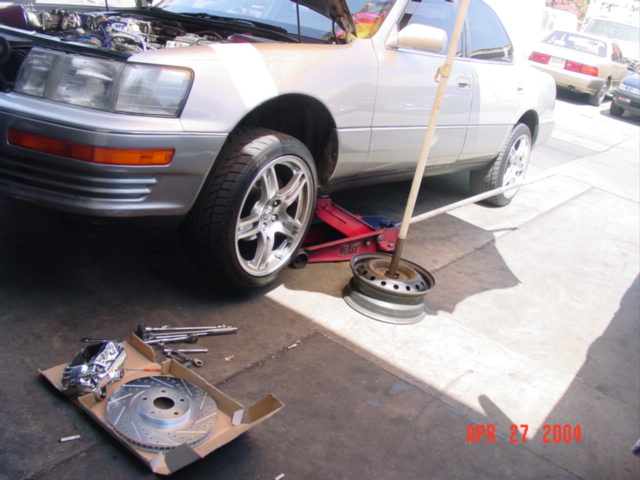

Here are the parts from Toyota Dealer:
Front Brake:
Finally got all the parts for the upgrades.  Thanks to Tony
ACleanSC4 and his brother for making a special trip just to drop
off the parts.  Anyway with slight modifications and special
rotors made by to make this upgrade possible.  Lets take a
pictorial journey to the installation and modification of the
front brake.

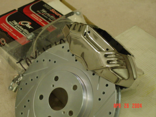

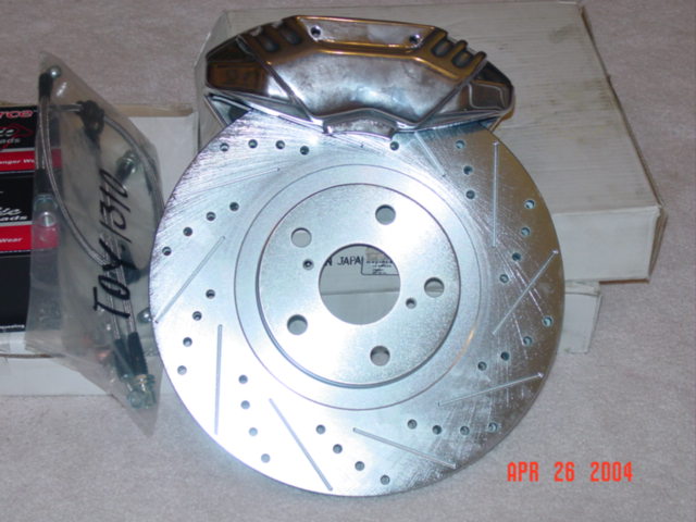

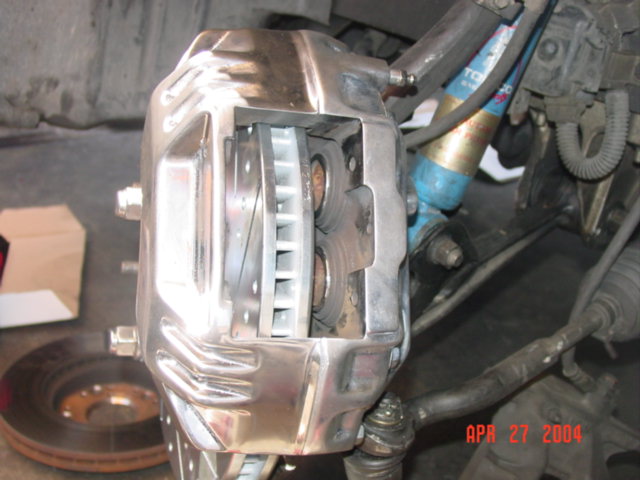

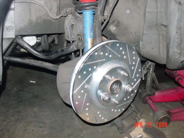

Here is the Irotors.com special designed MKIV Supra TT drilled/slotted rotor with polished caliper.
Another angle of this beautiful brake.

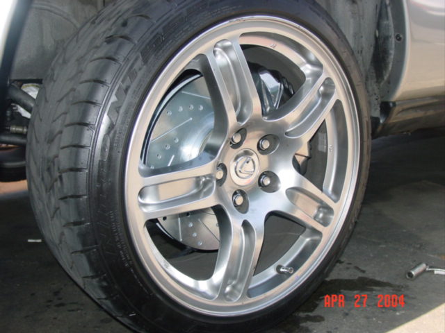

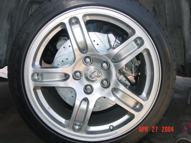

The front brake are ready to go on. I have 18″ rims. You will need at least 17″ to clear the calipers.

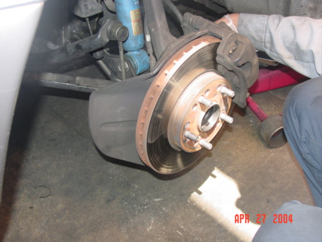

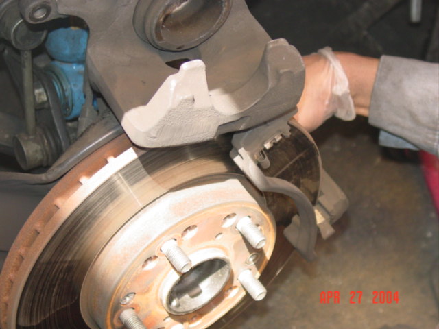

Front tire is removed and caliper is being un-install.

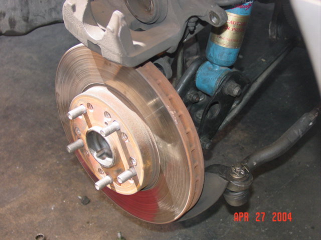

The front rotor is loosen and ready to be taken out.

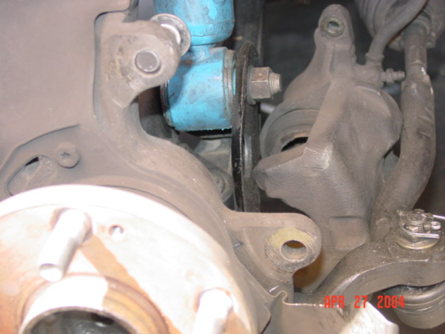

Reach behind and loosen the Caliper screws.
Ok, its out.

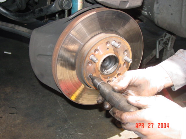

Use a phillip screw driver to loosen two screws to take out the rotor.
Rotor is out and a close up view of the Supra Caliper.
Beautiful rotors ready to be install.

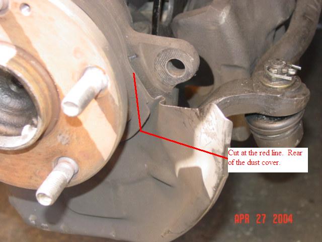

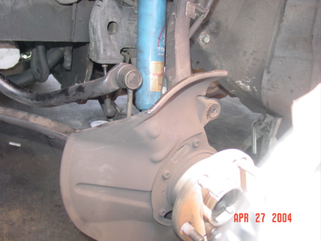

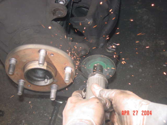

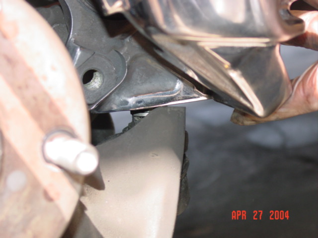

Dust cover is pushed back slightly so it would not rub the larger caliper and rotor.
Here is the first modification on the dust cover. You will need to make a 45 degrees cut on the dust cover in order to clear the caliper. You can you a grinder and removal of the dust cover is not neccessary.
Air grinder will work great.

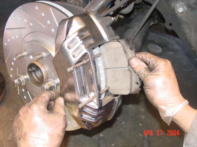

Its ready to install the rotor and the caliper.
Caliper and rotor installed. You can use stock brake lines or upgrade to stainless steel brake lines.

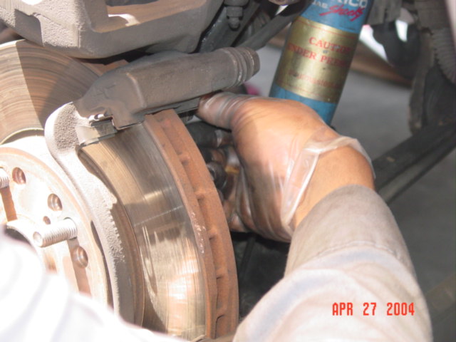

Installing the brake pads and shims.

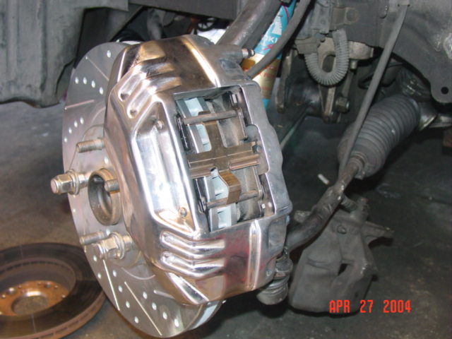

Fully installed

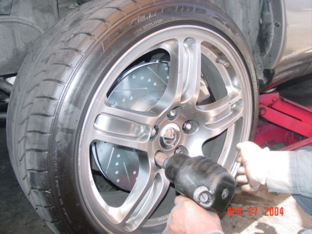

Mounting back the tire.

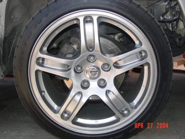

Here is a before picture.
Here is a after Supra MKIV TT Brake upgrade picture.
Another angle of this beautiful brake upgrade
