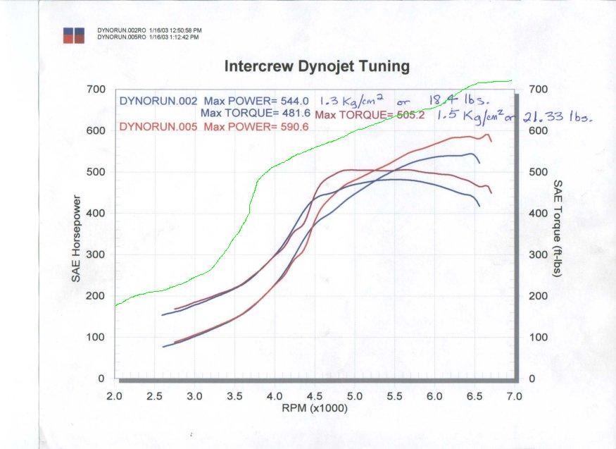

If the 4.0 1UZFE uses .68 A/R than the factor is .17 and that would be too restrictive.  In order for the 1UZFE to have the same spool up time and rpm, the A/R for the 4.0 1UZFE would be .904 (.2267 factor time 4).  However, if I use T67GTQ with .82 A/R (factor .205), this setup would spool up much quicker than Supra 3.0 with .68 A/R.  The example  #1 below, I would take the Supra 3.0 18.5 psi to produce 544 rwhp.
At the similar rwhp, it would take about 15 psi on the 4.0 liter motor.  In another word, the 4.0 will require lower boost level to produce similar horsepower than the 3.0 motor.  The following dyno charts are obtained from Andi Baritchi Supra Dyno
Example # 1:
Supra 3.0 = 544 rwhp @18.5 psi .68 A/R, GTQ trim (CTC67H)
RWHP per PSI: 29.41 rwhp
1UZFE 4.0 = 680 rwhp @ 18.5 psi .68 A/R GTQ trim (CTC67H) -Calculated HP)
RWHP per PSI: 36.75 rwhp
– The theoretical line is in green with 4.0 1UZFE
– The thin red line is my goal for 15 psi on a 4.0 liters

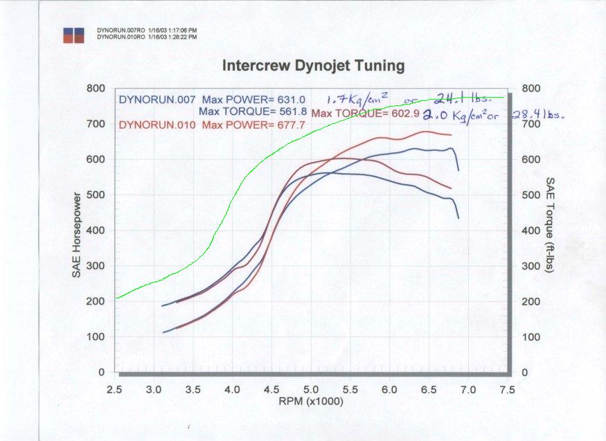

Example # 2:
Supra 3.0 = 591 rwhp @21.3 psi .68 A/R, GTQ trim (CTC67H)
RWHP per PSI: 27.74 rwhp
1UZFE 4.0 = 738.75 rwhp @ 21.3 psi .68 A/R GTQ trim (CTC67H) -Calculated HP)
RWHP per PSI: 34.68 rwhp
Example # 3:
Supra 3.0 = 631 rwhp @24.1 psi .68 A/R, GTQ trim (CTC67H)
RWHP per PSI: 26.18 rwhp
1UZFE 4.0 = 788 rwhp @ 24.1 psi .68 A/R GTQ trim (CTC67H) -Calculated HP)
RWHP per PSI: 32.69 rwhp
This might not be fair to the 2JZGTE in comparison.  However, there are too many variables that will alter the final dyno numbers on 1UZFE, especially with the head (s) flow rate between the two engines.  Like people say two heads are better than one.  The are too many factors involved.  In this article we just look at the big picture, comparing cubic inches between the two great engines.
My goal is to run 15 psi on my 4.0 motor with 91 octane.  From the above calculation.  I should achieve around 550 rwhp (15 psi time 36.75 rwhp per psi in example # 1) with proper tuning.  I want to thank Andi Barithci for the wonderful dyno numbers.  Now its time for the 1UZFE owners to prove this theory on the V8.
