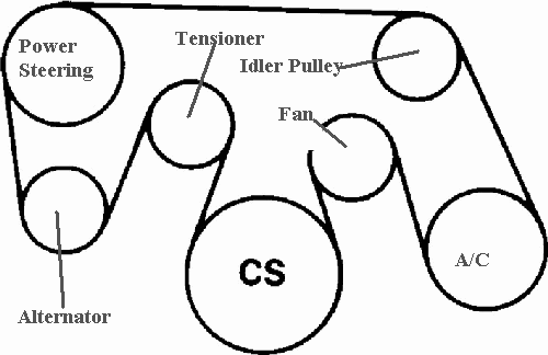

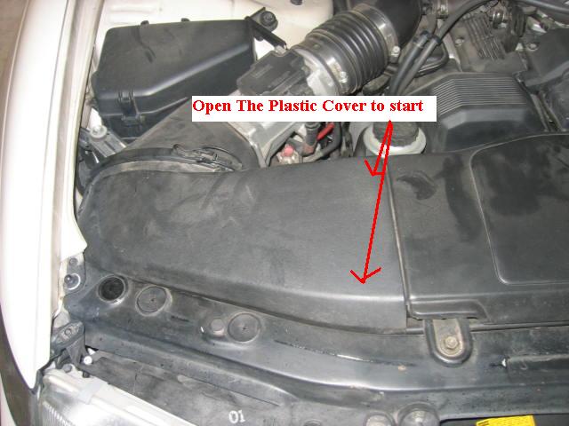

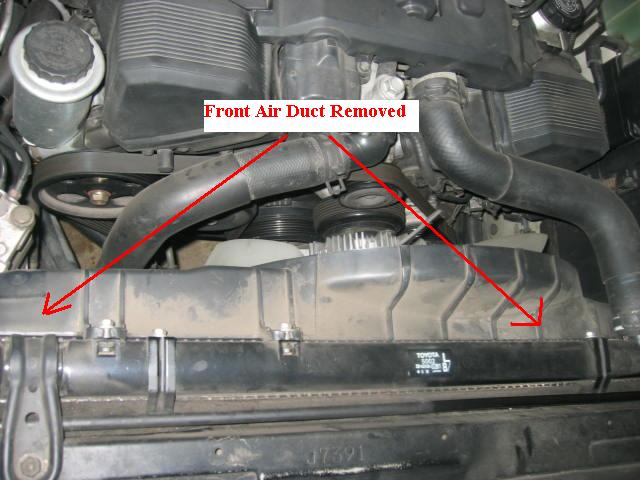

The pictures below are very self explanatory.  I tried to give u details explanation.  Right before you take out the belt.  Its belt to use your left on the socket to release the tensor and use your right hand to remove the belt.  I also included a serpentine diagram.
