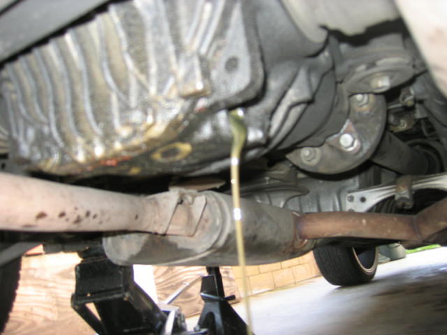

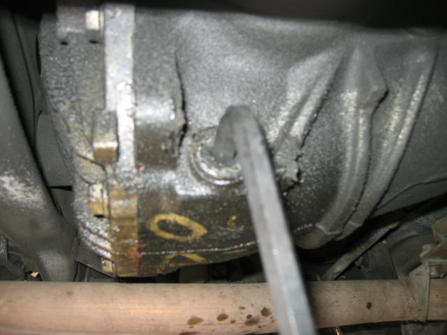

The easiest way to loosen the drain and the filler plug is coming into the car from the rear.  The first thing is to use a 10mm allen wrench and loosen it counter-clock-wise.  The Filler Plug should be loosen first for ventilation when the oil is drained.  The first picture below is the Filler Plug and the last two pictures are Drain Plug with an allan wrench.

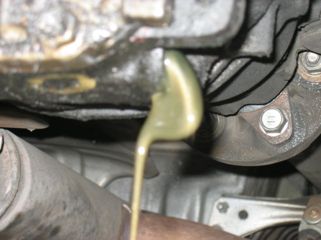

Next step is to loosen the Drain Plug.  Both of the plugs are 10 mm allen.  Before the Drain Plug is fully loosen, make sure you have a catch can or bucket under the differential.  Just like you would change your engine oil.
Once the differential oil starts to drain just make sure the oil container is right under the differential.  Let it drain for about 15 minutes.
