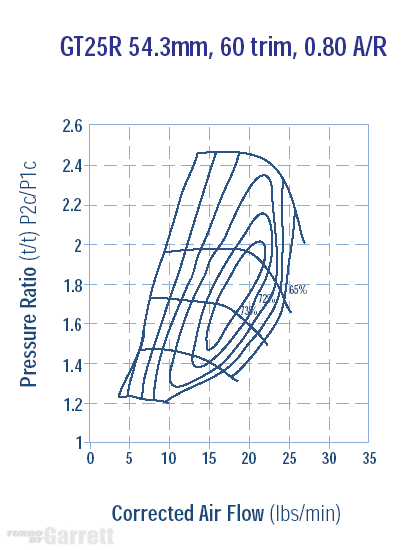

A question was PM'ed to me about the Garrett turbos that I decided to use. I will answer the PM. The turbos are Garrett GT25R with comp. A/R .71 and turbine A/R .68.
I am not staying under 500 hp and these are not off the shelf turbos. There are custom cut wheels. Let's just wait and see what these "little turbos" do in the real world.

Toys,I respect the information in your posts. I would like to get your ideas in one of my other posts (drivetrains). It is about how a Toyota 8 inch rear end can be beefed up and if it would be good for 500 rwhp after modification or should I just bite the bullet one time and change to a Ford 9 inch, please check this post and comment if you would please.Now back to the Garrett 25's. These are in fact hybrid 25's with .71 comp. A/R and .68 turbine A/R. The engine exhaust maifolds are tubular equal distance single chamber (each) to the turbines. The inducer and exducer dimensions for the wheels are cut and sized to support air flow that should produce more than enough air flow for 500+ rwhp. Maps for these turbos do not exist yet. I am working on getting them to post here. The engine will be 8.5 static compression and the boost will be whatever it takes to get my hp goal, hopefully. 550 cc low impedance injectors and an Autronics SM4 should help. Please check and comment on my post for the rear end. You are right, the power band will tell everything. I hope the calculations to acheive this are correct and I get what I am shooting for. Even if I fall short it is going to be fun to drive this truck everyday to work.

The Garrett turbos will run in the 2.0 pressure ratio range with about 30 lbs/min air flow each it looks like. Time will tell and the proof will be in the torque curve. I do have 8.5 pistons so I think that will help a lot. My ambient conditions here are in the 85-100 degree F. and 60%-100% humidity all the time. Nice dense air but always hot.
