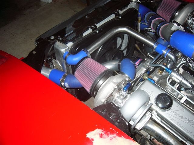

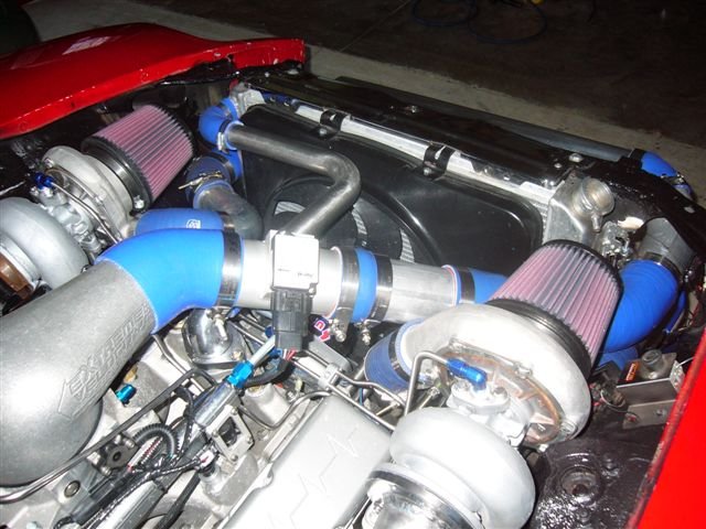

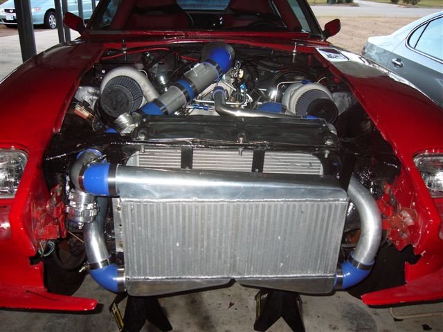

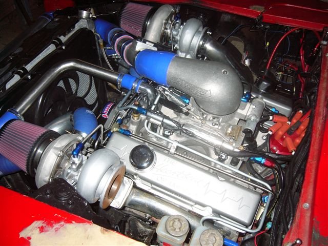

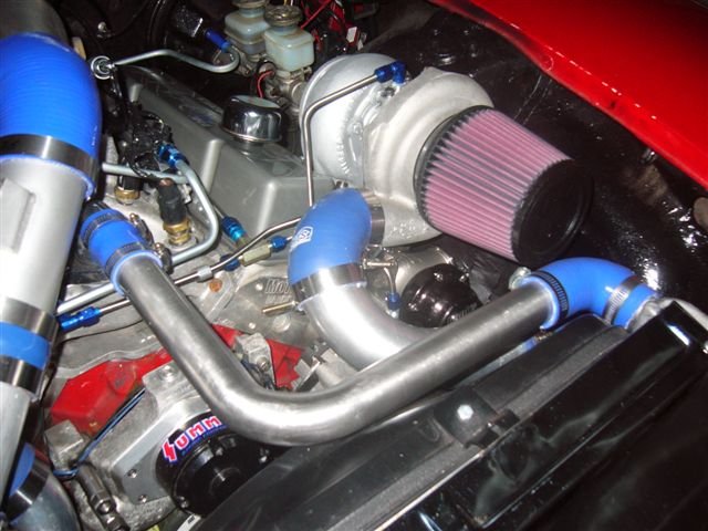

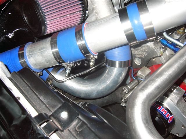

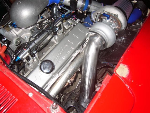

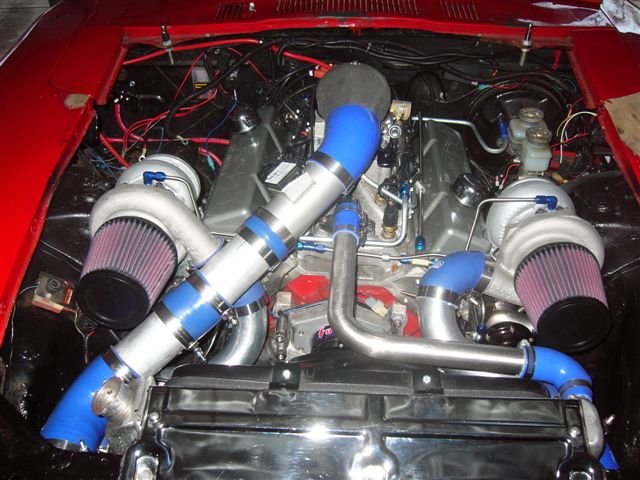

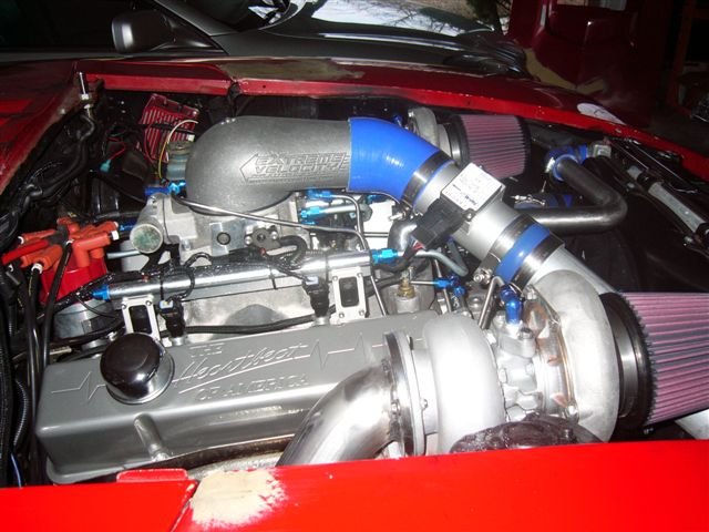

Thank you, 4X4runner....your confidence is well placed. The 71 Z car has a full cage, full frame, 9" ford rear, 4 link, moser axles, disc brakes all around, 5 lugs all around, fuel cell, 13.5 inches of tire on the ground per side, completely new steering, PG transmission with brake, 4.11 gears (going to have to go to 3.73's or 3.50's I'm afraid because I don't want to spin the motor much past 6500 rpm...and turbo's love a load. This is a street car that I drive to the track and back. My best to date on the N/A motor is 6.69 @ 103 in the 1/8th...drive it there/drive it home. I agree with thermactor...no traction on the street at all, even now. Base motor is a Bill Mitchell 454 Special Edition...it is a small block with the same bore and stroke as a big block. Makes 600 hp N/A with a 1050 holley. I have replaced the carb with fuel injection and I am looking for an easy 900 hp on pump gas with water/alcohol injection and 1300 hp minimum with race gas.
By the way, I am the same guy who has been fooling around with the supercharged, turbocharged, nitroused, alcohol injected Tundra engine, (Mean Green Machine). Haven't fooled with it for a while, however, we had quite a global discussion over whether you would defeat the purpose of the supercharger or whether the supercharger would be a restriction in the system. If you get the January 2008 edition of Mustangs and Fast Fords, there is an article in there that vindicates my thought processes as to feasibility of turbo/supercharger systems. Twin turbocharged into a supercharger...makes 1,188 hp and 1,017 lb/ft of torque @ 6500 rpm on a stock cobra engine...I think they are 5.4 liter. Take a read...it's a good article.
