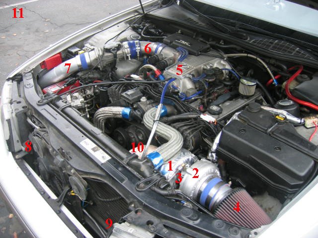

Here is my personal research with my Single Turbo System. I drove for about 45 minutes during a cool afternoon. The enviromental temperature was 60F.
The temperatures were taken with a hand held infared heat gun from about 2" from the target. The temperature was taken immediately right after the 45 minutes drive with the engine idleing.
Here are the readings:
1. Turbine Thermo Protection = 136.8F
2. Compresssor = 120.5F
3. Turbine without Thermo Cover = 411F
4. K&N Filter = 135F
5. Engine Temp. = 120.8F
6. Throttle Body = 105.7F
7. Intake = 85F
8. Intercooler Outlet = 76.4F
9. Intercooler Inlet = 85.0F
10. Down Pipe = 293F
11. Enviromental Temp = 60F
Today is very atypical temperature for California. During earlier today we had some mild rain. It would be interesting to see some temperature changes during a hot sunny day.
As yu can see the turbo glove like cover reduce turbine temperature from 411F to 136F. That is about 275F different.
Some of you might ask yourself. Why is the temperature increase from number 8 and 6. Its about 20F different. The re-gain of heat is most likely from heat soak from the engine, engine bay, radiator and heat radiates from the turbo.
This set up is HOT to Cold to Warm. Imagine the turbo and intake is at the same side like the SC300. HOT to Cold To Hot again.
I hope this post will help some of you.
