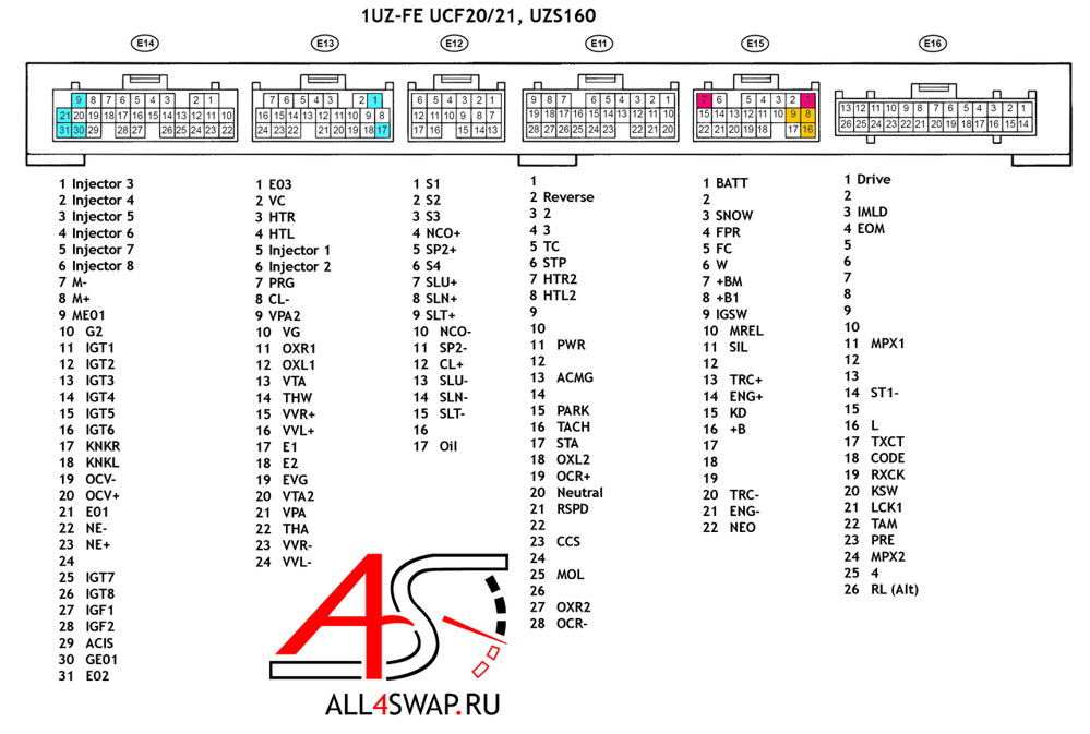

So, I'm trying to get my OBDII port up and running.
As I understand it, the OBD Port is Data Link Connector 3
Following the wiring diagrams, I see there should be 4 pins wired up on the plug: pin 7 - SIL (with a grounded shield)
pin 16 - +12V
pin 4 - CG (grounded)
pin 5 - SG (grounded)
I appear to have
pin 7 - SIL (with no grounded shield)
pin 16 - +12V
pin 13 - TC
pin 9 - B-Y wire (not sure where this goes)
Then there's Data Link Connector 1, which should be the one under the bonnet.
The diagram shows This having three feeds:
pin 11 - TC
pin 12 - +B
pin 3 - E1 (grounded)
Car is a UK 1998 VVTi, which may explain some of the differences to the wiring diagrams which are from an earlier LS400 and probably not UK.
So, does what I have sound "right", particularly the TC in the OBD-II port and in the engine bay?
What's the B-Y wire in pin 9 my OBD-II port? The assumption would be that, being Black and Yellow, it's also battery +VE
Do I need to bother shielding the SIL feed?
Am I right that this is K Line, as it's only using data on pin 7 (of the standard pins defined for OBD-II)?
Where's TE1 in all this? I can't find it in the diagrams?
Does grounding TC flash codes through the CEL?
