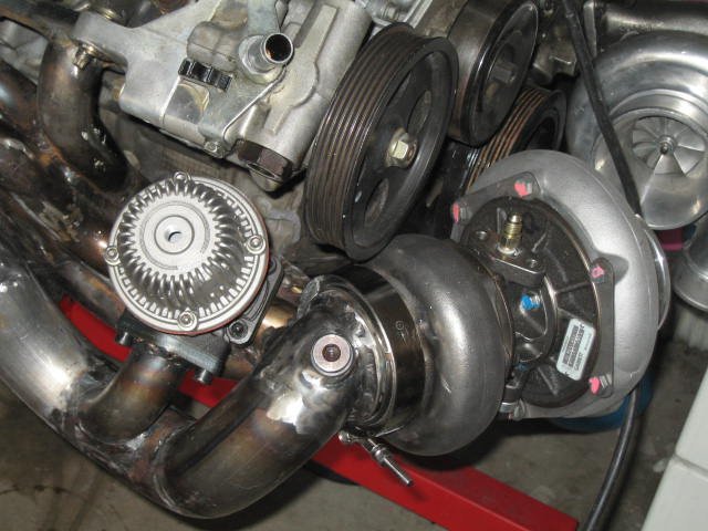

Spent few more hours carefully putting things back. Parts are in place and now doing the oil system this weekend if possible.
After seeing that top photo, I think David's motor should have a new nickname:
The Octopus

The motor really does look mean as h*ll with those coated headers and turbine housings. Even if it does have a strong family resemblance to an octopus ;-)

Big tip for your turbo fasteners Lex...lose the spring washers!!!!!! In fact lose the bolt setup entirely, it will always come loose and give you no end of problems. Get some studs in there and then use the proper self locking exhaust nuts.

I have self lock high temp washers.
Lex, you have spring washers on there that WILL lose their temper. Trust me, what you have there will come lose. For the tiny extra effort and dollars tap the flange for studs and have a worry free setup.
As soon as it comes slightly loose the gasket will burn out and an engine bay fire become a real possibility as the escaping gases melt thru adjacent wiring etc....saw this just the other day on a WRX.
Your call but i have been there and there's only one way to correctly attach your turbo to the manifold...show me one single factory application that uses bolts?
