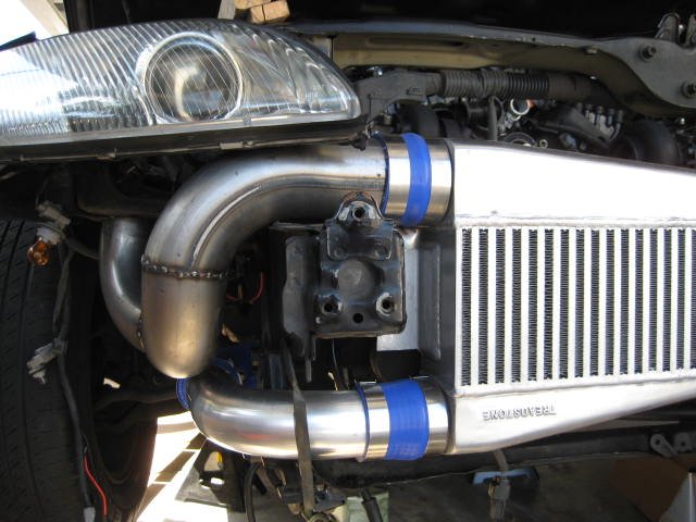

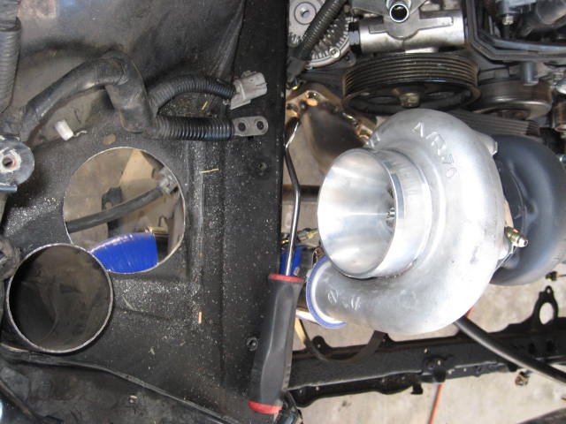

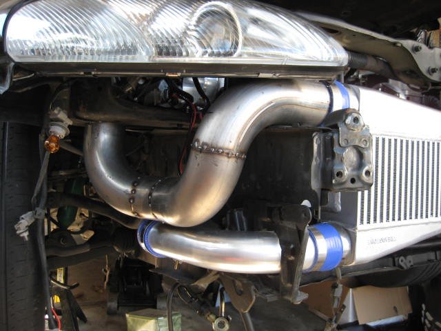

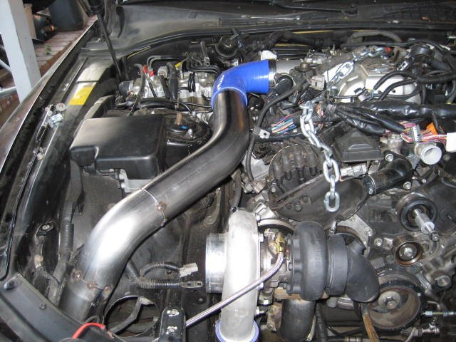

Got some updates for you Lextreme folks. I got the Intercooler pipes done except the intake pipe. I tag weld the mild steel 3" pipes and will add two HKS SSQV BOV to it when they arrive. After that complete touch up and powder coating will make it look quite nice. The first few pictures tell the story. I drilled 2 4" holes turbo compressor inlets for fresh air behind the bumper.

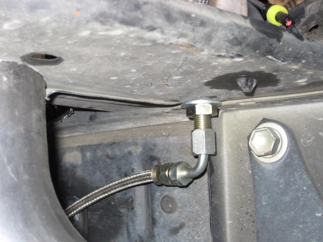

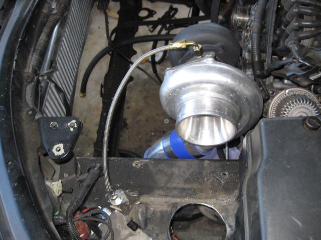

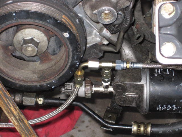

I played around with the turbo inlet oil. After few trys, I decided to put little extra effort and few more bucks. I T off the oil pressure sensor and run the oil lines to the side of the fender and come up to the fire wall via a bulkhead fitting. I have seen some SC with dual oil lines and it was a mess. So I ran the lines outside of the engine bay and come up with a bulkhead. Here are some pictures.
Looking good David, don't forget if those are new style GT turbo's, you probably need some restrictor orifices in the oil supply lines, else you'll be burning oil.

We had to fit 1mm restrictor in each oil feed line...
I dont have GT turbos. I have the standard Garrett T turbos. I think single turbo might see some problems but twin will get half of the oil and should be ok.
If they are ball bearing you could ?? Its no big deal either way... Just be aware if it smokes out exhaust ? Just fit some oil restrictors..
I have twin Precisions on V8 Ford, had to run restrictors as well...
Seems oil pressure over 60Lb is there limit...
The oil feed was the same, taking oil supply off this location is the highest oil pressure point..
She'll be fine...
I never run a twin turbo system in my life so I'm not sure if the oil restrictors are needed. And I haven't researched about the oil restrictors and the benefit of them. I've been runing single turbo with no oil restrictor with no problem for years. I think the oil pressure and flow are always greater than how much the turbo can drain them out. So if you restrict the oil, then the turbo might be lack of oil. I may be wrong. :13:
Yeah Steve you are wrong :) With plain bearings oil feed is rarely an issue and really you want as much oil pressure as you can get as the shaft is actually spinning on the oil 'cushion' not the bearing at all.
BB are a different kettle of fish altogether. They require much less oil pressure and have the seals to suit so if the oil presure is too high it pops past the seals and you have a smoke show.

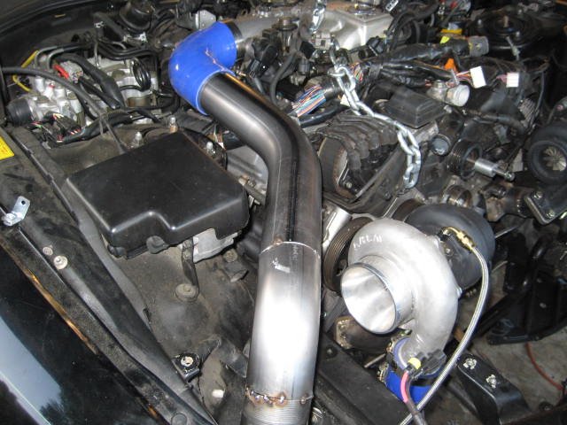

Please contact CRS and ask for Glenn. He work with us closely. Anyway, I have some updates. Got my 4" elbow long legs. They are very hard to find and expensive too. Got them and cut them down to fit the turbo inlet. Getting fresh air from outside. The goal is to get cold air and keep them cold. Notice the pipe routings are kept away from heat source. Here are some pictures
