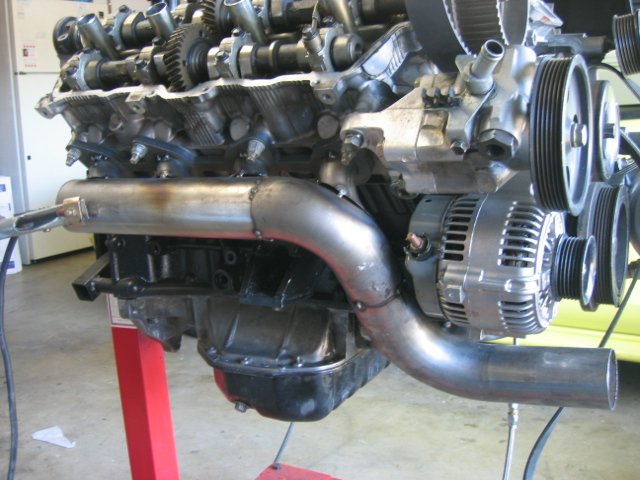

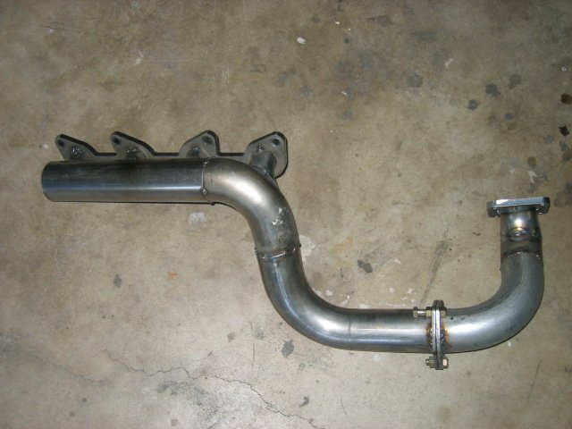

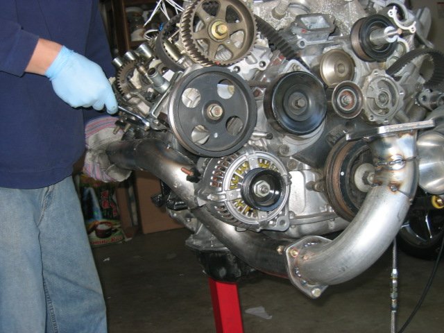

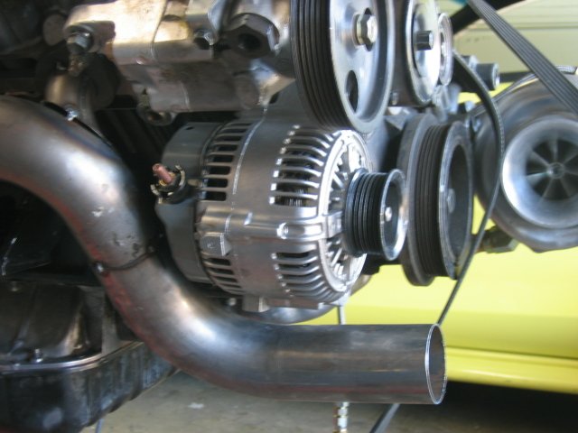

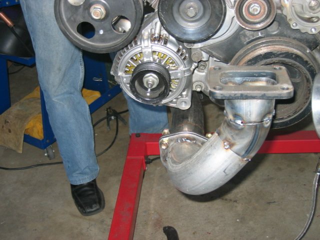

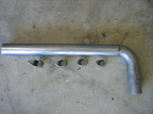

We spent about two hours today and we got about 90% done. The system is pretty simple and workable. We used 2 1.5" tight radius mild steel U bends. We cut them into halves along with an additional cut to finish them off to mate with the 10" 2.5" mild steel straight pipe.
We had to the the 2.5" pipe to a local muffler shop to burn some holes into it. The 2.5" then mate with few 90 degree bends along with a 45 degree bend where it mate with a T4 flange.
After done the basic tag weld Steve took it to a professional welder to finish it off. Here are some pictures:

Am I seeing correctly? Did you guys pull the engine to size up the exhaust and to help with the mounting and fitment of the single turbo? I see the engine with the pipes on a stand...Just wondering why? Is that really necessary?

David has a spare but 1000 hp engine outside. So that helps us to mock up and weld the pipes a lot easier. Brake torqueing sounds funny, but it's used to race for some people, either at the tracks or on the streets. It makes the car taking off a lot quicker than at low RPM. I still have your torque converter waiting for the turbo to be completed. And then it'll be sent out for a rebuild. The reason is I'd like to know exactly how the stock SC perform with a more powerful engine. One convenience of the turbo over your NOS is that you don't have to refill the bottle after the runs. In the long run, a NOS system costs more than a turbo system due to the expensive refills.

Steve using my SC470TT engine for mocking. I can make you one too... How does GT35R sound?
