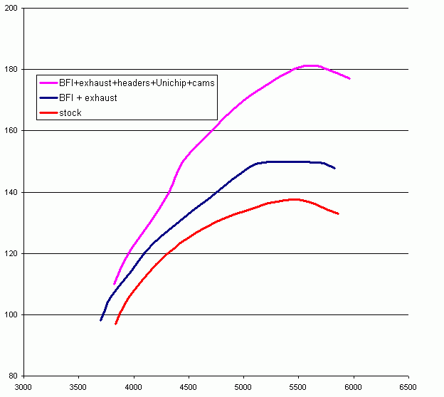

Peter, this is why I post as I do. Your experiences surprise me. I know you tried a single 2.50 system early on. Do any of your countrymen who you have dyno info on have dual 2.25 systems. I know you have the RUSH headers which have larger primary pipe size than I recommend and in fact you have asked me that question also. One day I would love to try multiple different systems and designs on a dyno mule. My beliefs are ALWAYS open to scientific reform so all data is welcome. As you point out standard chassis dynos are not good at gathering mid and low RPM power as the auto trannies tend to downshift. They are also not good at measuring engine responsiveness which is another factor in how a car feels. I know of a GS400 who replaced the stock Y pipe with a slightly larger design and reported a loss of power accross the RPM range. He then dyno'd and discovered to his surprise a 1hp and 6tq gain! It was the loss of responsiveness that created this feeling and of course the low RPMs were not able to be compared.
