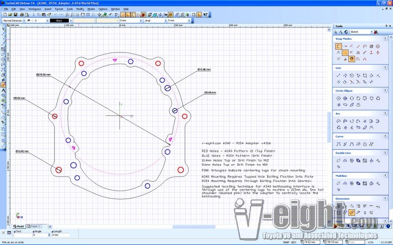

the brief i gave myself when designing these was to make the manufacturing process as simple as possible, with a minimal number of steps, and most importantly, to assume that the end user didnt have access to lathes/mills/cnc equipment.
certainly people with access to that equipment can start to incorporate more sophisticated steps in the process. ill include things like chuck mounting tabs on further revisions to give folks that option i guess.
dowel bushes would still be a whole heap easier!
Ed, I understand and agree with you that the dowel bushing would be easier, but thats assuming that the holes in the bell housing are accurate enough. The holse are casted in so how accurate could they be? I just hate to see people cut corners and destroy a trans cause of it. The way I see it is if you have a way to get it cut out, then you have a way to get it machined.... You dont do machine work to an engine in your garage with hand tools now do you???

no no, more seriously though, i doubt a combination of 6 large dia doweled holes would allow the centreline indexing to be out by much at all, but point taken, it is an unaccounted for variable, so putting your mind to rest on it requires a leap of faith.
im just in the process of adding lugs for a lathe chuck so you can turn on the shoulder as you described earlier.
i guess each person needs to decide how far theyre prepared to go with the manufacture of the design. ive just spent my time indexing the damn holes!
you make it yourself (or rather send the design for direct upload to a water jet cutter) and save yourself several hundred dollars

ok so does anyone have the correct thickness for this adapter? planning on sending it to the cutters soon > 30 mm or 40mm or what material do people recommend? cheers
The auto bellhousing needs to be spaced out 30mm.
Now whether you use a 30mm piece of material and machine it flat, or whether you use a 35mm piece of material and machine a 5mm lip its up to you.
