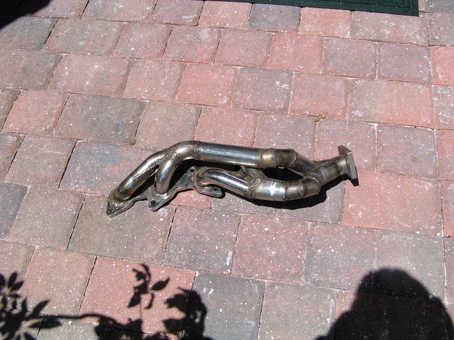

Frank said he was cool with me posting up a pic of the custom headers he engineered and made for my project, so I am posting it for you to see. Keep in mind a few things:
When shopping for a fabricator, it is sometimes very tough to find one that can do what you want correctly...I went through 2 other incompetent shops before I got to XTREMEBOOST. Frank is a heck of a fabricator and welder...Here is a comparison of what you can get from different shops:

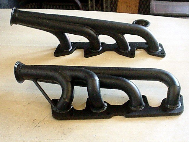

1)General's Welding and Fabrication, they fabricate headers and chopper parts, so they claim...
Here is the pic of what I got from him as far as the headers were concerned...
"BlanK" Nada, Nothing!!!

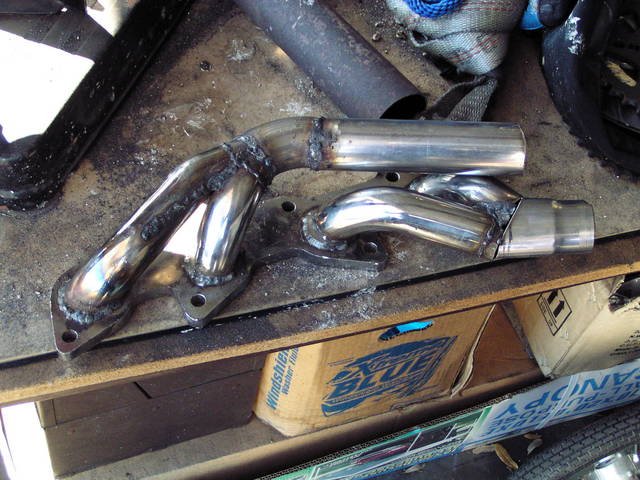

2)Trinity Auto, they do good auto repair, but, fabrication, well a picture speaks a thousand words...
or this
3)XTREMEBOOST: Frank is an excellent welder and fabricator, and his employee Mike is excellent with Toyota and Lexus. Again, a picture is worth a thousand words...

Oh, Ryan! I can't believe the Trinity shop could weld that bad. It seems like they tried to save a few bucks on the elbow pipes by using the straight pipes instead. But...the XTremeboost shop's headers are excellent. They know what they do. When the system is completed and running, please post up the result.
Interesting...I thought I would get a lot more comments on these headers...I sure got a lot of complaints on the previous crappily welded ones...These are obviously much better made...But not too many people stating anything...Hmmmm......:feedback:

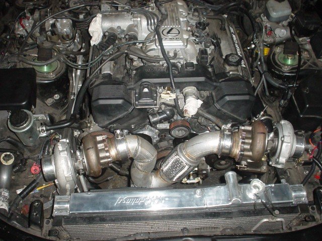

robie said:
i got one question where does the turbo mount on?
The headers are designed with future maintenance in mind. That is the reason for the V Bands where they are...An extension was made that angles down and towards the center of the car, and back up to hold the turbos in place. Here is a pic to show them installed...Much more to come in the next few days...This is before these pipe were ceramic coated...They have since been coated...
Ryan
Ryan,
Nice work....Finally.... after all those phone calls..... and advice.... you finally get it done..... I noticed your down pipes are merged in the front/center fo the engine. Is that mean your dp will go under the car?
David, thanks...You provided invaluable help to my early efforts...I enjoyed those conversations quite a bit...
The Dp's are merged in front because it is impossible to run a DP of any size at all on the driver's side, if, you plan on keeping the AC. There is no room, unless you go under the car, this is not adviseable, even to a non-lowered car. So, we solved the problem by merging them in front, and running a single DP around the passenger side, where there is sufficient room. The DP will be split off into 2 2.5" exhausts, and run all the way back.
More pics to come soon...Wait till you see the polished turbos and the ceramic coated pipes...Oh!! and the water injection...the nozzles are in, and the rest is on its way...
Ryan
