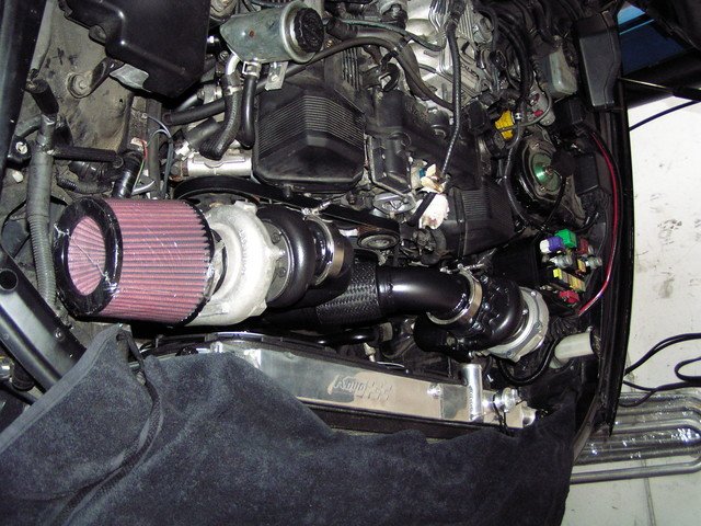

Here are a few more pics:

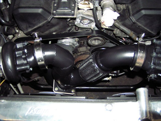

Black ceramic coated turbine housings...
Coated Y Down pipe...
Turbo firment...
Header extension and flange, plus, look at the quality of the ceramic coat...
More to come...
Ryan

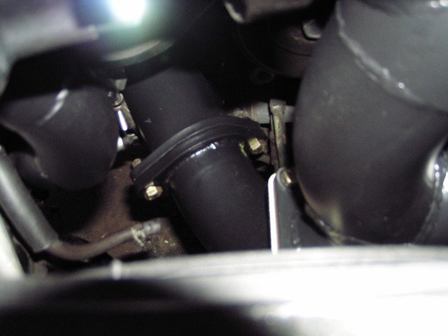

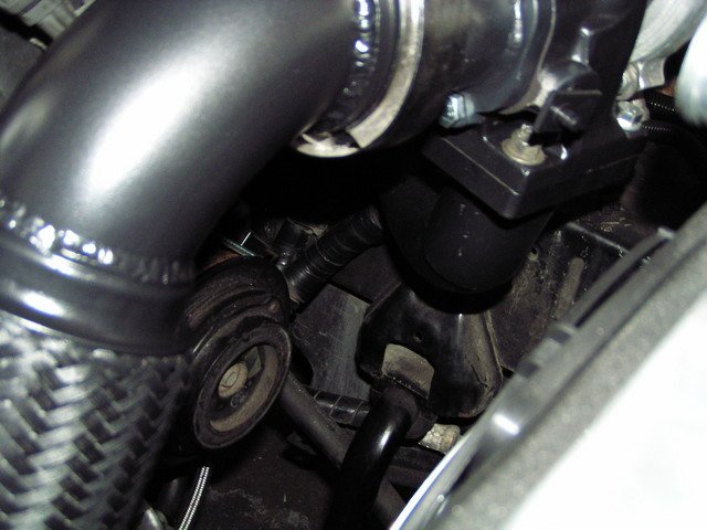

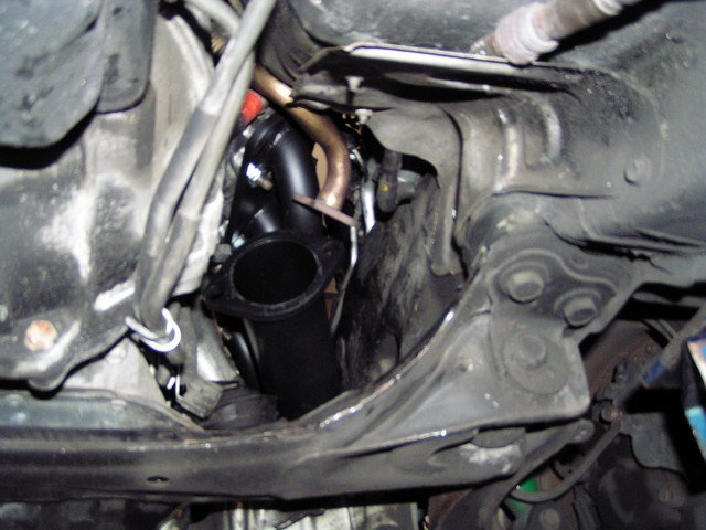

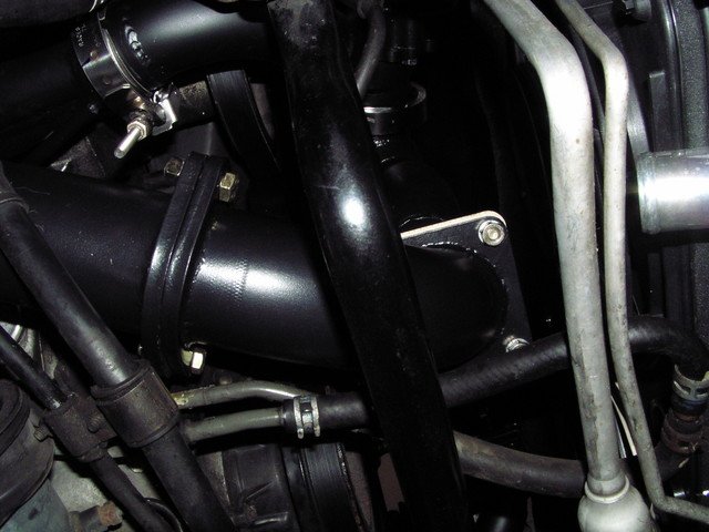

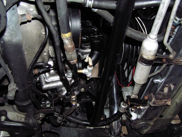

Here are some close ups of the down pipe under the car and its fitment...
Down pipe...Two-piece...
Down pipe under the Y DP flange, above the sway bar...
Down Pipe at the back of the engine...
Oil Tap...
Ryan

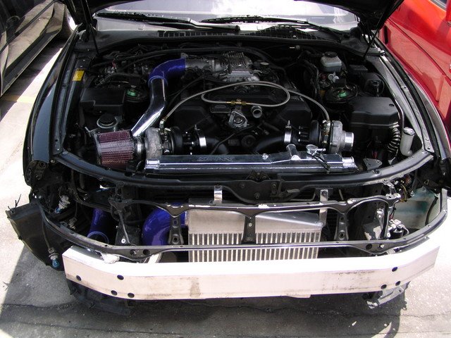

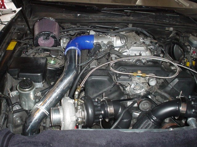

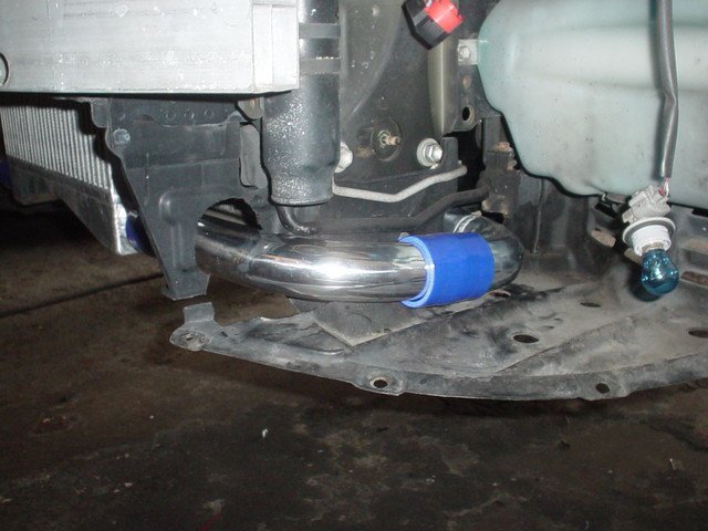

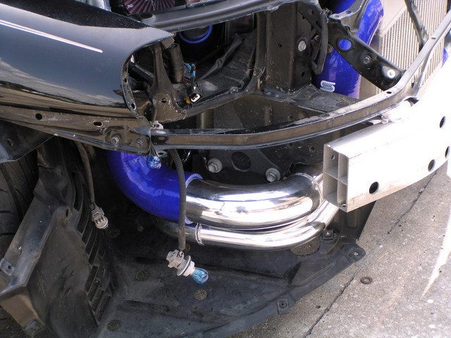

As promised, here are some more pics...The steel braided lines are only connected to account for all the parts for now...They will be resized properly.
Lower Intercooler piping and intake piping on passenger side...
Lower intercooler piping on driver's side...
Upper intercooler intake pipe...
More to come...
Ryan :slaphappy

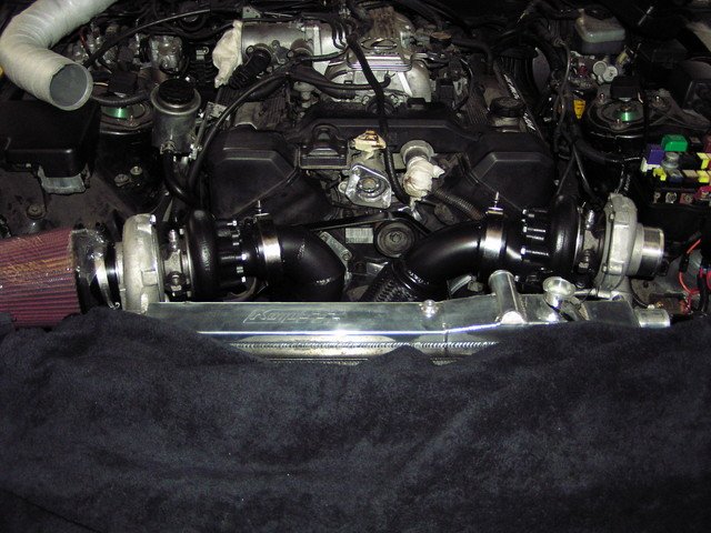

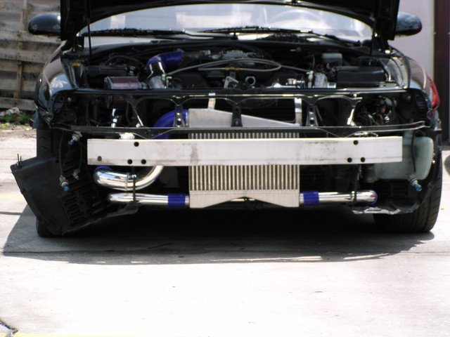

More pics, as promised...
Frontal view of TT
Another frontal...
These pipes do not even come clode to touching...
More next week. Car will be running next week...
Ryan :redface:

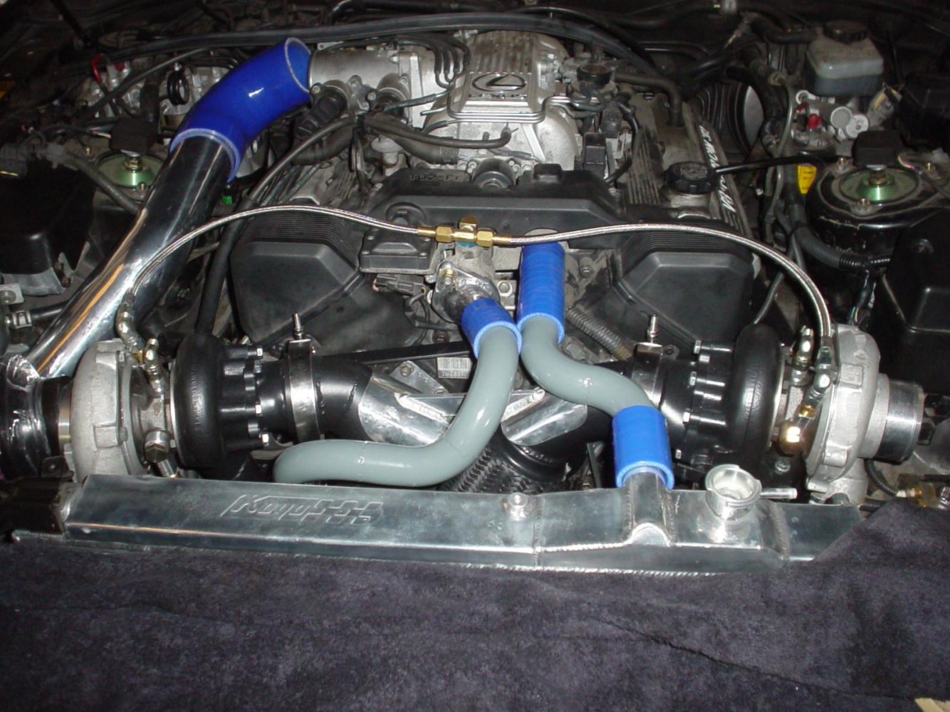

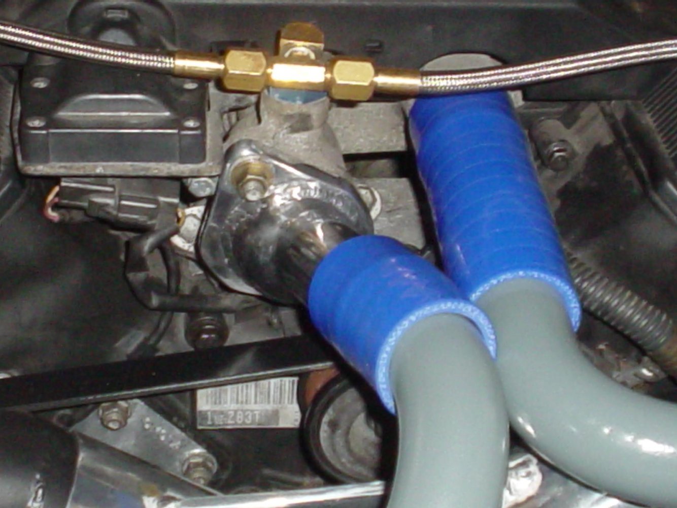

Here are the Water pipes before coating...The color will be a gun metal grey...Also notice the nicely made heat shield before polishing....Really nice!!!! :woohoo: The water lines are fitted now and the oiling system is done. More pics to come, soon...
Look at that heat shield...
another close up...
Damn, this project is really getting cool... :approve:
Ryan

Ryan,
You show only one water end. Could you show where you get the water for the other end? Is it the throttle body?
