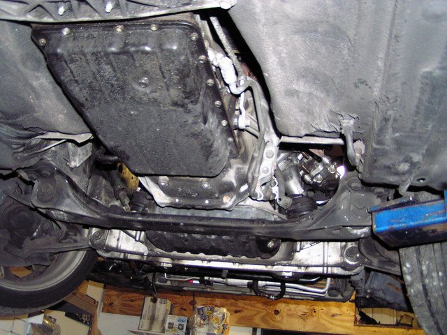

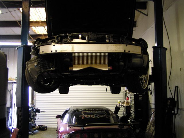

Yes... i was waiting to give a really good write up...Since this site is so much more of a high level, high performance site, I did not want to bore you guys with the many logistical challenges I have faced...My car is now at the third shop since I started this project...I fired the previous one recently when I saw the completed header monstrosity he had created, and that he insisted would work well...Plus, it took him over 5 months to even get to that point...Good news is that I did not have to pay him. He agreed to let me have my car back, and all my parts without any problems...He is a good guy, but not a good FI fabricator. I am on my way to the third shop to take a few pics and deliver the new flanges for the headers he is making...I had previously borrowed a set of S&S headers to mock up a few ideas, and to see first hand, a well engineered set of headers for our cars...They helped alot, and gave us a few new ideas. My car has been at the new shop about a week, and since he was waiting for the new flanges, he could not get too much done...But, he did remove the front bumper and mount the intercooler, plus he re-routed much of the wiring on the drivers side so that they would not be so subject to the heat from the new headers he is designing. BTW, for any of you guys wanting flanges for the 1UZ, the shop I got to make them asked me if he could make extra sets off of my gasket so that he could sell them on his ebay store, so now you can get flanges for a great price...mine are 3/8ths mild steel. The new headers will be mild steel, ceramic coated. Will keep you posted and pics to come...When the project is done, I will post up the detailed write up and dyno results here first...I owe David Phan that, plus I told him I would do that, so I will keep my word. Plus, David helped me quite a bit in the early stages of this project.
Here's a few pics of the car in it's current shop and the intercooler pre-mount...
Ryan
I like the bar n plate intercooler ryan, and the dual inlet in the bottom, and I'm assuming single outlet on top.
Very nice peice, n design.
I need to change mine from a tube n fin, to bar n plate cause of the HP the motor is making.
My intercooler is 32x24x3, and is only rated to flow enough air for 600-650HP
Now a bar n plate is more effecent, but is that intercooler going to support the 900HP your looking to make?

Bob, thanks for the kudos...By itself, it should handle 550 to 650 HP or so, maybe a little more depending upon tuning. Remember, the 900 HP decision came later, not with the original design, and 900+ HP is really only for the dyno numbers, certainly not for daily driving. I will drive the car around with the boost set for approximately 600 or so WHP. I haven't made a final decision yet, but to boost beyond that HP, I wil either make a new and larger intercooler, or add alcohol injection. Probably alcohol...

have you decided on a computer yet?
how thick is the core you are using?
having a core sitting top to bottom like that i don't see how it won't be good over 800whp.
the car that I'm working on. its cooler core size is 28.3 wide 12" high and 3" thick(top to bottom).
this core would handle 1000whp no worries.
I am confident it will handle more than 650 HP, but I have to test it and see...
Mine is similar to yours in size and dimension...I will have to measure it again, as I do not remember all the dexact dimensions...

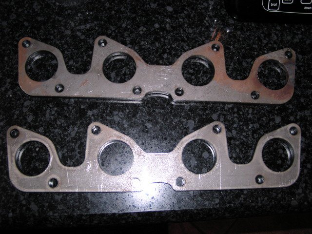

Here is a pic of the new flanges...These are made with 1 3/4" ID ports...Mine are a different set with slightly smaller ports, 1 5/8"...We are a week behind because I had to wait for the 1 5/8" flanges...Made good progress today...three of the 4 primaries were cut and welded this afternoon. If all goes well, the headers will be completed next week and sent to the coater for high heat Ceramic Coating...Sorry guys, no pics of the headers until the project is complete, but I will post up pics of other parts of the project as it completes. These headers are special, and will be jigged so that they can be made again, and again for either V8 SC400's or V8 Supra's.
Getting excited...
BTW guys, anybody that wants flanges like these, whatever size ports you want, you can get these all day long, as many as you want. They are scanned into a Cad machine and Laser cut. I am not selling these, I am not a vendor, just know where you can get them...
Ryan

I contacted the engineer at Bell and he informed me that my intercooler will have no problem in handling up to 650 RWHP. Which is well within the original goals I ahd set up of 500 RWHP. I have done a little more investigation, and I have decided that I am going with Water Injection instead of alcohol. It will give me much more efficiency, and I do not have to augment my intercooler to spend money on an intercooler that will only occasionally go higher than 650 RWHP.

650rw is around 800 at the crank with the Auto. It is very hard for me to belive that that intercooler is going to flow enough air for 800hp, let alone cool it.
