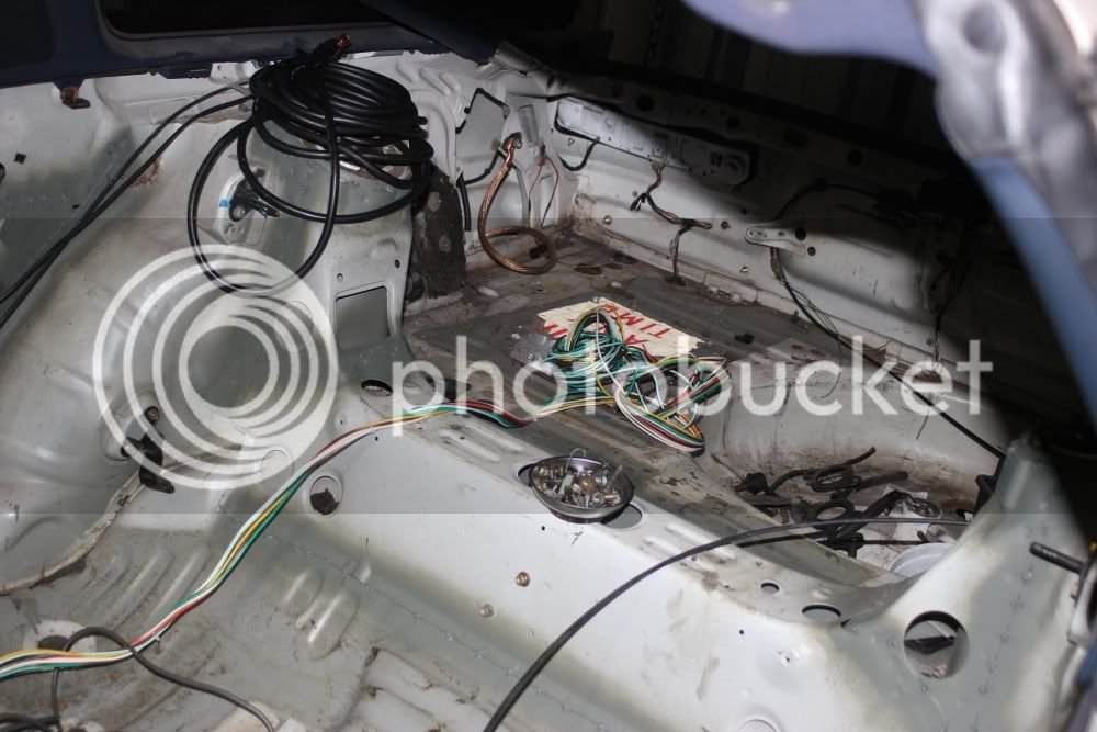

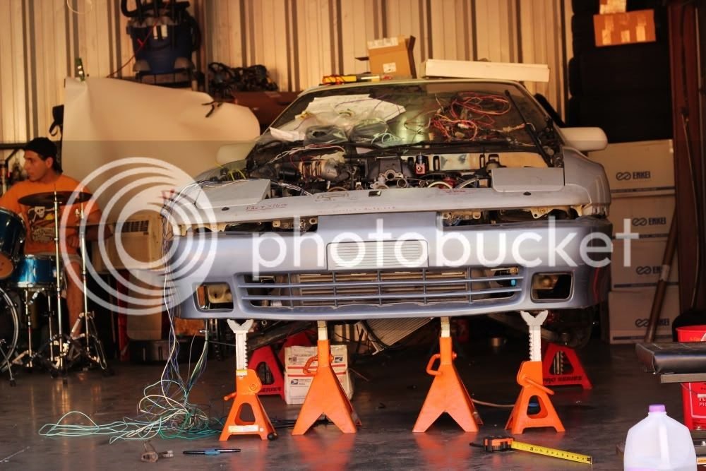

The white goes to the other white wire.. Easy !! Lol..
34052 to go..

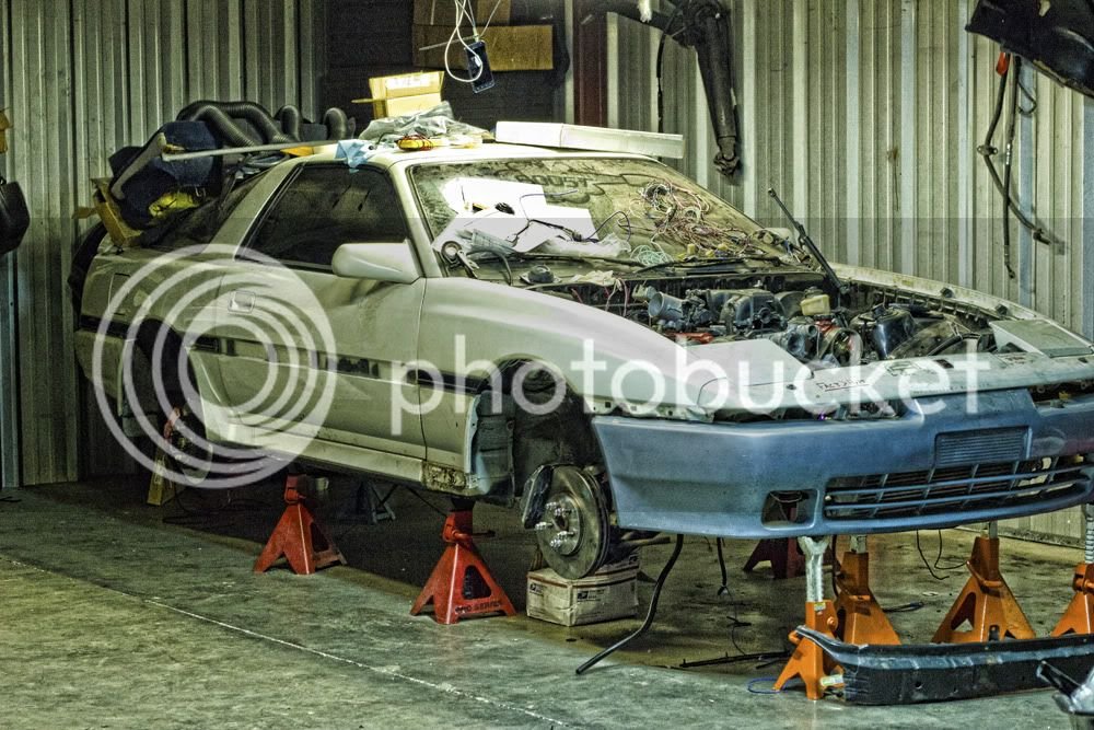

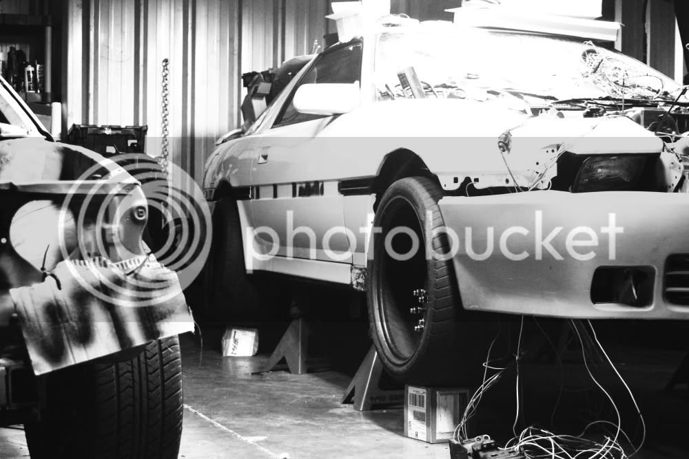

See there's another use for car stands..

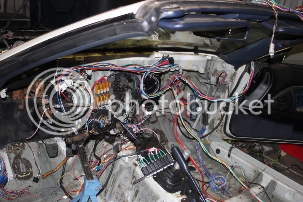

having gone through this with IJ's Supra.... you poor bastard...

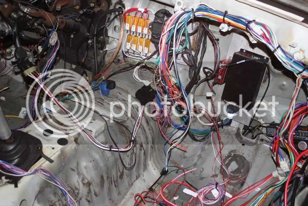

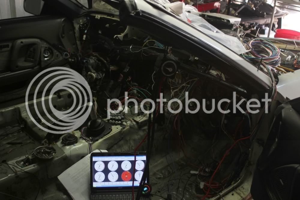

whats with the resistors and stuff on the firewall?
also get yourself some DTM and DT connectors and avoid spade connectors!
Thanks fellows haha :)
The spade connectors are only for the circuit breakers, otherwise I have so many left over connectors from gutting this thing I could use those or buy new ones... havent decided yet.

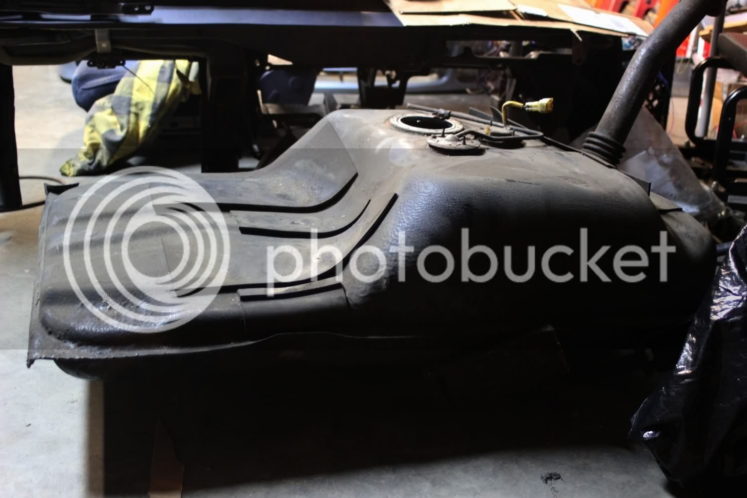

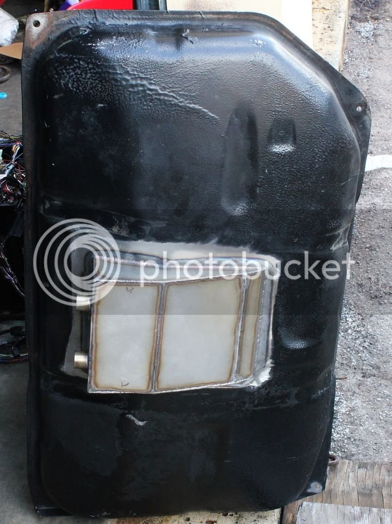

Gas Tank Removed...

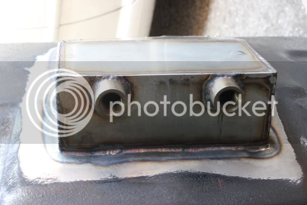

Sump - SS 304 - Why? cause E85. Two 1/2 NPT Bungs and I relined it with POR15

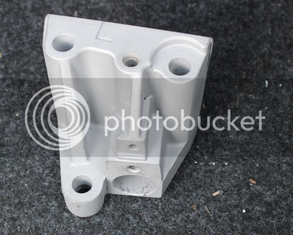

Cam Sensor Housing machined for a clean look...

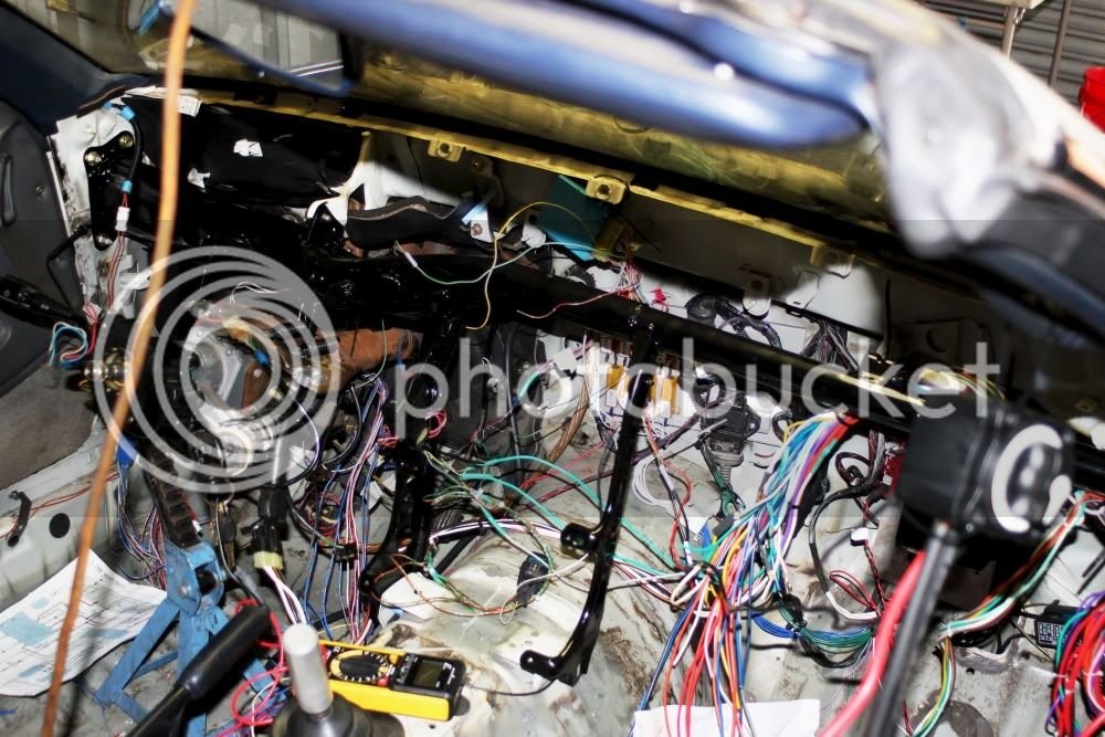

Wiring and more wiring. I removed ALL stock wiring. I kept only the stock switches and functions and everything works so far.. Windows, retraction for headlights, etc... Obviously this needs to be finished... but I didnt want to clean it up with everything not working yet.

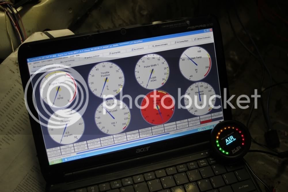

MS3x functions
A very pathetic pop and burble on starter fluid to see if the ignition works...

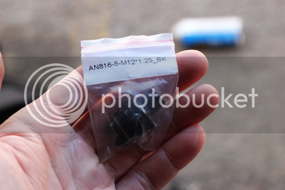

So my long awaited (3 weeks from Australia) -8an/m12x1.25 fittings have arrived for my fuel rails...

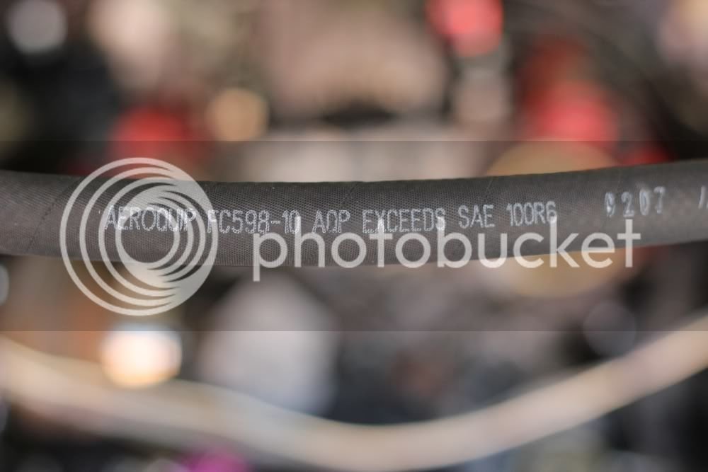

Aeroquip AQP Hose - this stuff is rediculously awesome. Its thick, bendable, has a unique outer wrapping unlike junk fuel like from the auto store. And its E85 (and like 99% other chemical) safe. This is a small piece of -10 for my sump to pump... if anyone has a $20 off $100 coupon from summit that will go to waste, hit me up so I can get the -8 stuff still :)

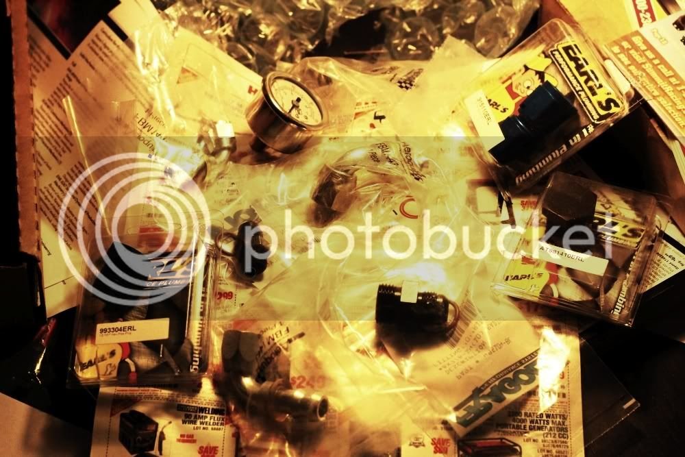

More stuff from Summit... Aeroquip socketless hose ends, Fragola ORB fittings for my regulator, misc Earls stuff, (not shown are Mr. Gasket Shadow series fittings), and a 100psi gauge for my regulator.

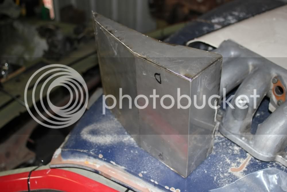

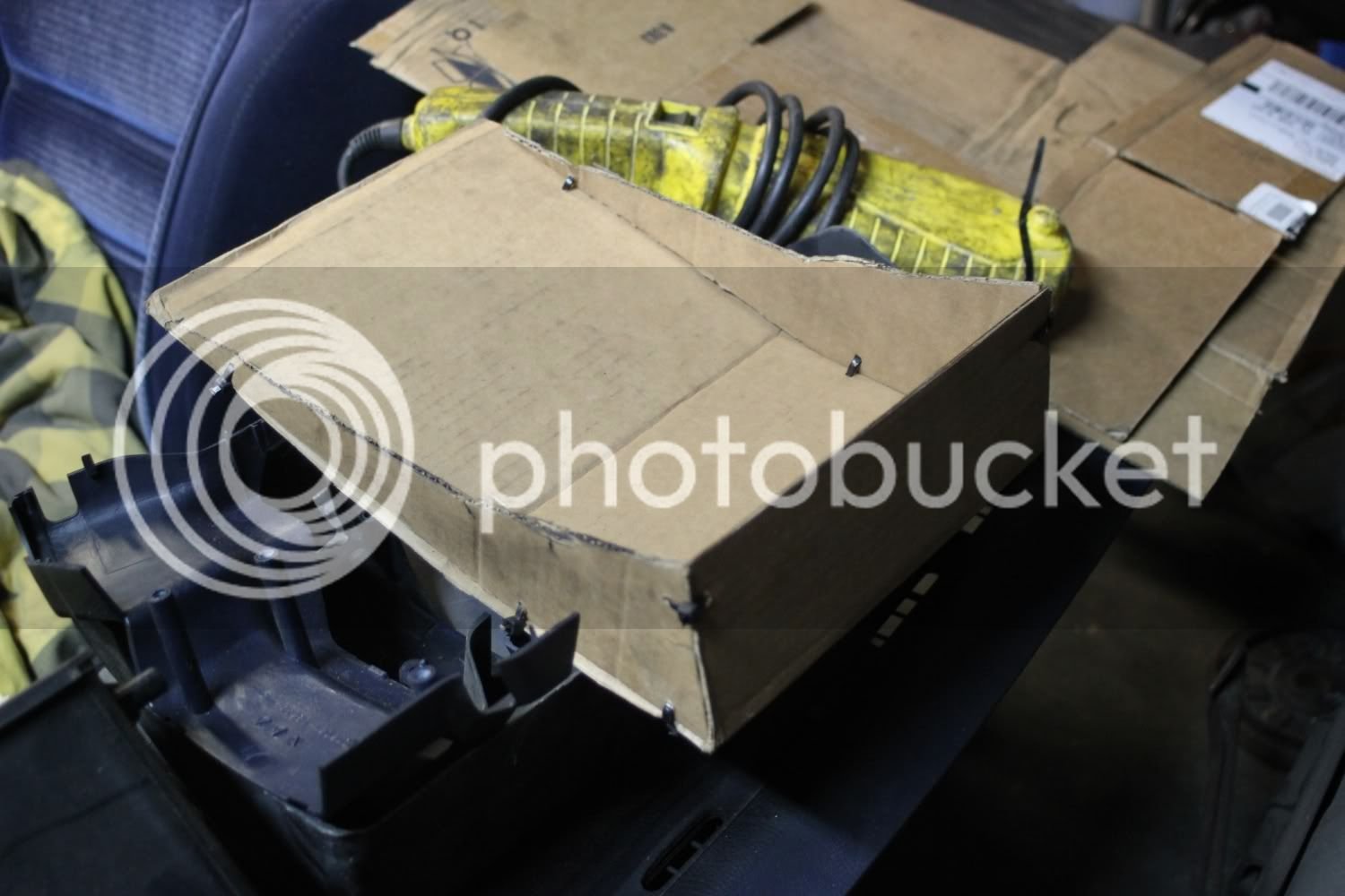

Picked up a used HAHN intercooler with same side entry/exit. Will be a little creative getting it to work, but its a 3.5 core, bar plate... and fits nice. I want to get the S2 Airguide for this still.
