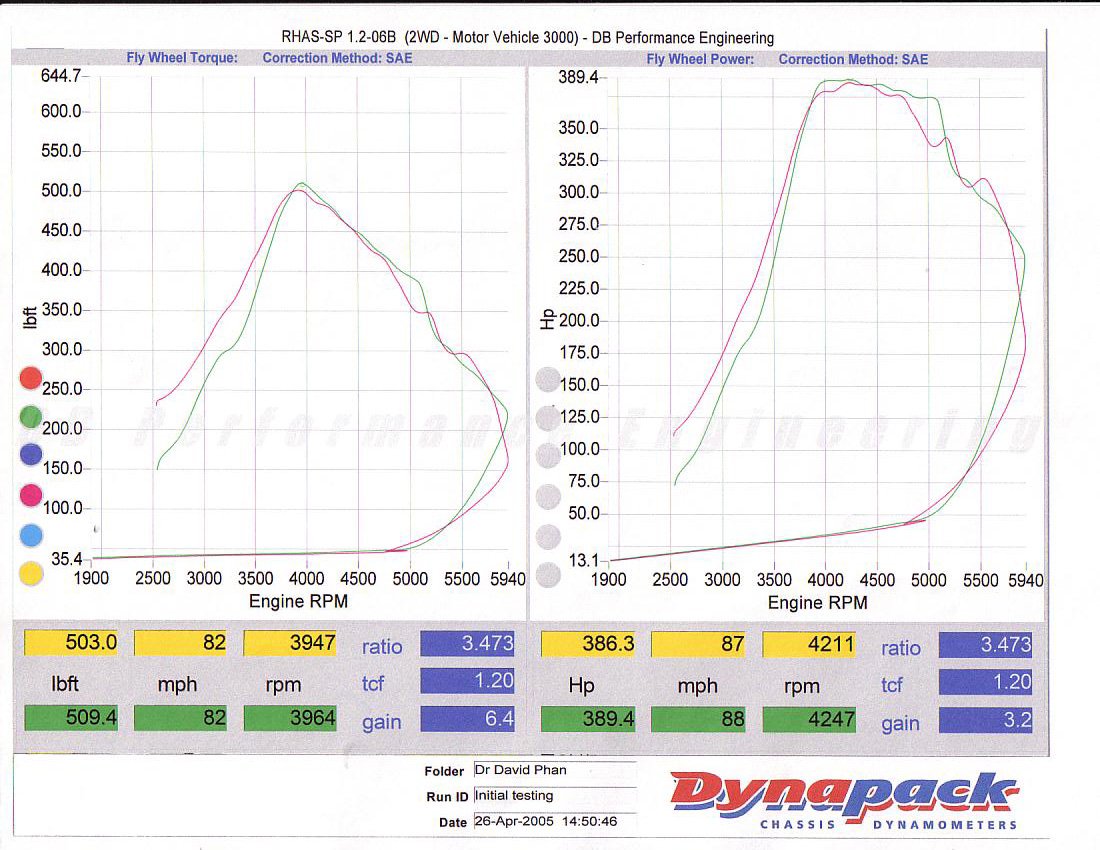

was this using the GT42R?
Very odd to have peak power at just 4200rpm, was the dyno operator backing it off early? The torque peak occurs at roughly the same time and is just a single peak, i would have expected a much broader torque curve than what you have there
You should be making peak power quite a bit higher IMO, which means a fair whack more power. I mean if you could hold just 400lbft of torque to 5500rpm it would mean 420rwhp without any other changes and personally i reckon it should have more torque than that at 5500
