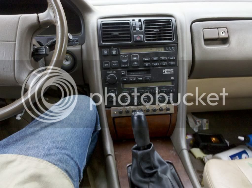

I've searched and searched and came up with nothing except people attempting to do it but never hearing about it again. Well, if I'm wrong, I apologize. Ladies and gentlemen, feast your eyes on the first LS400 5spd M/T.

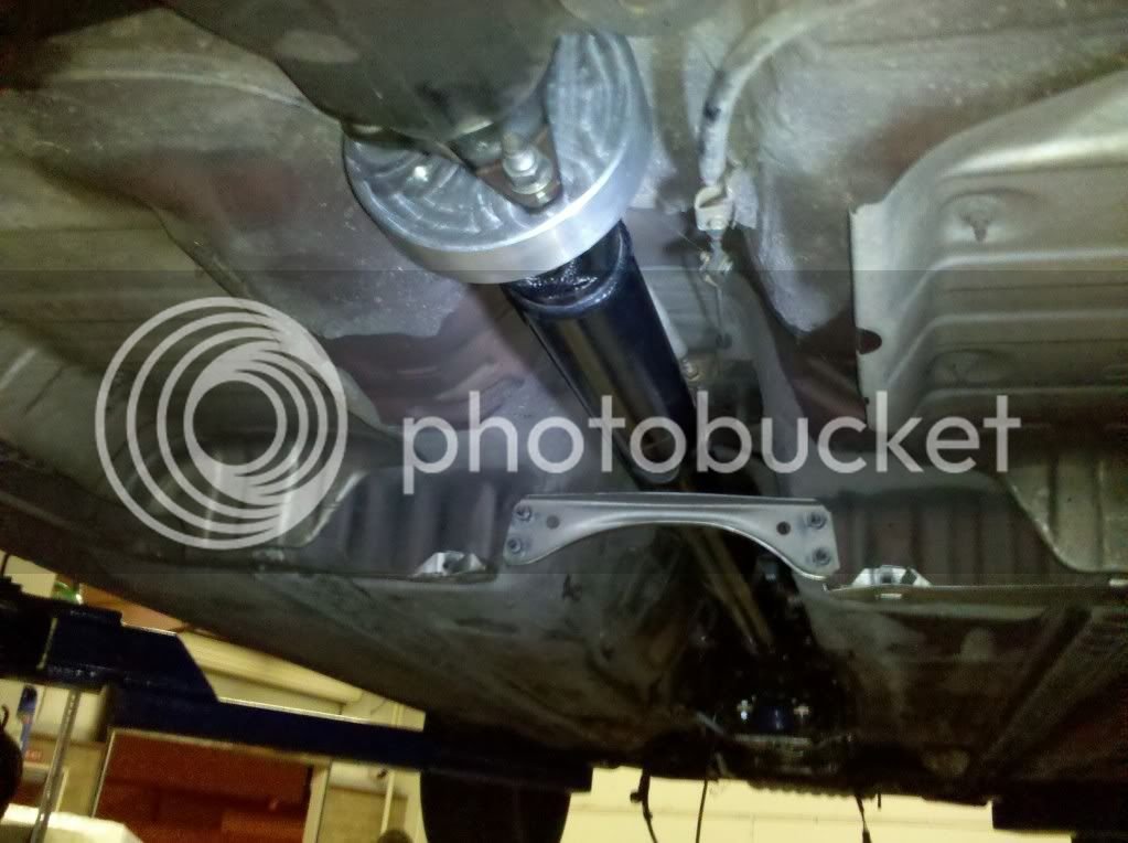

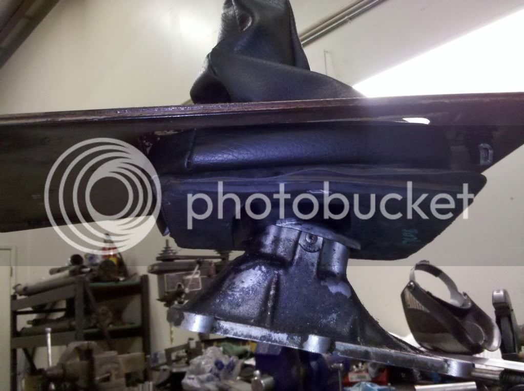

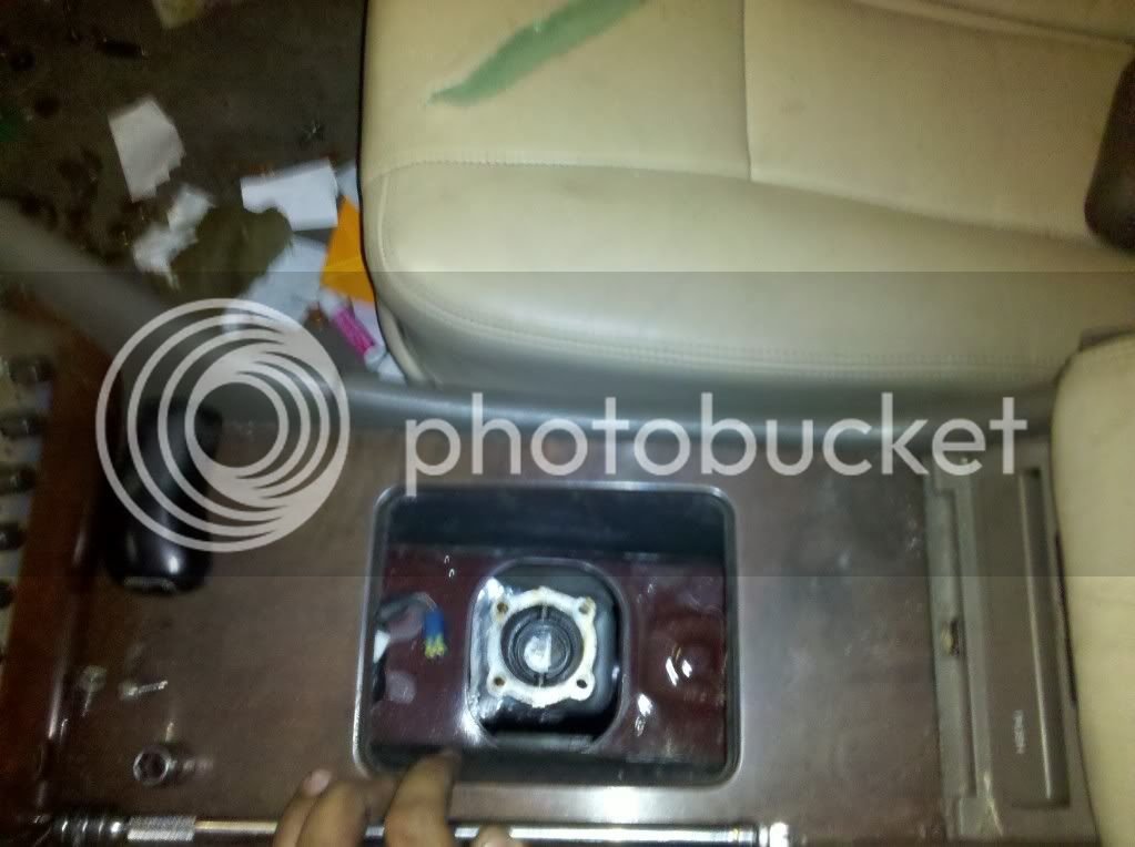

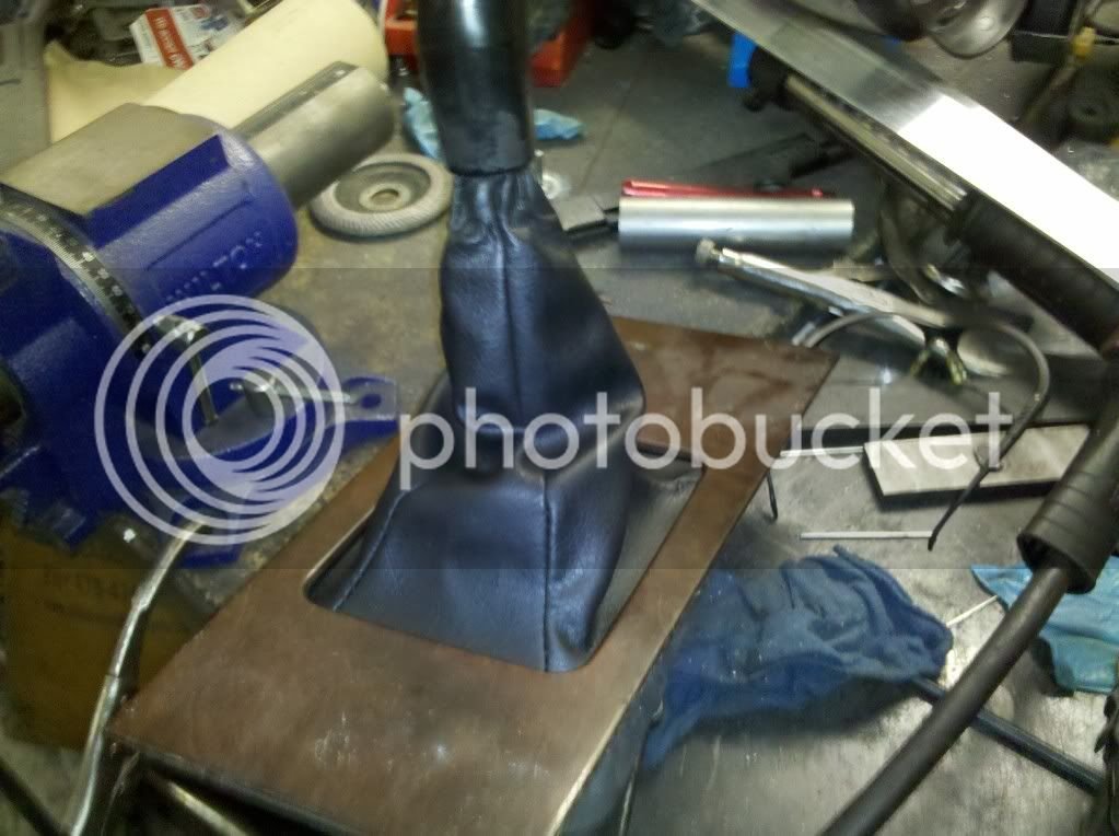

My buddy who owns Daft Innovations was making this for one of his buddies. I put together the leather shift boot to make it look factory so its not that hard. The car is going to be some sort of track/street car so it's still a work in progress. The condition its in right now is the same way it was purchased.

I fabbed the adaptor plate, flywheel, and driveshaft adaptor. Driveshaft id by valley balancing, and everything else was done by rich at daft innovations.

It's a 94. and you don't need the sensors for anything so we just removed the wires from the harness. no codes.

LOL, SHITTY SWAP THOUGH. they didn't even bother making a shifter extension. And that car was done after this one.
