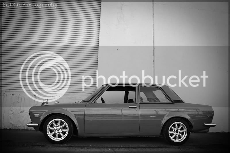

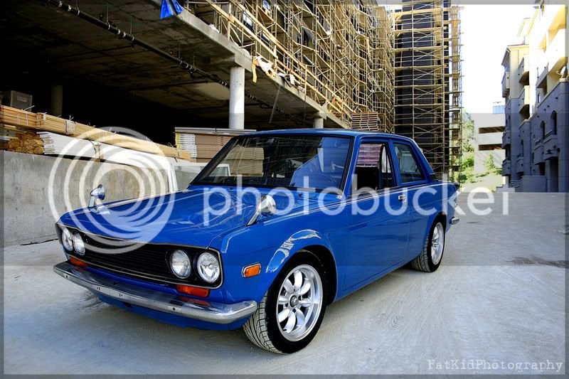

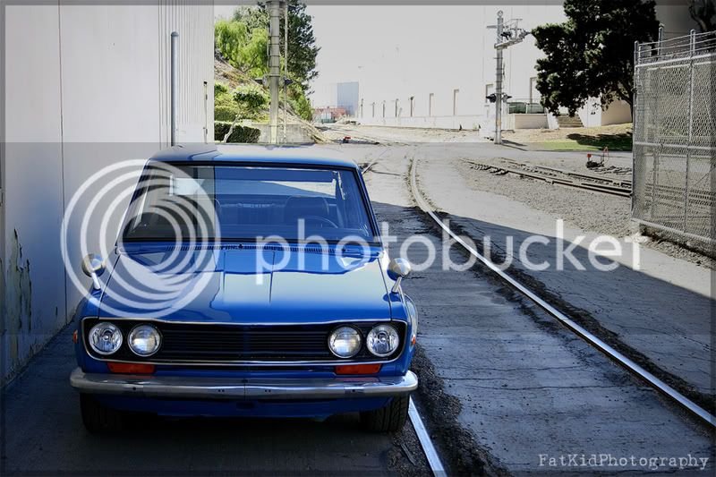

Well its almost time for the swap,I have decided on the r154 transmission,I found a company in new zeland that makes a bellhousing adapter and its like 320 bucks plus shiping.My current engine is a carburated 22r with a 5 speed transmssion,It has a weber 32/38 carburator.This forums seems to be very toyota oriented so il post my question here.What is my current engine worth? I bought the car two years ago and the engine had 5k miles on a full rebuild and since then i have put another 10k miles...

Mate that is a sweet looking car.
As much as i love the UZ (follow my link) for your car i reckon you really should use a light engine and maintain to great handling.
Anything turbo 4 cyl or maybe an all alloy V6 would be the go. SR20 may have been done to death but no arguing with how easy it would be and provide more than enough grunt?
Seeing you have Toyota in there already a 3SGTE would be reasonably easy and similar grunt to the SR.
A UZ in that chassis is a bit of a waste i think unless you just want to go drag racing and go nuts with a TT setup?
