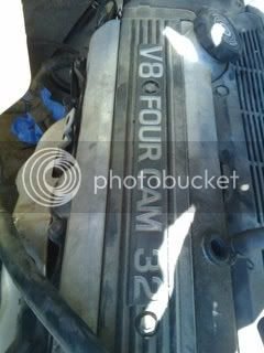

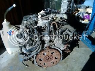

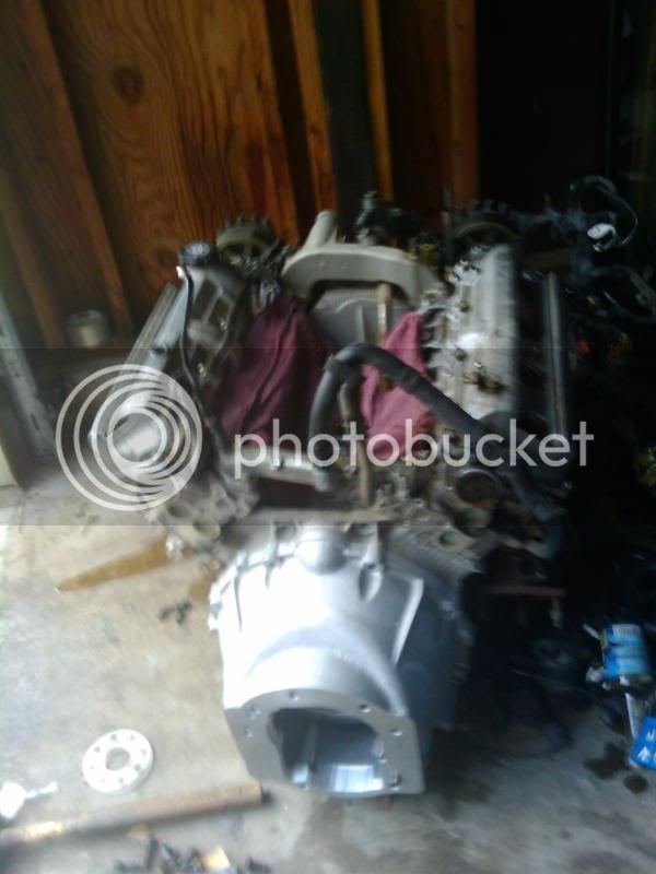

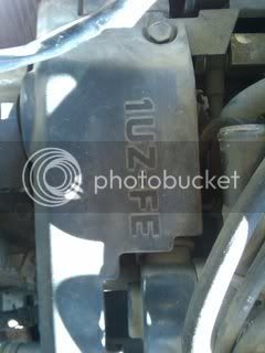

quick update. I went to the junkyard today and picked up a 91 1uzfe complete engine with wiring harness for 300 bucks.i took some quick pictures with my phone. i will take better ones once i clean it up.

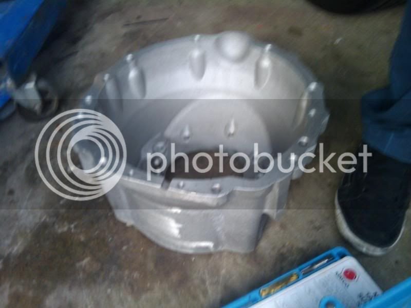

quick update i have orderd the dellow automotive bellhousing kit today came out to 2290 aud in us dollars is like 1500 bucks.. yay cant wait.. for engine managment i have decided on megasquirt.. one quick question for those who are using the r154 transmission what clutch disc are you guys using...

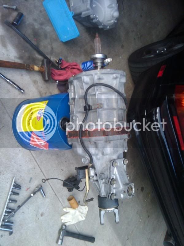

Only took six days to get he kit from australia, I will take pix when I get home .couple more questions what are the thread pitch for the bolts that go from the bellhousing to the ttansmission and the thread pitch for the bolts that go to the engine.. thanks in advance

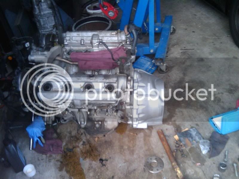

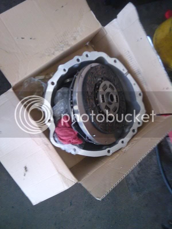

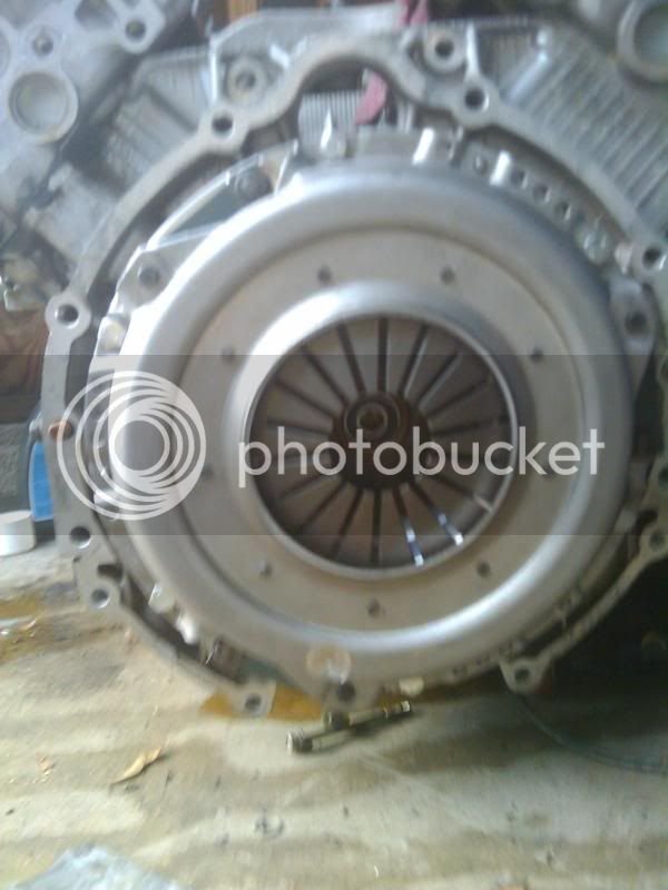

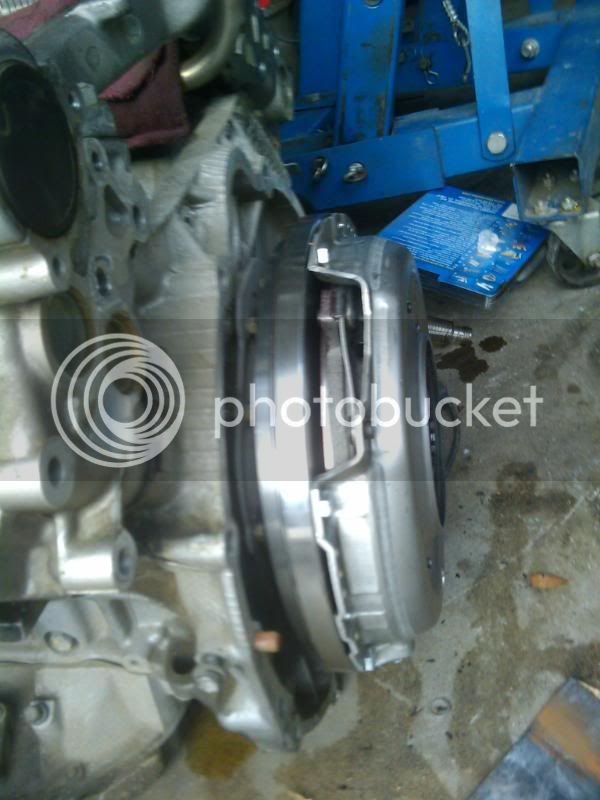

got the dellow bellhousing kit today in the mail.. here are some photos just mocked up the bellhousing and flywheel
everything fit perfectly.

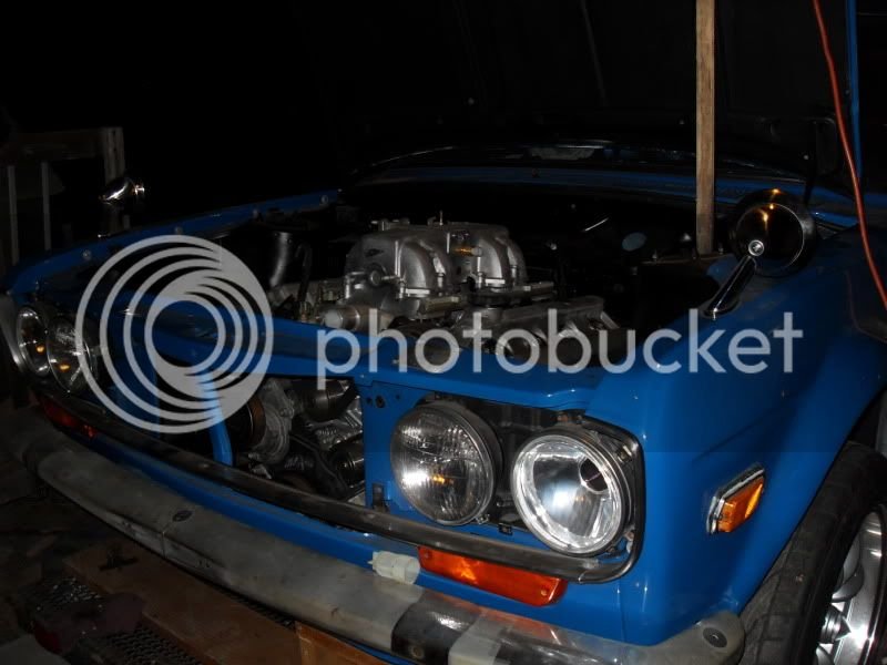

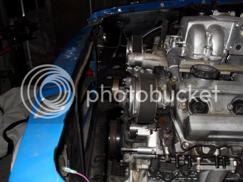

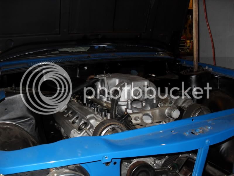

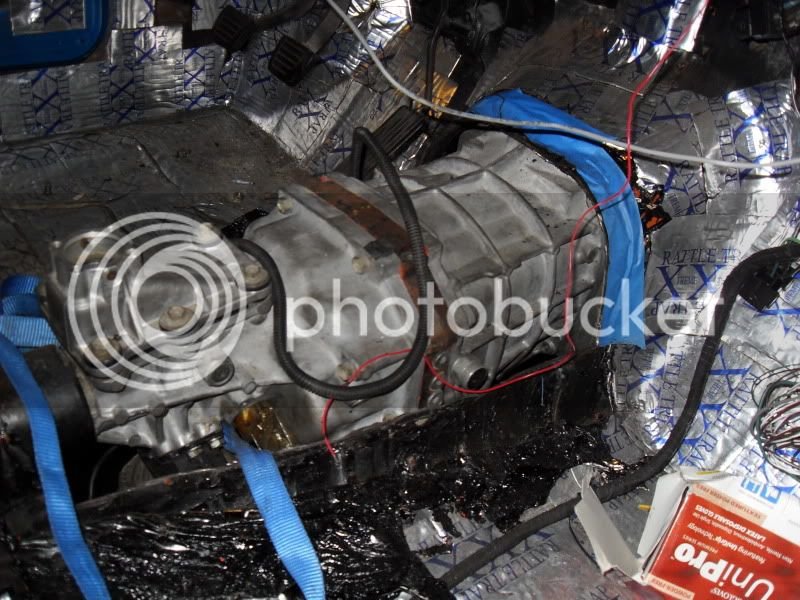

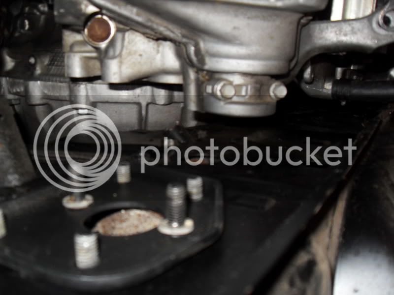

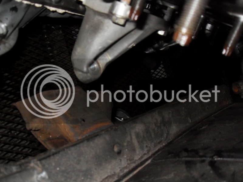

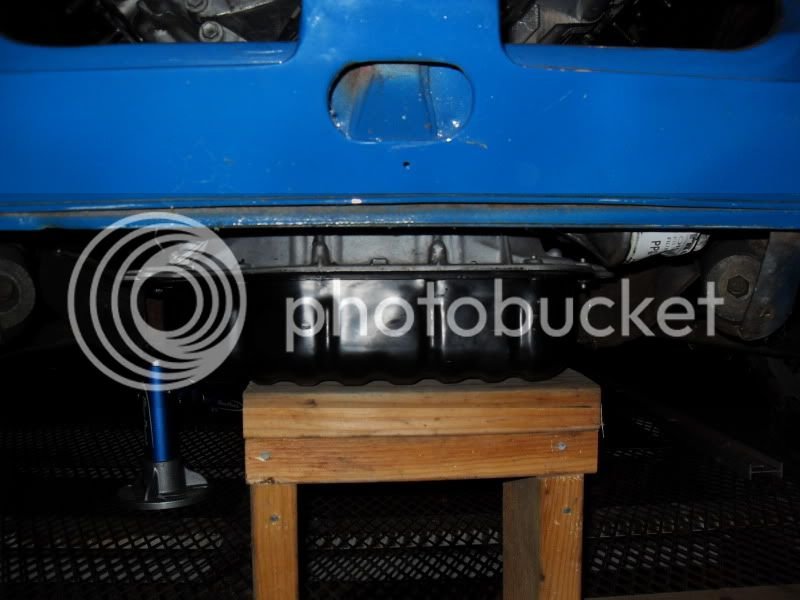

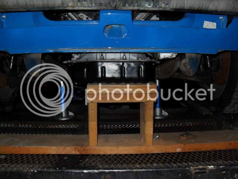

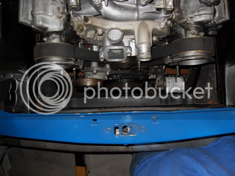

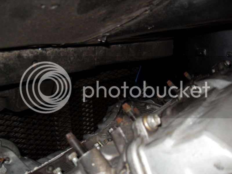

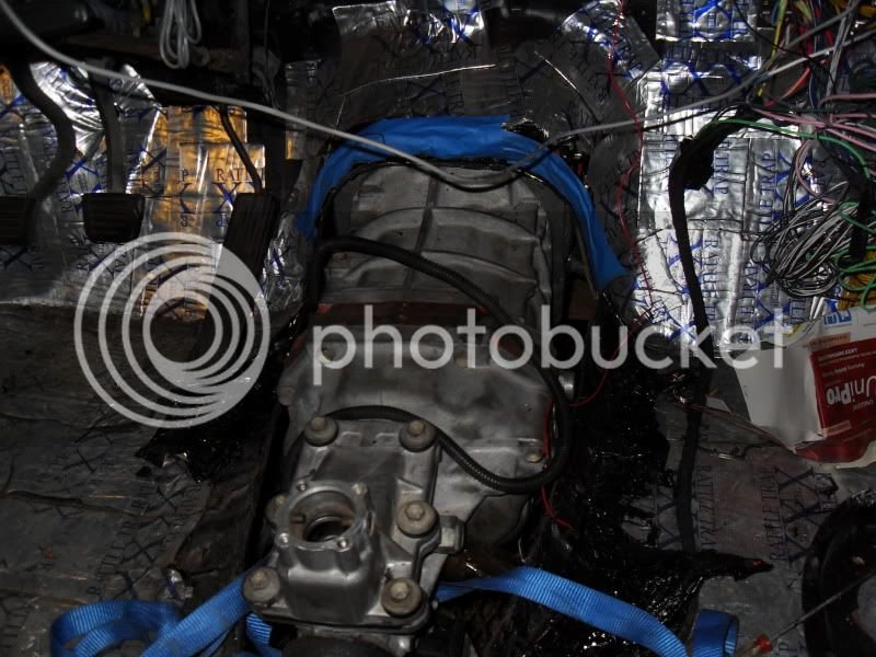

have not been on here in a while, kinda feel like a yo-yo one day i dont want to complete the swap and the next i do.. the engine fits in the car only had to cut the transmission tunnel and have to make a new mounts and cross member.. i got a couple pictures showing the progress, i got a question on the left side of the block there is a large bolt with what looks like a metal tube coming out of it kinda looks like it would carry oil or coolant can i cap it off or is it needed..
