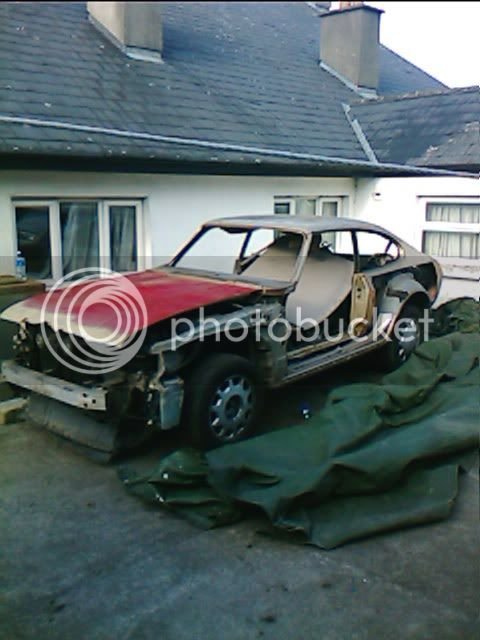

Copied from my project diary 1uz ford capri I really need help on this one folks.
When I started the car after a few weeks standing due to the fuel tank being removed everything was normal.
I was taking measurements and letting the engine warm up when I noticed that the instruments were dead, shortly followed by smoke from behind the instrument cluster. I found that two earth connections were not attached to the body one behind the instruments and one near the passenger side.
I assumed that this was the problem and that I had fried the circuit board in the instrument cluster.
My problem is that I have sourced a replacement and still have the same fault (quickly switched off before any signs of smoke)
When I switch on I have a battery light which works as normal but absolutely nothing else. With the ignition on or the engine running a simple wire tester is showing that I have four live wires coming into the instruments, two for the grey plug and two for the blue plug.
If anyone has any ideas or even a shot in the dark please send me a message.
Would a diagnostic scan be of any help?
Wiring is full LS400 loom (95 model) possible problems include a broken wire from a welding spark or rain water as the project is stored outside under a tarp.
