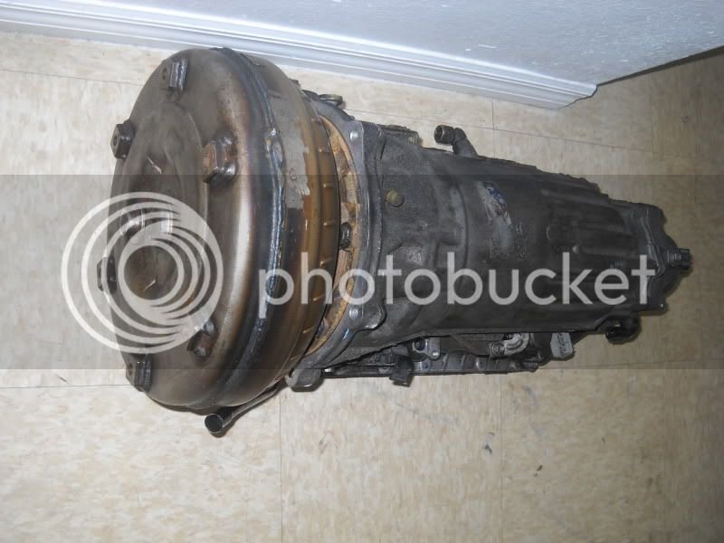

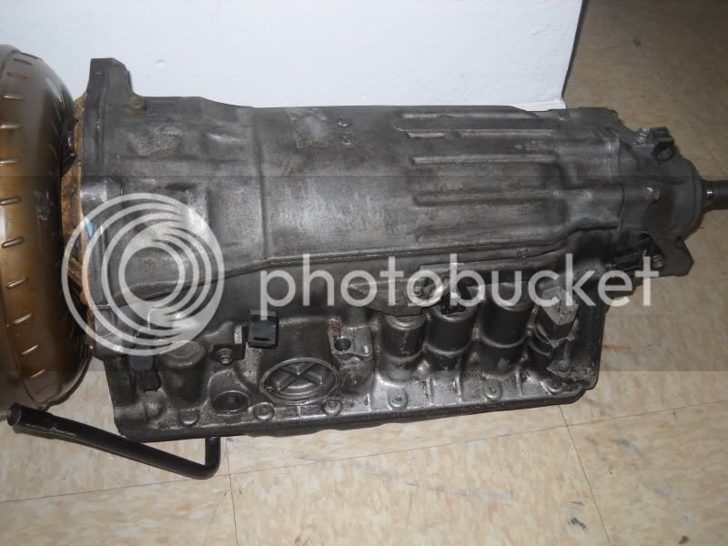

I have what I think is an sc400 transmission but I need a way to confirm this and the bellhousing is gone as well as the tail flange so I need some help in figuring out what exactly this trans is before I send out the tq converter to lextreme and the vb ipt trans.
Thanks in advance!
It's an A340 trans. There should be a plate on the right rear of the trans with numbers to confirm this. As far as I know all the torque converters are the same so you should be good to go. Differences are in the wiring and electronics
It says 30 40 le on that plate which was covered by paint so I did not see it the first 5 times I looked at it:mad:
Thanks!
