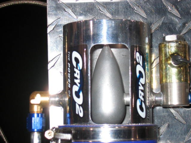

The second thing i would suggest is a CO2 spray. I went to SEMA 2004 in Las Vegas two weeks ago, and notice a company called Cyro something www.lextreme.com/sema.html made an 3" pipe with CO2 cooling. Check out the link. This might be the key for your intercooling quest.

Here is a picture of what i talked about. You can put two of thise and the CO2 outlet would spray into the intake. Almost no madification at all. The below picture is a cut-away view of the internal. It looks like an ject engine. As the CO2 passes through, the gas/liquid cool the pipe. The residual CO2 can be reuse to spray onto the intake for further cooling.

Injecting residual CO2 in the intake would be terrible. CO2 is a product of combustion; you would be displacing good, usable oxygen with it and lowering HP.
