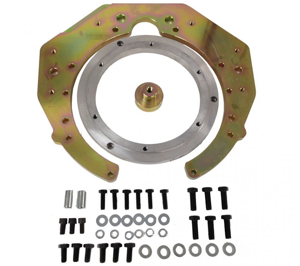

I've got a 1980 Toyota Pickup that I plan on dropping a 1UZ into. The issue I'm running into is trying to find an adapter plate to run the TH350 that I already have when I purchased the truck. I also have an NP203/205 that will be running a doubler kit with the TH350 trans. I come from a heavy Jeep background and this truck will be only used for crawling/off-roading and won't be street legal, so I'm a little out of my element here. Any help would be appreciated!
Australian Street Machine Magazine are doing a 1UZ conversion into a Toyota Lexcen (re-badged Holden Commodore) and they are using Dellow (Australian company) 1UZ to Reed-case powerglide/t400 bellhousing, with a US-sourced Reed Case to regular T400. From memory, the 350 and 400 are the same bolt pattern. See vid below.
