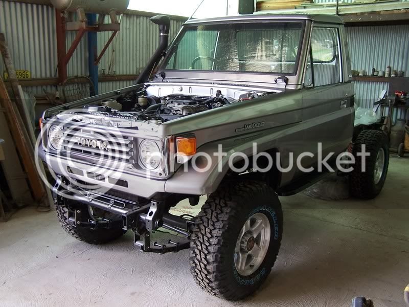

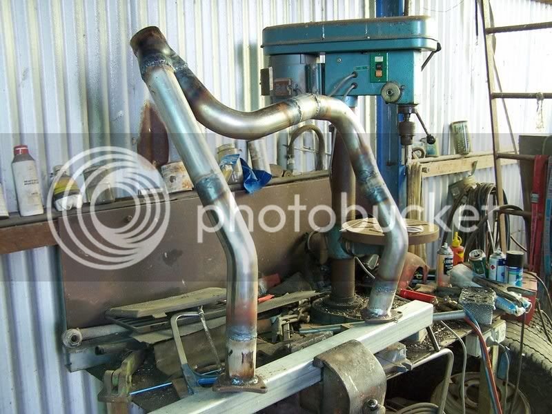

A few weeks ago my old man helped me make a start on my exhaust. I'm running twin 2.5" pipes into a single 3". Here's a pic of the front pipes.
What headers are you going with? Exhuast flow gains are big with the 1uz's when comparing to the stock cars and stock exhaust these motors came in...
Nice mandrell bends on the pipes... I am wondering with all those weld jobs on the pipes will it slow down flow or did you smooth or mate the pipes smoothly on the insides with each weld connection??...
Hi Jib, I am running the stock Soarer manifolds. We lined the joints in the pipework up flush before welding. It isn't perfect by any means but is better than i've seen come out of some exhaust shops.
After all this is a four wheel drive, not a drag car. As you say it will flow better than the factory system.

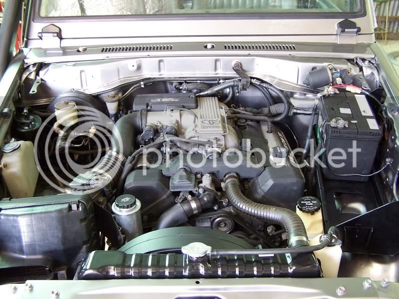

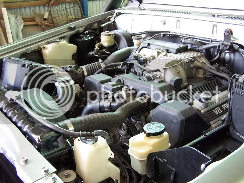

All things going well, my 1UZ will be running for the first time in it's new home this friday 8/2/08.
Sideshow (a member on here), is travelling 3.5 hours from Sydney this friday to wire my conversion.

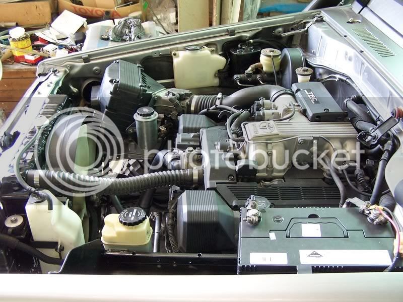

Last weekend I drained the tank of the 4 year old fuel and gave her some fresh premium unleaded. Also changed the oil, filled the cooling system, power steer and hydro fan.
Probably have forgotten something, but will post some pics and vid soon...
Well sideshow came up on friday and completed the wiring. He did a top job and the 1UZ is now purring like a kitten (read cranky kitten).
I just have to rig up the throttle cable, fill and bleed brakes and clutch, then I can go for a drive.

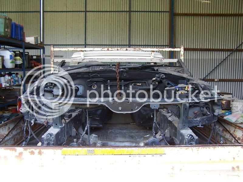

This is whats left of the Soarer frontcut going to scrap

Got a few things sorted..I think ie Cold starting..also I went for the single exhaust for a couple reasons..main one was for torque..2 pipes don't give as much as a single does but on the flip side twins give better flow and top end.. my truck is going to be a winch truck and speed is not what i need..MORE TORQUE BABY..hehe but thats about it..Might SC it later to get more tq and Hp and go with 35" Simexs when my superswampers have been there done that..cheers..BTW looks too tidy..LOL
Yea I have had Holden V8's before with twin exhausts and they sound good but after talkin to people in the know they say the UZ's sound just as good through a big single, which is cheaper and after all it's a 4wd not a street machine.

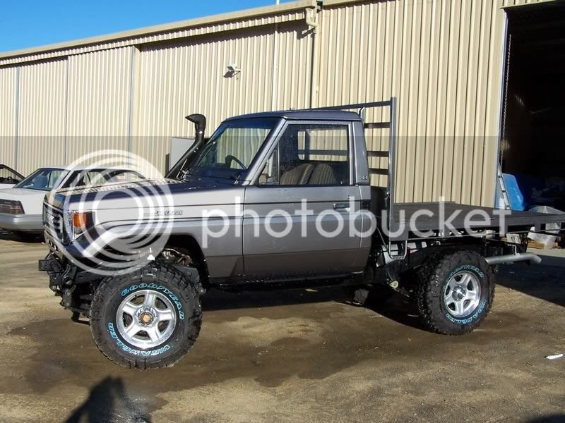

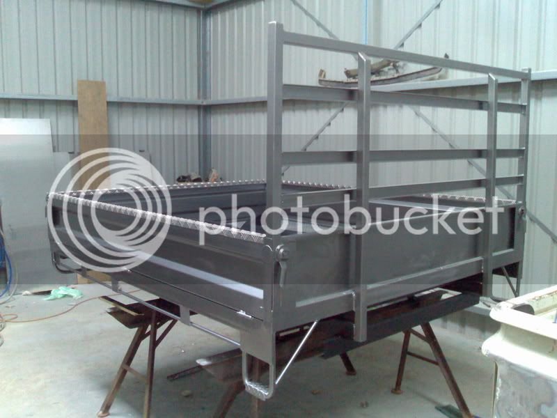

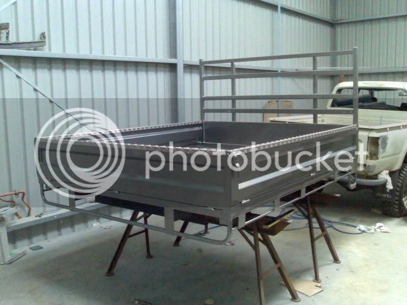

Tray back is now painted and ready for refitting, not long now and it will be engineered and rego'ed. I drove it about 15 km's from my parents place to my mates workshop last week and everything seemed ok, was happy with gearing and performance etc.
Phone pics of tray

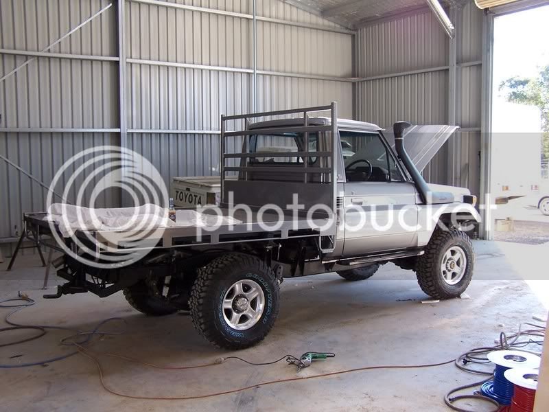

Here are some pics from yesterday when we fitted the tray. Next job will be to fold up some mud guards.
