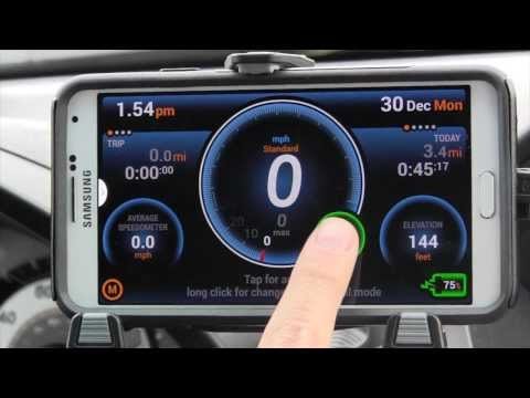

If you've got plenty of money, buy plug and play. If you're at all interested in getting this to work with what you have, learning about it and seriously, it's not like brain surgery, it's just like reading a map- You can do this. There are thousands of hoodie wearing, hat on backwards young kids that have stuck these engines into things and got them to run. Heck- some of them are online and are willing to help. I know from Toyota experience with the Camry & LS300 & the 2GR engines, that you can get these engines to purr like factory installed units, with them bolted to a wagon. They only need the sensors wired that are responsible for engine management. After that- it's up to you what else you want to hook up. All my gauges are going to be stand alone, with signals taken from the engine itself, not the ECU. My speedometer, is a really cool App that will be built into the dash.
