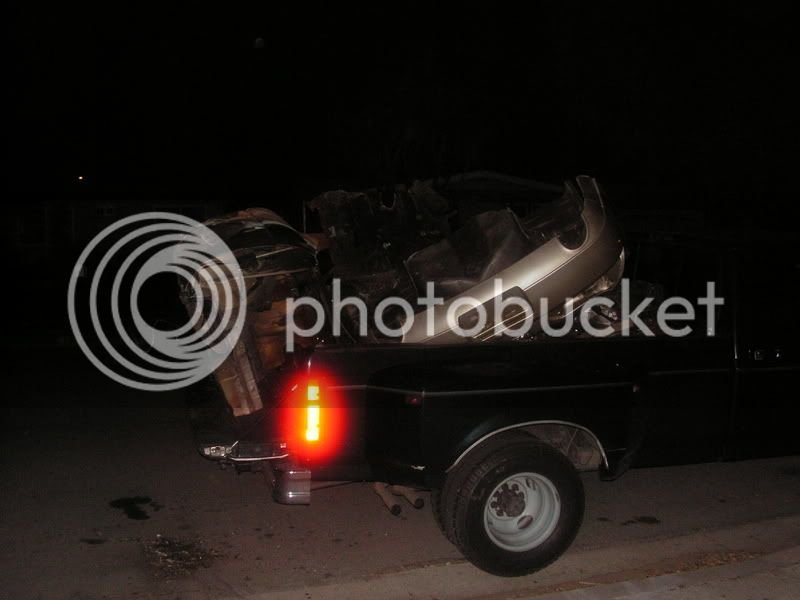

Here are the leftovers. Did you know that an SC400 body weighs almost exactly 1400 lbs? I got $70 at the scrap yard. Plus another $50 for the cats.
