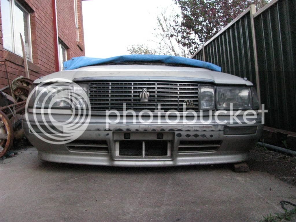

My Crown 1/2 cut wont start. Has spark at the plugs. Cranks OK.
I think it's fuel related as I have rigged up a temporary pump which may not be giving enough pressure.
I can get fuel from the fuel rails by loosening the cold-start fuel line.
Does the cold start injector require a high pressure pump to let fuel into the manifold?
Should the engine start on the main injectors if the cold start system is not working?
Do the main injectors require a relatively high fuel pressure to open?
Is there a way to test if the cold start injector is working? Where is it plugged into the main loom? Test plug somewhere?
When checking for spark, by removing a plug and resting it on the block, I noticed that the plug was dry - no fuel.

Finally got a pump - and some time to play with it!
Now it spins on the starter, lets out a mad GROWL then stops...
It's as if the ignition is only supplying spark when cranking. Once I let go the key, it stops.
I am thinking the injectors are well and truly gummed up (fuel varnish).
Any easy way the clean them? I assume it's off with the fuel rails etc.

Managed to get a VL pump - working, for $25.
I have set it up with it's own battery, inlet filter, 1 litre "tank" etc.
As I said above, I figured that the injectors were/are clogged or "varnished" closed.
I can see that dismantling the fuel rails to extract the injectors would be a complicated task, and there would be O rings etc that have long since dried out etc.
So I figured that it should be possible to dislodge the dried fuel crap with a subtle tap with a small hammer/screwdriver assembly.
I performed the above task, and lo and behold! It managed to start and run! Albeit roughly.... So a second round of taps resulted in a much smoother engine!
And doesn't it sound great!.... The exhaust stops at the cat, so there's no muffler. It doesn't purr,.. it GROWLS!:saevilw:
However, I still want to remove and clean the injectors. Any hints/shortcuts?
