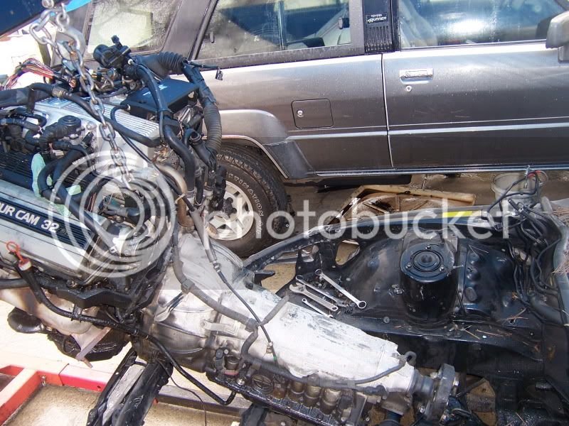

1988 4runner gets a 1uz :)
rma

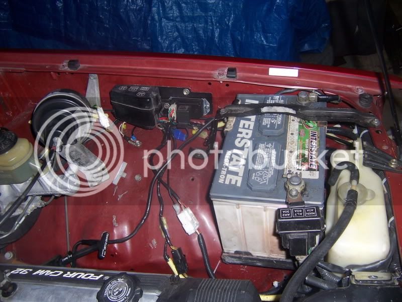

ok so im liking this way to much .. so my wife says :)
picked up another 1988 4runner 3.0 auto , blow head gasket otherwise in great shape .

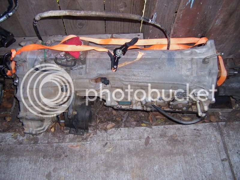

Donor transmission off a 1995 T-100 3.4 auto.

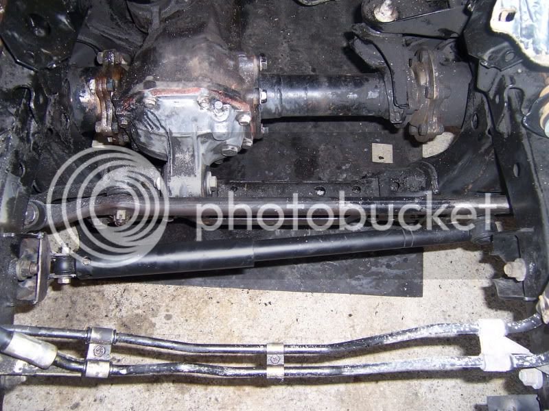

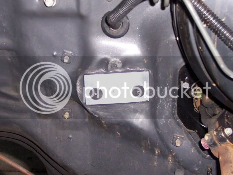

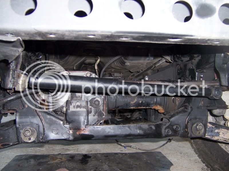

modified the steering stabilizer and e-brake bracket

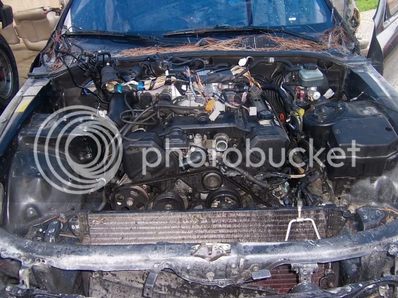

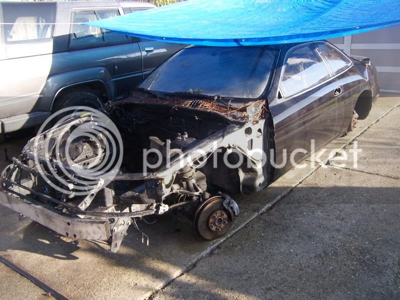

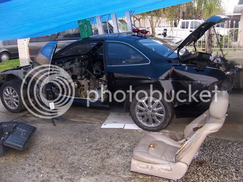

picked up a donor car this weekend 1992 sc400 , with traction cantrol and hydraulic fan :( $700
ok so i havent done a swap using a donor with the traction control .Can anyone tell me if i just cut all the traction control stuff off will i be ok or will i get the check engine light on..
Im hopeing just to wire everything up with out the traction control and not have the check engine light come on .. i will not pass ref here in california with that light on.
ill do some searching on here but if anyone of the experts can tell me that be great . Thanks !
thanks alot for that gloverman.. did find a few threads but non were really definitive. ill just leave eveything off.

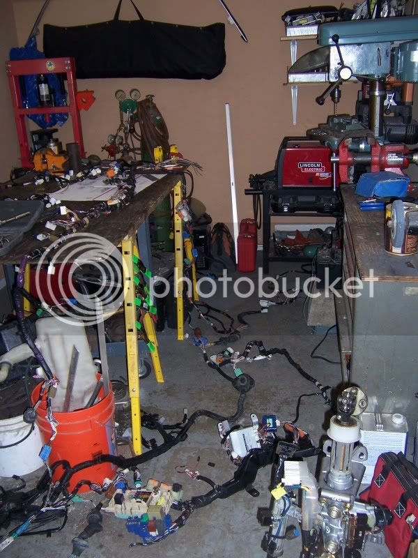

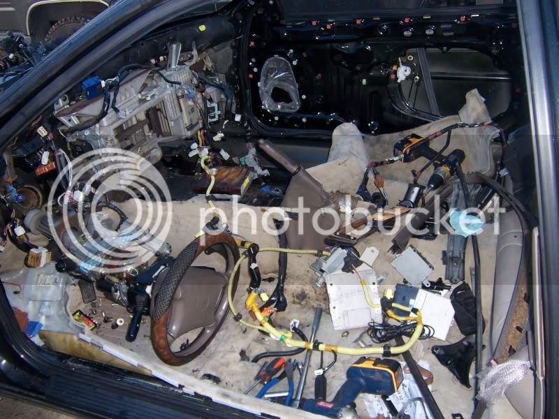

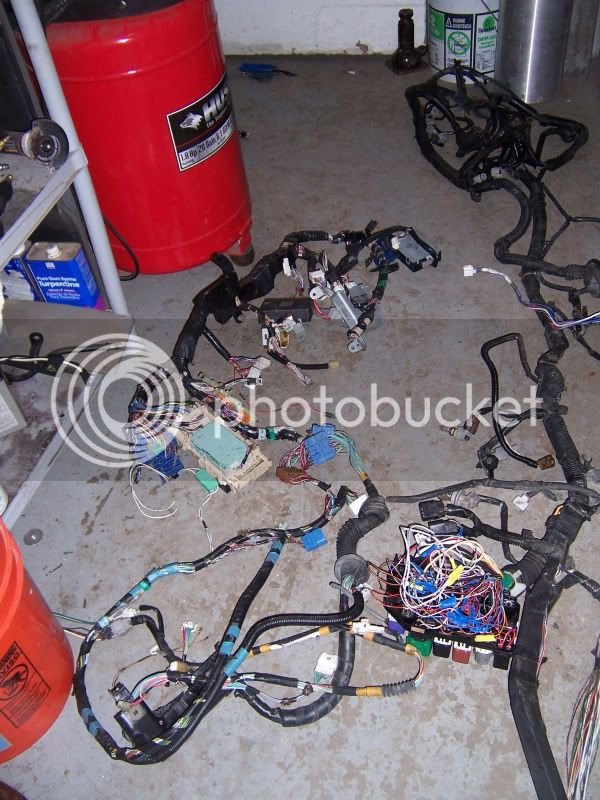

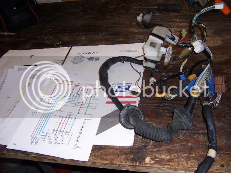

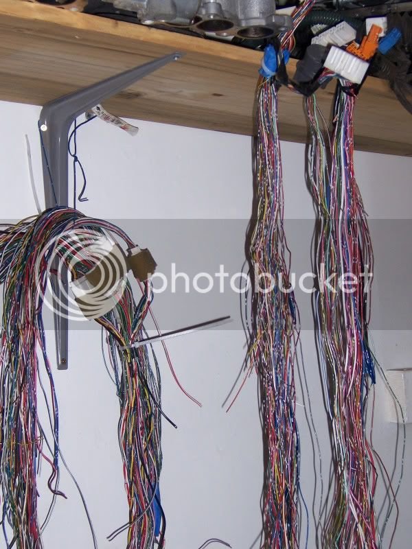

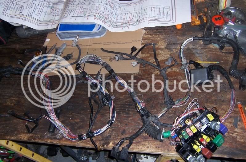

havent done much .. but heres a couple wiring pics .. just familiarizing myself with the wires and labeling them , getting them ready to splice back together.
couple more pics :)

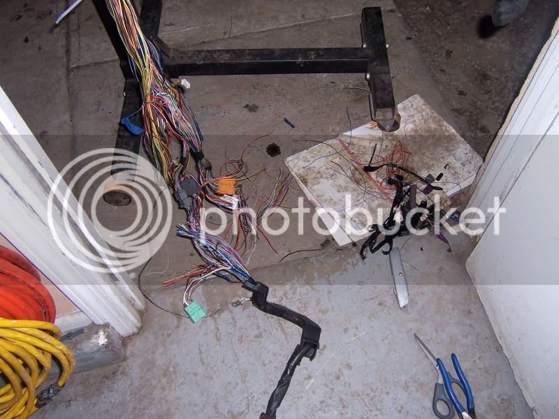

cluster wires and connectors

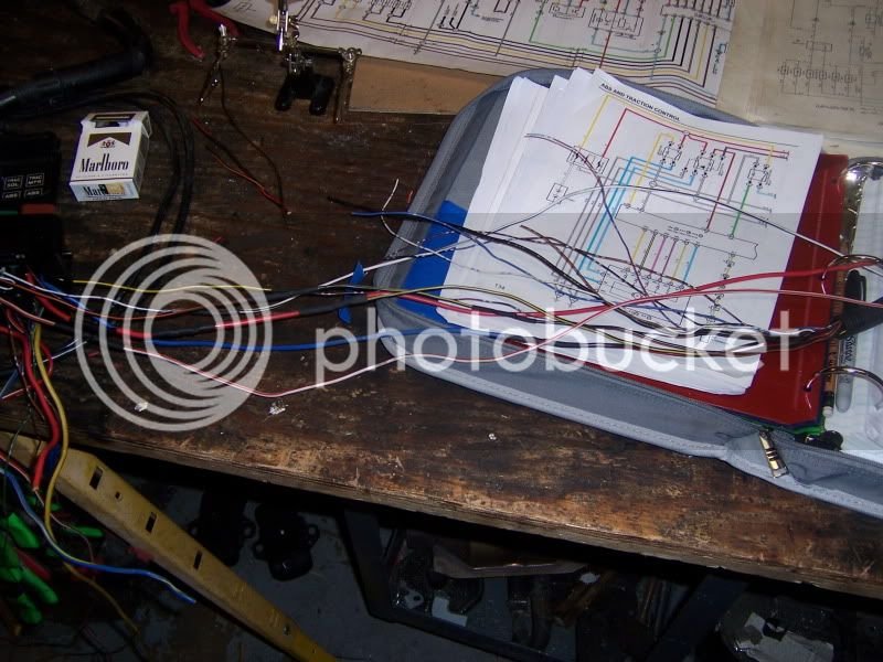

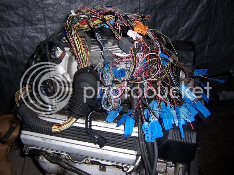

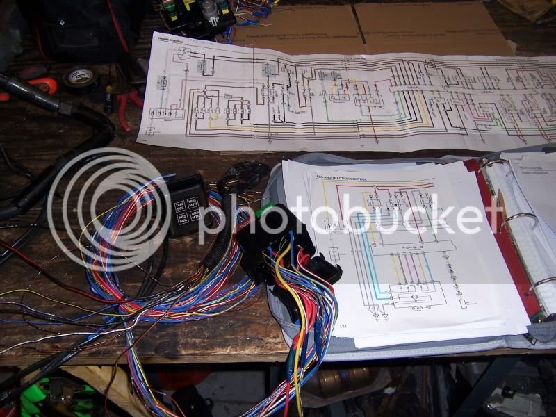

ok so finished with labeling and identifying the wires and connectors i will be using off the engine harness.
i will be leaving some wires as spares .. will add a connector on both sides of the firewall for any future wiring that the owner may want to do. wires will be thru the firewall already for him .
ive starting on thinning out and labeling the harness for the alt and main power to the ecu

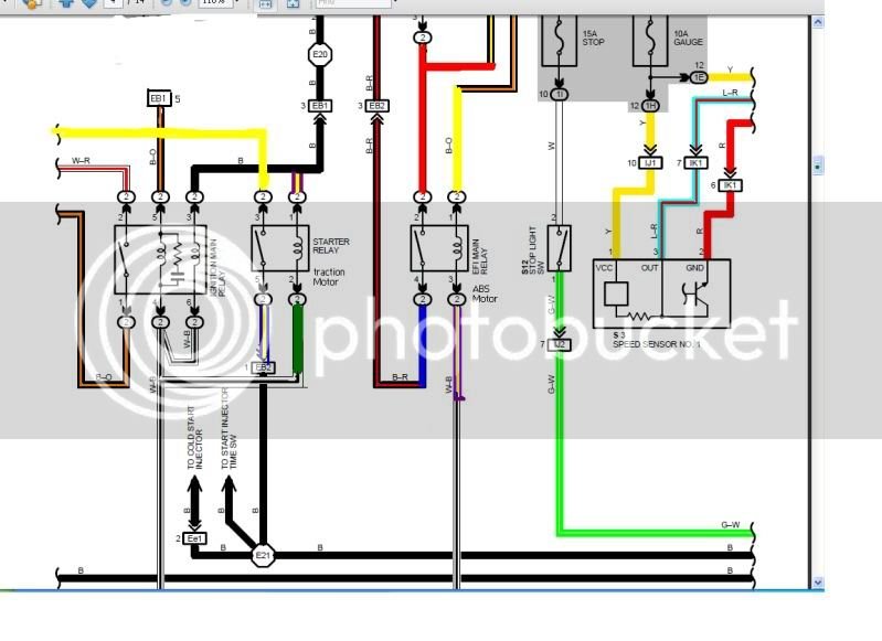

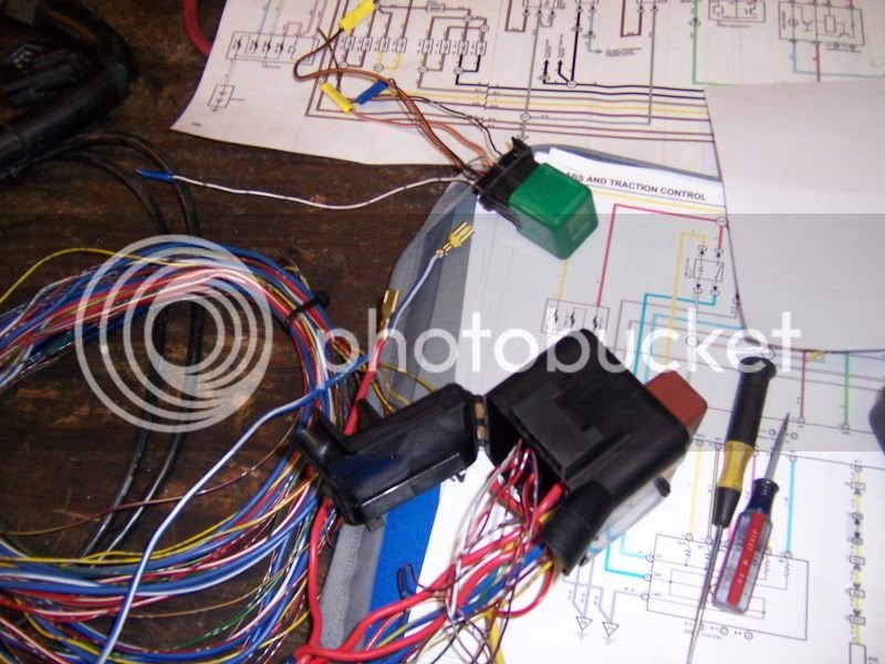

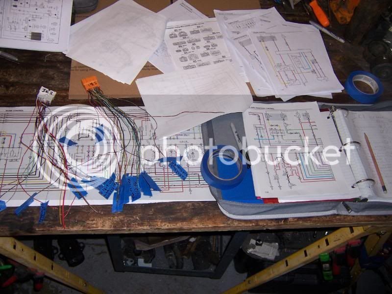

got some wires identified and labeled .. i also found a mistake in the diagrams .. between two of the diagrams they tell you different things .. one diagram is right and one is wrong for the same circuit. not really important but found it none the less.

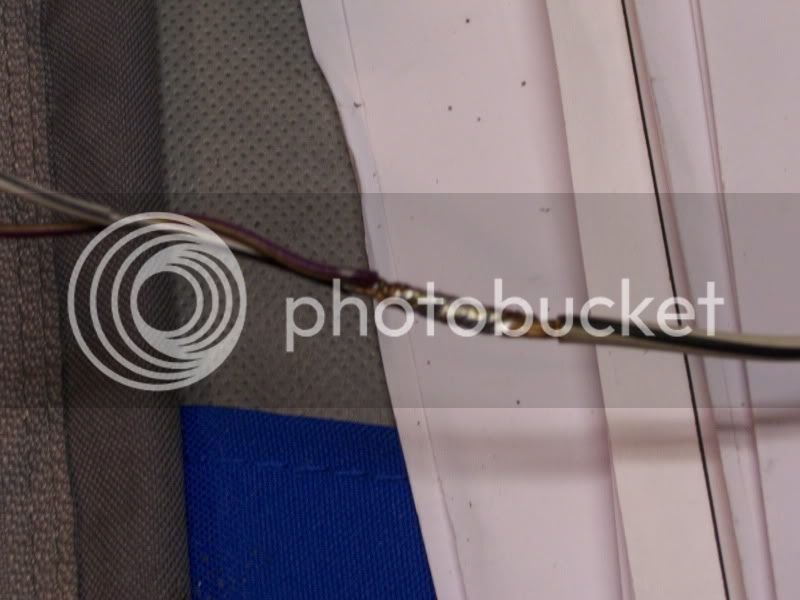

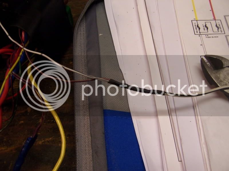

finally started soldering
this is what i kept from the harness pictured above

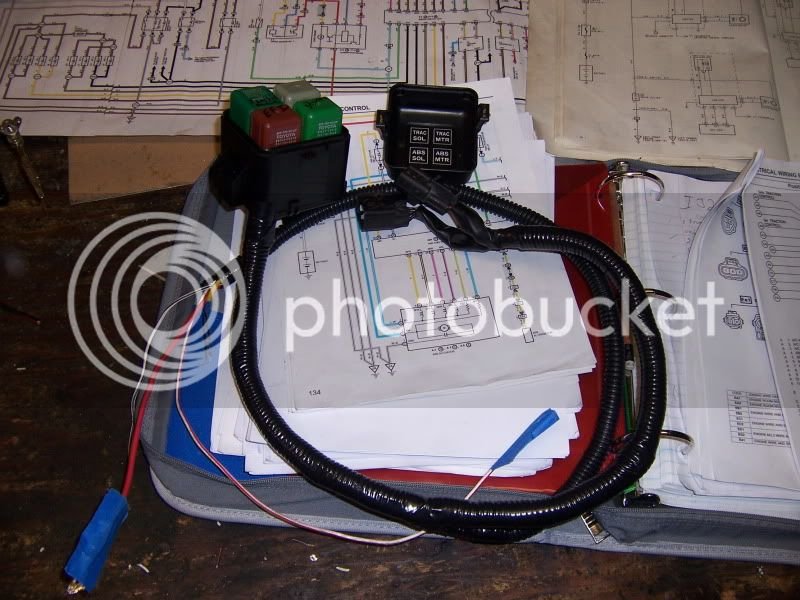

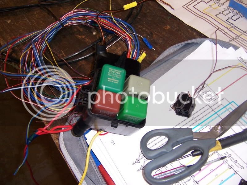

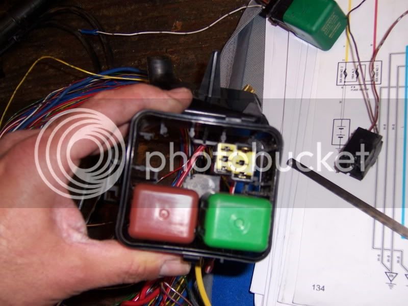

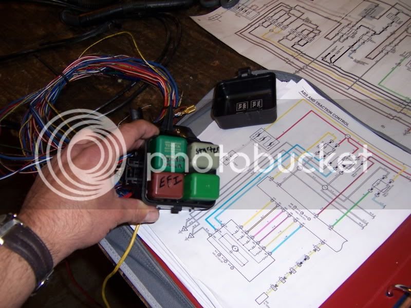

gonna use the ABS relays and box to power the what the EFI,Starter ,ignition main relays were powering in the sc.
wired the EFi relay and half the ignition main .. got tired
almost done with this small harness .. i basically followed the engine diagram exactly , but used the abs relays instead

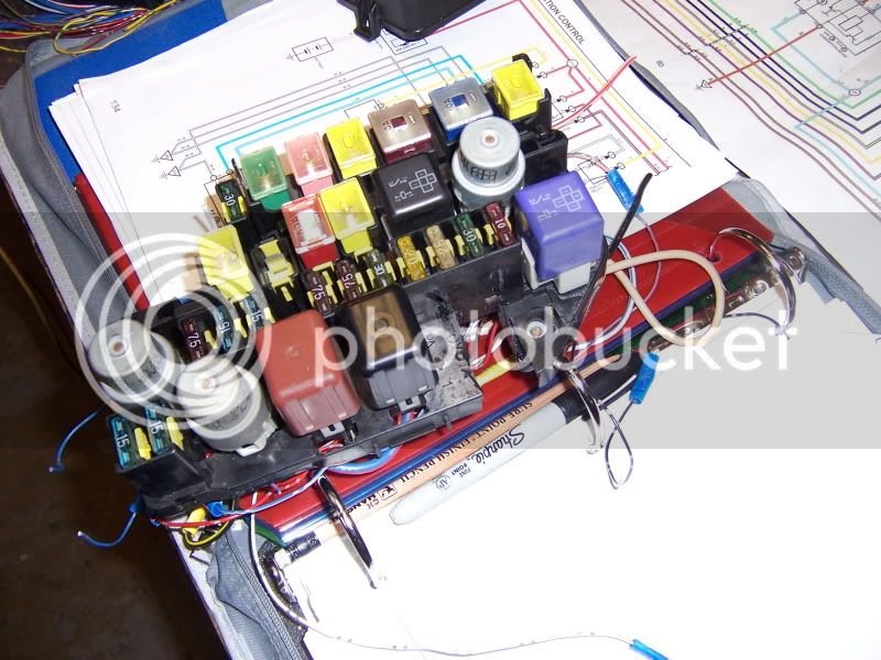

still need to go to the junkyard and get the fuse box ill be using for the sarter,EFI,Ignition main relays.. same one that was used on the maroon 4runner ..
you can see it here attached to the positive terminal of the battery..
so heres a partial diagram of the above harness.. the fuses are not pictured
