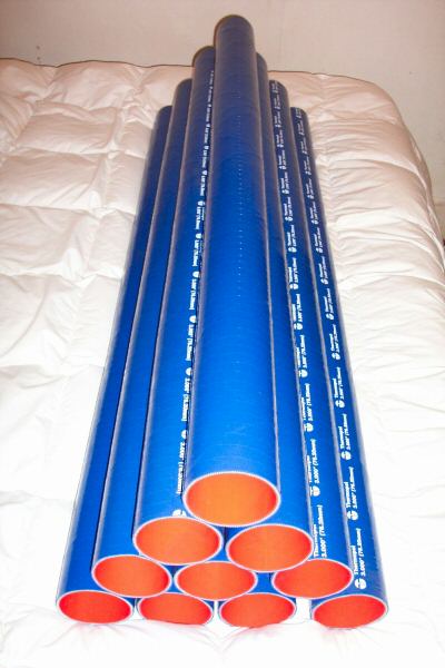

However, if you to ebay and I have found you can get 4 feet silicone turbo hose for $35.  That is a great deal.  Here is the breakdown for the ebay turbo hoses.
* 2" length hose is about $1.45 each
* 3" length hose is about $2.19 each.

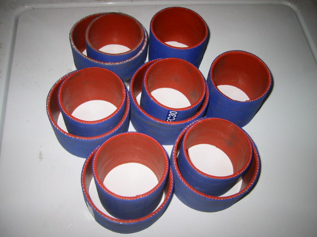

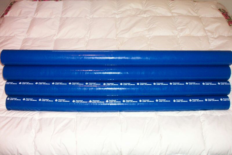

Here are some pictures from ebay hoses:
Beautiful hoses!  You can save lots of money if you are on a go fast budget.  This is the technique you should apply when you receive your hoses from your bid.  Here is the step by step instruction.

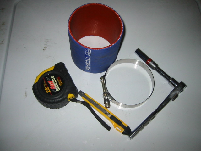

You will need the following tools.
    * A Measuring Tape
    * A T-Bolt Clamp
    * 7/16" Socket
    * A Sharp razor blade (use a new blade)

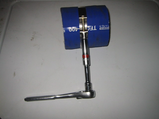

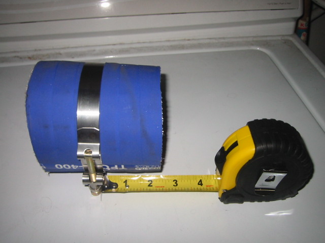

Step 2: Slide the T-Bolt clamp into the hose and make sure all the whole clamp is evenly distributed.
Step 3: Slide the T-Bolt clamp to the desire length.  I personally prefer 2.5" to 3".  Once again, make sure the T-Bolt is even in both sides.
Step 4: After you selected the desire length, now you can use your 7/16" socket to tighten the T-Bolt clamp for stability.

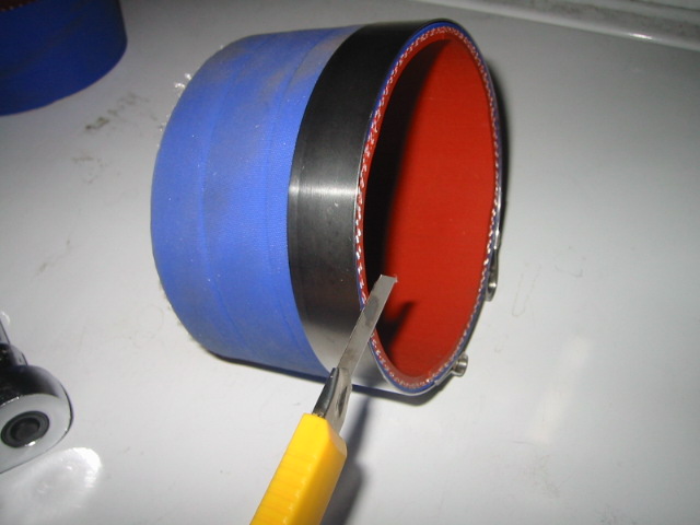

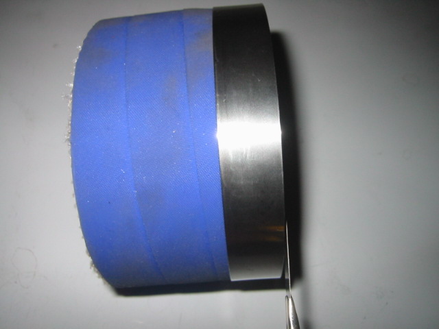

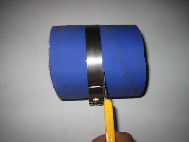

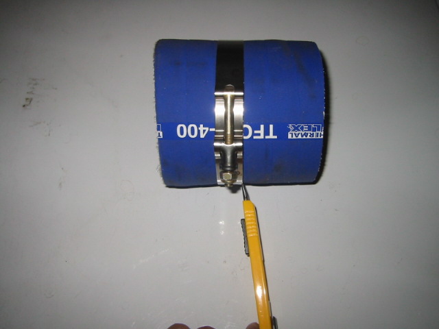

Step 5: Now you can insert the new razor blade right next to the clamp.  The clamp will acts as a guide to your blade.  Make sure you slide the hose and put some pressure toward the clamp.  Just like you would draw a line by using a ruler.  Make sure you use two hands.  One hand on the hose and other hand holding the handle.  BE CAREFUL do not cut your finger.

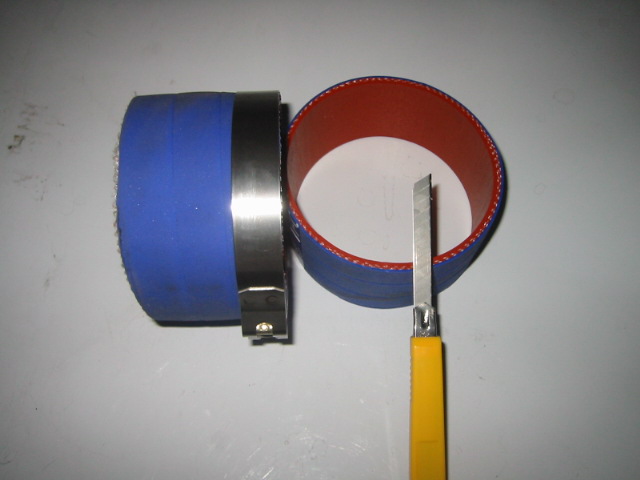

Step 6: Notice the below picture is almost fully slide or cut.  The cut is very clean.  The key is to use a brand new sharp razor blade.

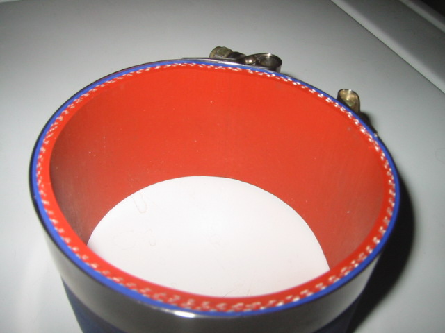

Step 7:  The hose is cut and you can see the two pieces are clean and look professionally cut.

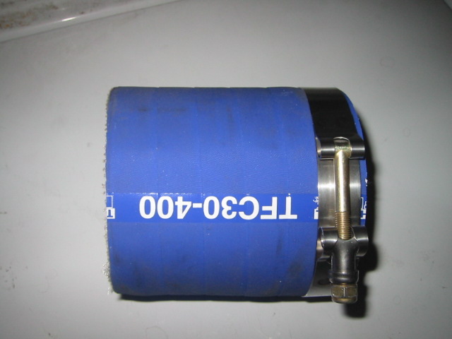

Step 8: This piece is the original with T-Bolt clamp.
Step 9: You can see the clean cut without any curves.  Remember a sharp blade will do the job.
Step 10: This is how it look like during the cut.  Try to extend the blade so you would have room to slide the blade.
Step 11:  Finally all done and save lots of money.  Beside money saving diy, but this process will have the professional look that will cost about 4-5 time as much.
