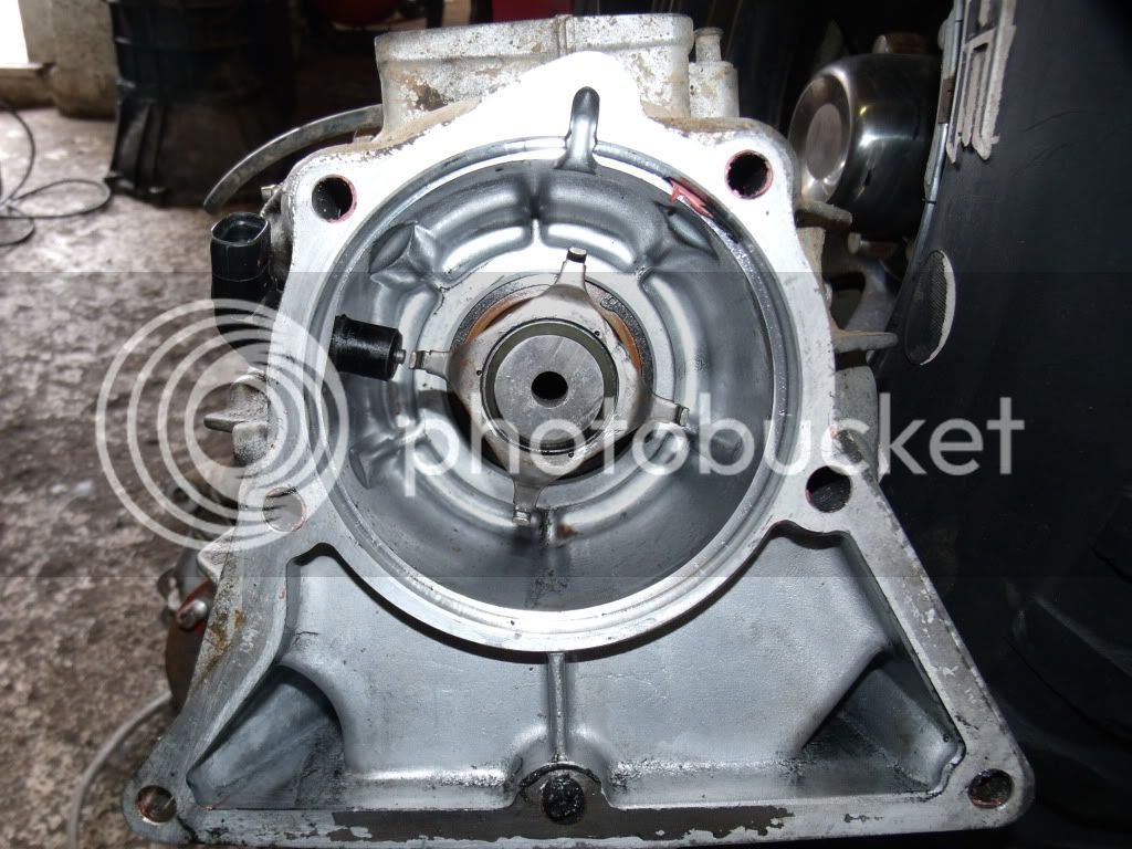

Have my swap almost done motor runs fine but the transmision will not shift out of first gear unless I unplug the solenoids then it will shift 1st, 3rd, 4th.
Motor, transmision, and computer came out of 1990 LS400. the speed odometer doesn't work I have used the sensor out of my 1993 4runner in the 1985 gear drive transfer case with the rear out put speed sensor in the prerunner adapter is the 4runner and lexus speed odemeter sensors wired the same? Any other wires in the 4th plug need to be hooked up for the transmision?
Thanks J Teas
