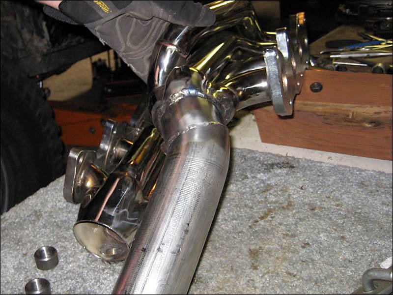

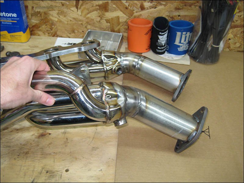

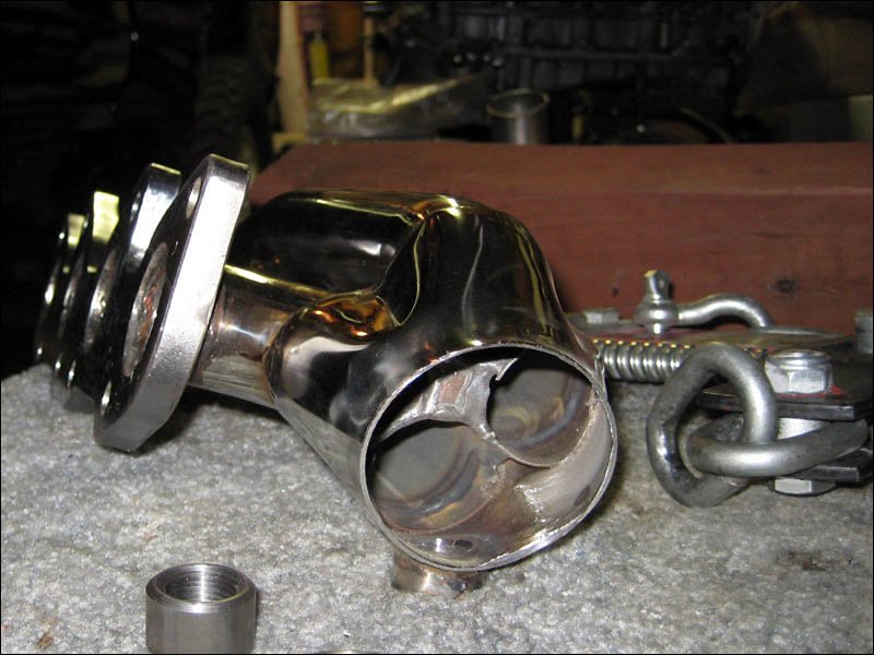

Since I had to angle one of my header pipes around the steering shaft I simply had to change both output tubes to 2.5" and use regular 2.5" flanges. I'm sure my engine will be thanking me for letting it breath better. They look a LOT better now.
Chop Chop:
Weld Weld:

Looks much like how I did mine. I also found the left o2 sensor fouls on the chassis, so I relocated it onto the side of the pipe.
Have you got a pic of your primary mod (to clear shaft)? That bit was done on mine already, badly.
The header pic just above our two posts here show the final mods I have done to my drivers side to clear the steering shaft properly. This is all I had to do on that side. The passenger side was nearly perfect but of course I had to cut after the collector to widen it with a 2.5" instead of 2.25" like I did on the drivers side. I also angled it down a little earlier just to make it proportional to the drivers side.
The o2 bungs are on the bottom which I was under the impression that a little higher than 90 degrees to the side was optimal. I'll be reading up on the documentation of my Innovate Motorsports Wideband o2 system that I'm using. That will give me the final word on where to mount them. As you can see in my pic I have a couple bungs to put in if I need. Then I would just cap off the ones that came in the header already.
