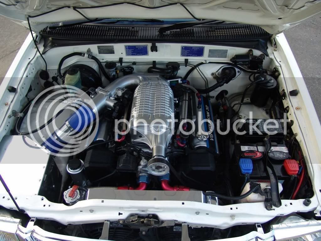

The easier way to boost the SC4 is with a centrifugal supercharger and the fish bracket. You can get it done within 2 days if you know how.
