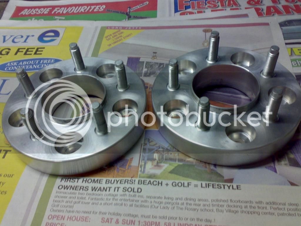

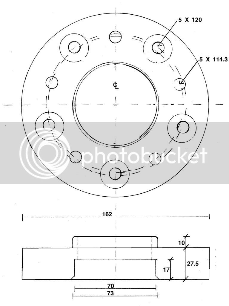

are you running spacers??
I am using hubcentric wheel adapters.
The spindle is a 50mm drop crs item.
Hubs are also crs commodore stud pattern.
As you would know the offset is still wrong to be able to use commodore pattern wheels unless you have some made with a custom off set.
Below is my crude drawing of what I had made.
They are hubcentric to both the hub & the wheel & made from 7000 series alu
And the real thing
