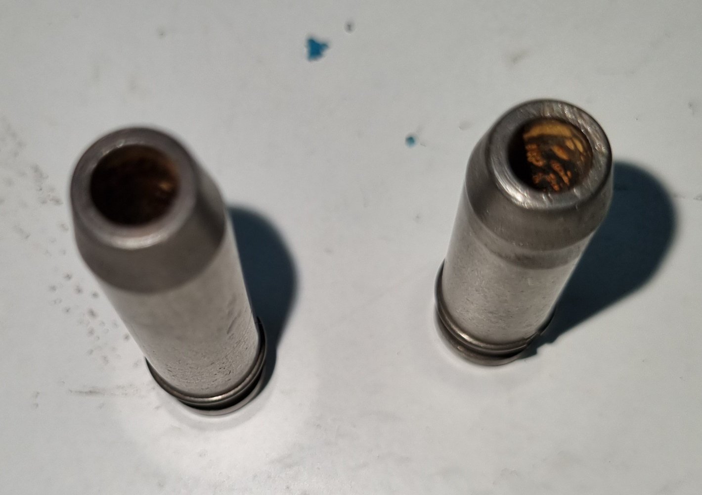

Why does this Happen? 1UZ’s use metal valve guides and as they wear the clearance increases opening a window for corrosion to build up on the inner (Valve stem side) of the valve guide. Coupled with condensation that also tends to build up usually more on the odd bank (left side) of the engine always corrosion to form on metal parts under the cam covers. I have some old guides I pulled from heads sitting amongst bits in my junk draws where it’s evident to see the discoloration from rust inside the guide.
