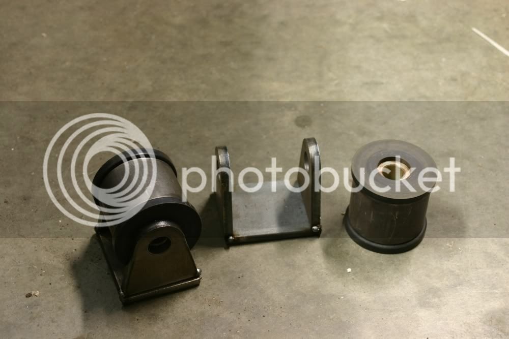

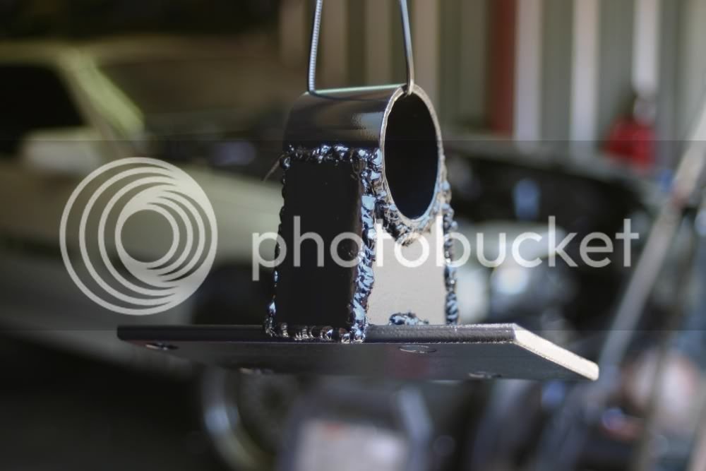

I made some polyurethane ones... I had solids and they were fine, didnt notice much vibration.. but I thought polyurethane would be a little more forgiving.
