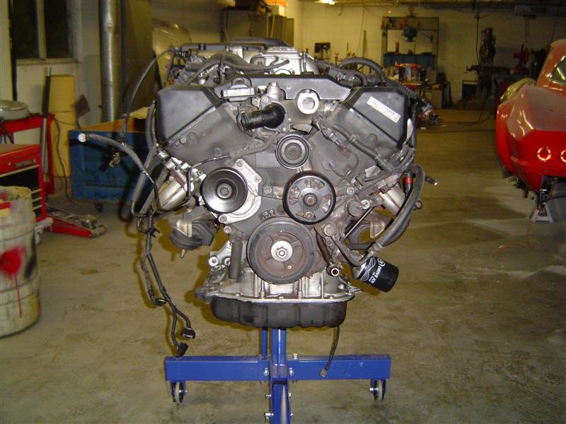

Well as most of us who have done this conversion (mainly on IFS) found that the standard Z418 oil filter is just that little bit too long. So after days of hunting and searching (actually 2 hours on the net) I have found one.
Heres the specs.
Z418
Seam OD 77.00 mm
Seam HT 85.00 mm
Gasket ID 64.00 mm
Gasket OD 72.00 mm
Relief Valve
Anti Drain
Thread 3/4" X 16UNF
Z314
Seam OD 81.00 mm
Seam HT 76.00 mm
Gasket ID 60.30 mm
Gasket OD 70.30 mm
Relief Valve
Anti Drain
Thread 3/4" X 16UNF
This one is about 10mm smaller in height and fits nicely and clears the front sus member and can be fitted without any problems and leaves about 10-15mm clearance. Cant see clearance in the photo - sorry.
It's actually off a Renault of some sort - but I dont care cos it fits and I paid $18 at REPCO - trade & about $28 RRP (Aust dollars)
Hope this helps a few people.
Cheers.
