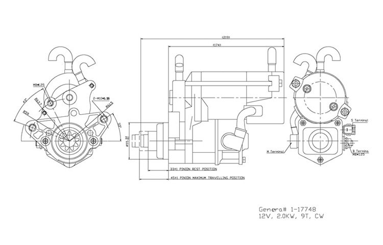

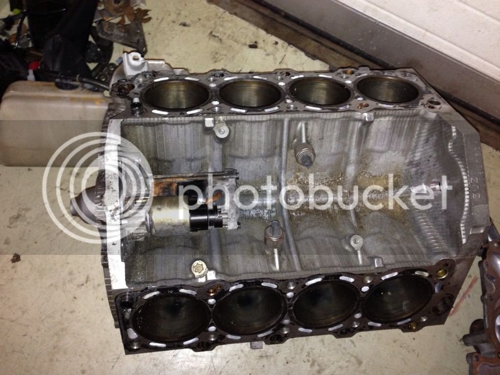

I was also thinking of this to give the blower some room... started looking at outboard motor starters, they seem to be "inline" rather then a solenoid on the side
the other option was a belt starter, perhaps modify the factory alternator (high current 3 phase motor drivers are cheap for RC planes) and then have it switch back to charging once the motor is started... need a spare 1uz to play with i think!!!
