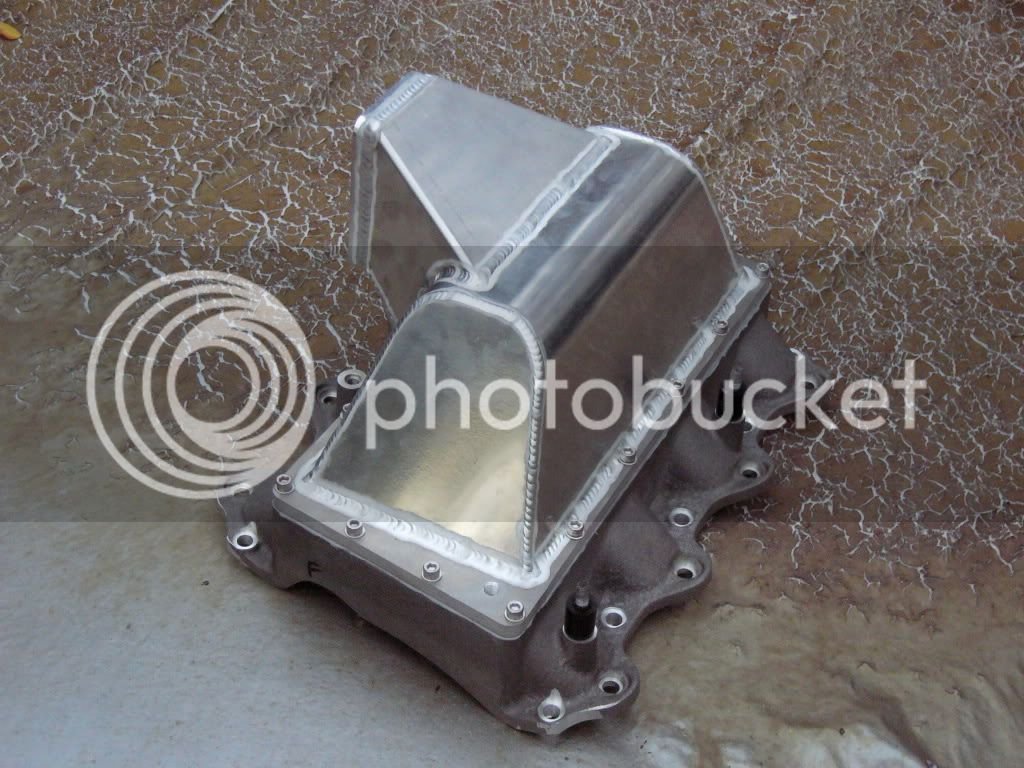

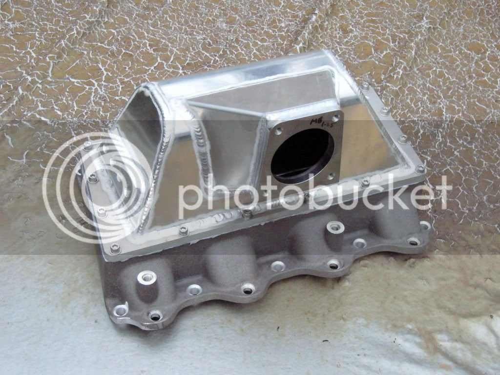

Finally found some time to have a crack at MKII :)
I cheated a bit and have just used an off the shelf SC manifold and had my own plenum fabricated to bolt on. I was pushed for time as trying to get this sorted for the Toyota Nationals at Easter (need to defend my Top Toyota title ;-)) so i thi k there will still be a MKIII to come.
I used a Bullet SC manifold as it's already ported. Not as heavy duty as the Richwood version (which i also have) which could be a good thing as it's lighter.... but a Richjwood one might (?) be better for a high boost SC?

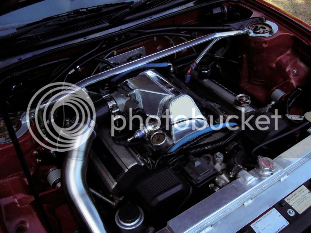

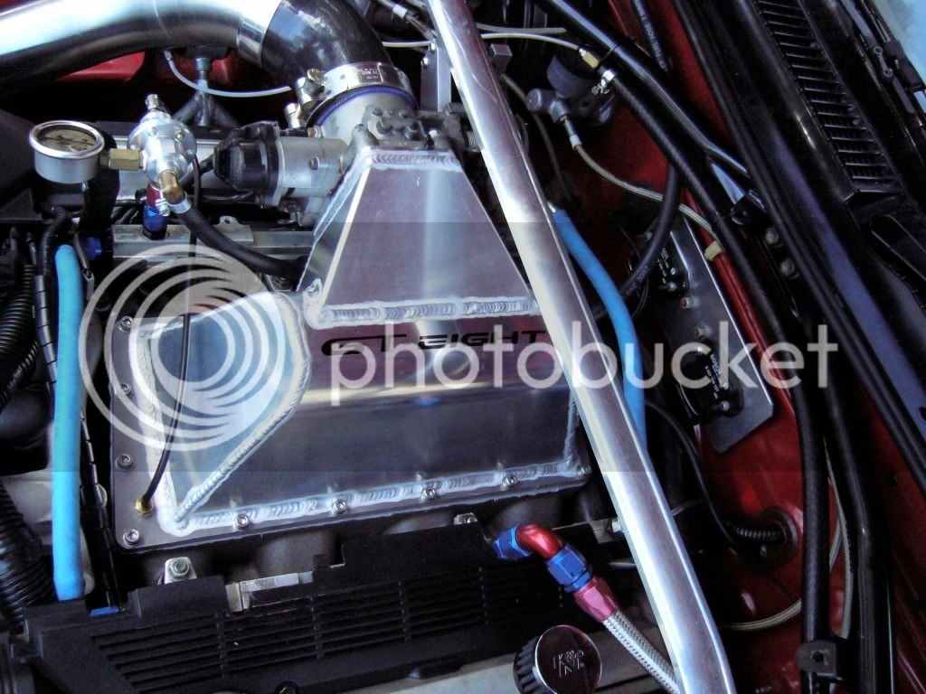

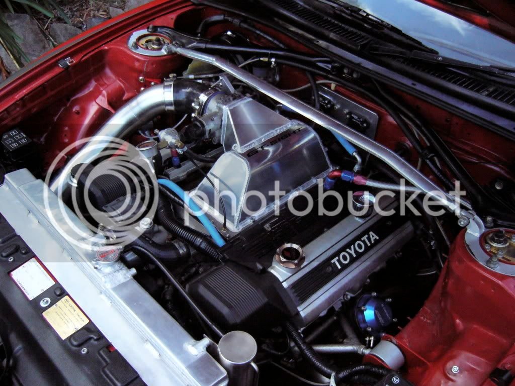

Found a coupla free hours so all installed girls and boys:
Initial driving impressions are promising. Boost comes on earlier and no loss of throttle response from the huge plenum (approx 8 litres). Butt dyno is of no use on the street at these hp levels so a dyno session is needed to tell the top end story...does seem to pull strongly past your normal stock roll over point.

New manifold and new plenum...gone is the long stock runner setup.
This new setup puts the TB in the stock position though so should be pretty much straight bolt on for you Soarer and Celsior guys
Will be very interesting to see the before and after dyno results. i thinkyou should make good numbers up top. There is no runner now, you may loose a bit down low.
Looks great when do you think you will have time to hit the dyno?
