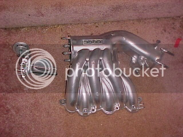

Just the OEM intake manifold with the ports cleaned out abit. Here's the top half of the manifold with the ACIS flap pulled out.
We have it pretty lucky on ours. The manifold is alittle bleh. Split manifold (The pleumn, and throttle body standoff length is split top & bottom. You can see rear bank curves to the bottom, front bank curves to the top) rpm. (It's about 800rpm too late.) The tapered port diameter & 15.5" length to the valve face works out too big & short for the OEM engine. But once you do some cleaning up in the pleumn chamber & it's divider. Then feed it some FI it tends to work out really well. The runners only differ about ant an inch in length between them. Pretty nifty relative to alot of other OEM ones.

Once you're done Polishing - check EASTWOODS catalog for their Chrome Sealer - it's a clear coat & will keep all that hard work as Day #! ;)
Great work on the polish job...Looks tedious to do, but beautiful. Didn't someone polish their early 1UZ intake and post up pics? I can't seem to find that pic. Can anybody post it up?
